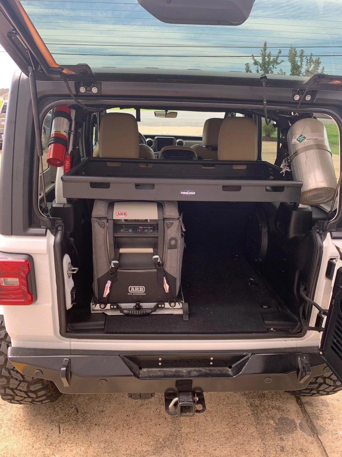

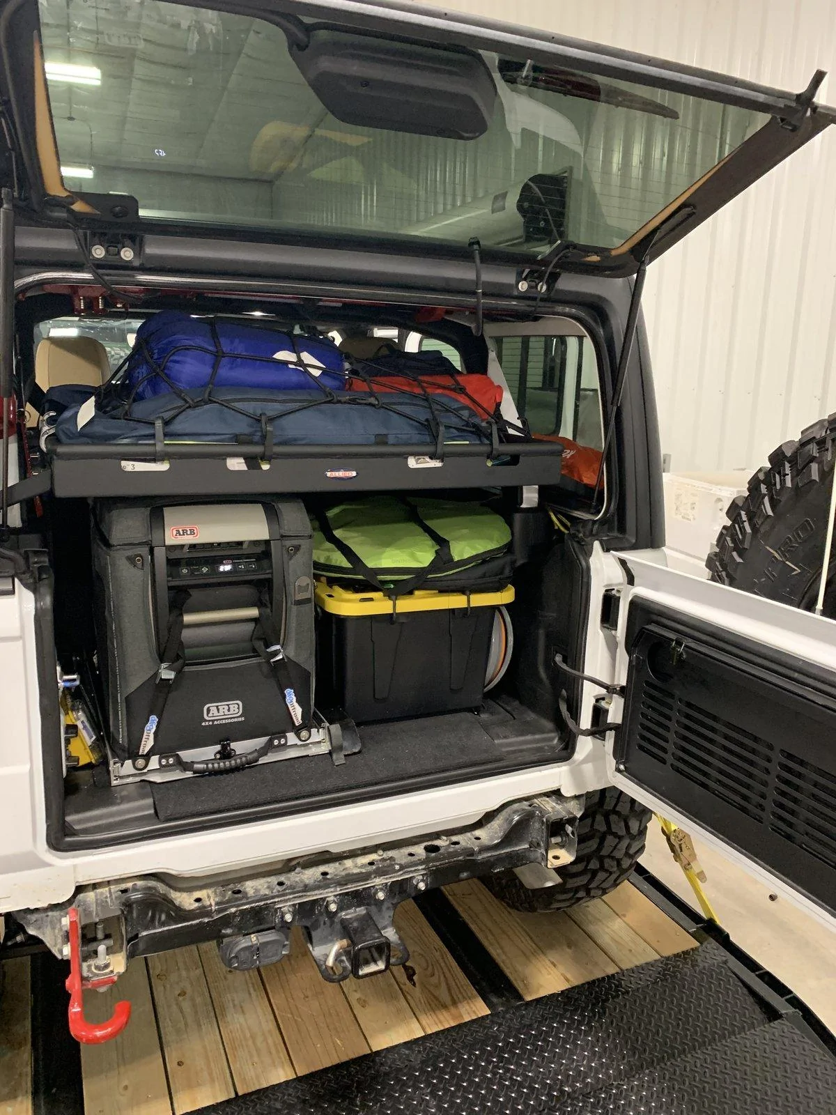

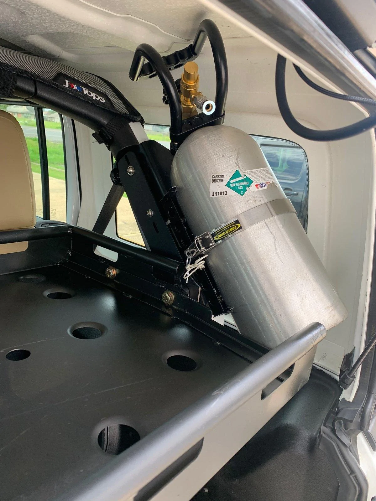

Been a struggle to get everything in the back of the jeep. Just to recap what i'm trying to do
1. ARB 50 with slider
2. Cargo Shelf
3. PowerTank on JL Rollbar mount
I had to modify the cargo shelf but i'm happy with how everything turned out. Thanks to Rustydog for the input on the shelf mounts!

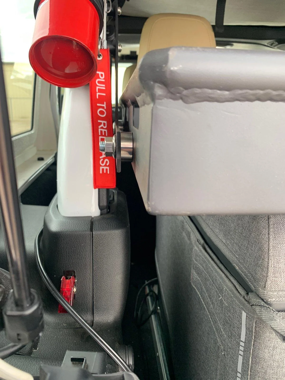

I have the Hooke shelf and ARB 50 and DFG low profile slider. I had to raise the shelf a little but it has worked well. I have wanted to switch to the vector but I’m not sure about not having a lip on the back. I also wonder if it will fit with my CoolTechLLC fire extinguisher mount.
How did you mount the DFG low profile slider? How much did it add to the height of the cooler?

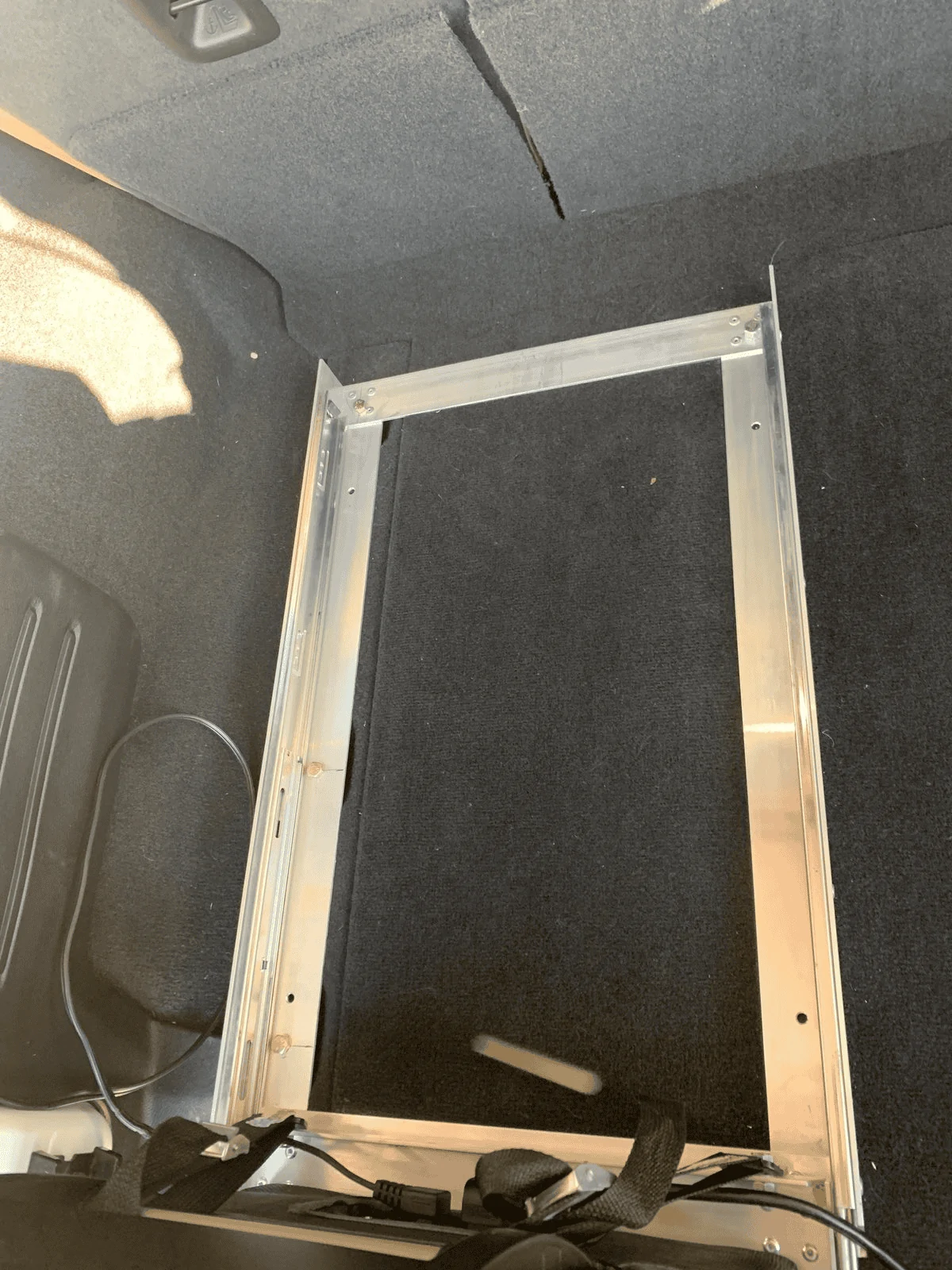

Here is how it is mounted. I used the three (3) tiedown bolts on the driver side and drilled a hole in the tub for a 4th bolt. It's been solid and no issues after a year. It added about 1.5" ish best i can remember. It was about an inch less than the ARB slider.
Thanks, that looks like it might be the way to go. My goal is to be able to fit underneath a security cover. I was considering EZ Trunk, but I don't think I can go another summer with a security deck. Also looking at the Squad Box.

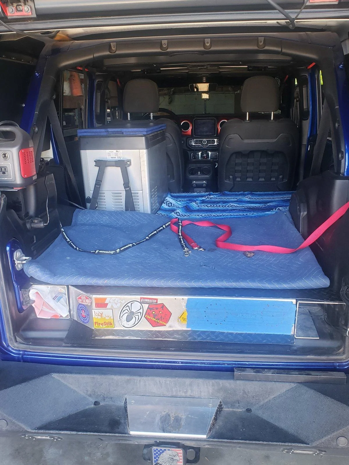

Can anyone confirm if the ARB slider will work on the driver side with the seats up?
Sprint7
May 31, 2018
144
160
Louisiana
2004 LJ 2018 JL
My have the ARB on the driver side with a DFG slider. I had to modify the slider but it fits.

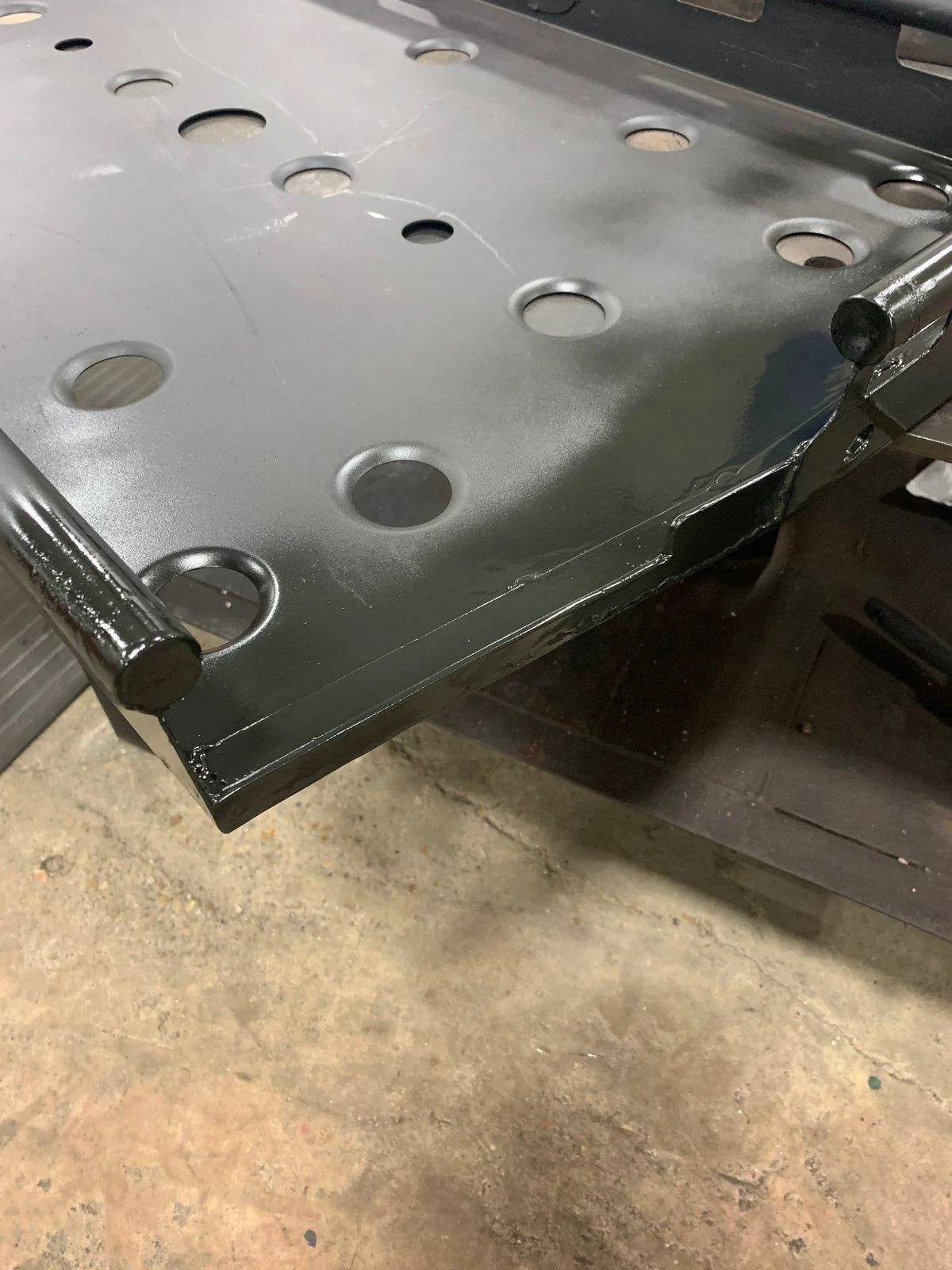

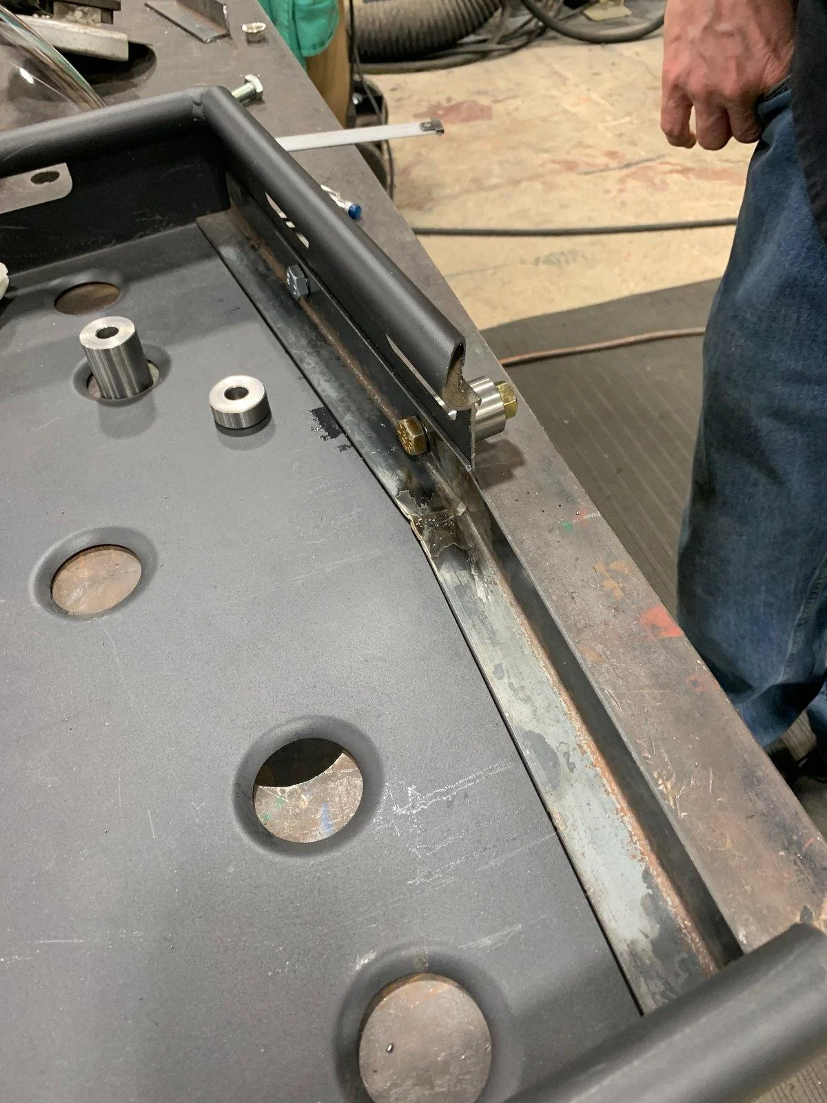

Drago has their custom solution for the JL which lines up with the existing holes and requires very little modification to install.
They use super heavy duty slide rails that don't rattle and lock both IN and OUT (not all slides do this). The thing is rock solid and worth every penny. I have used mine through Death Valley, Mojave Road (Trophy Truck style), Big Bear, etc. No rattling or shaking or noise.
It also is adjustable so you can maximize the fit in your Jeep. It positions the fridge leaving more room than most other slide solutions. If you STILL cannot get it or you need a weird size custom fridge slide vs their universal, they do custom work also.
They have an upgrade that includes a custom slide-out cutting board insert which is just beyond cool also.
