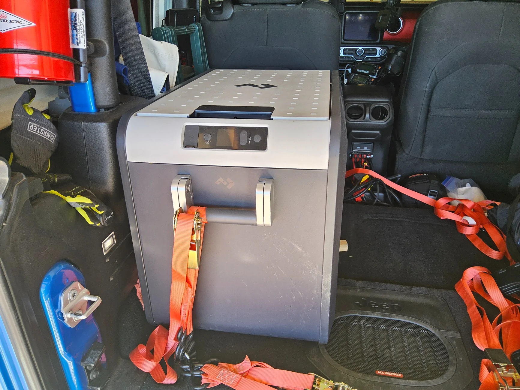

I am using a Dometic CFX345 in my 23 Wrangler Rubi 2 Dr. and I elected not to use a slide out tray Mount because it would have taken of valuable floor space for my Trail Recovery Gear that I take on all of my runs.

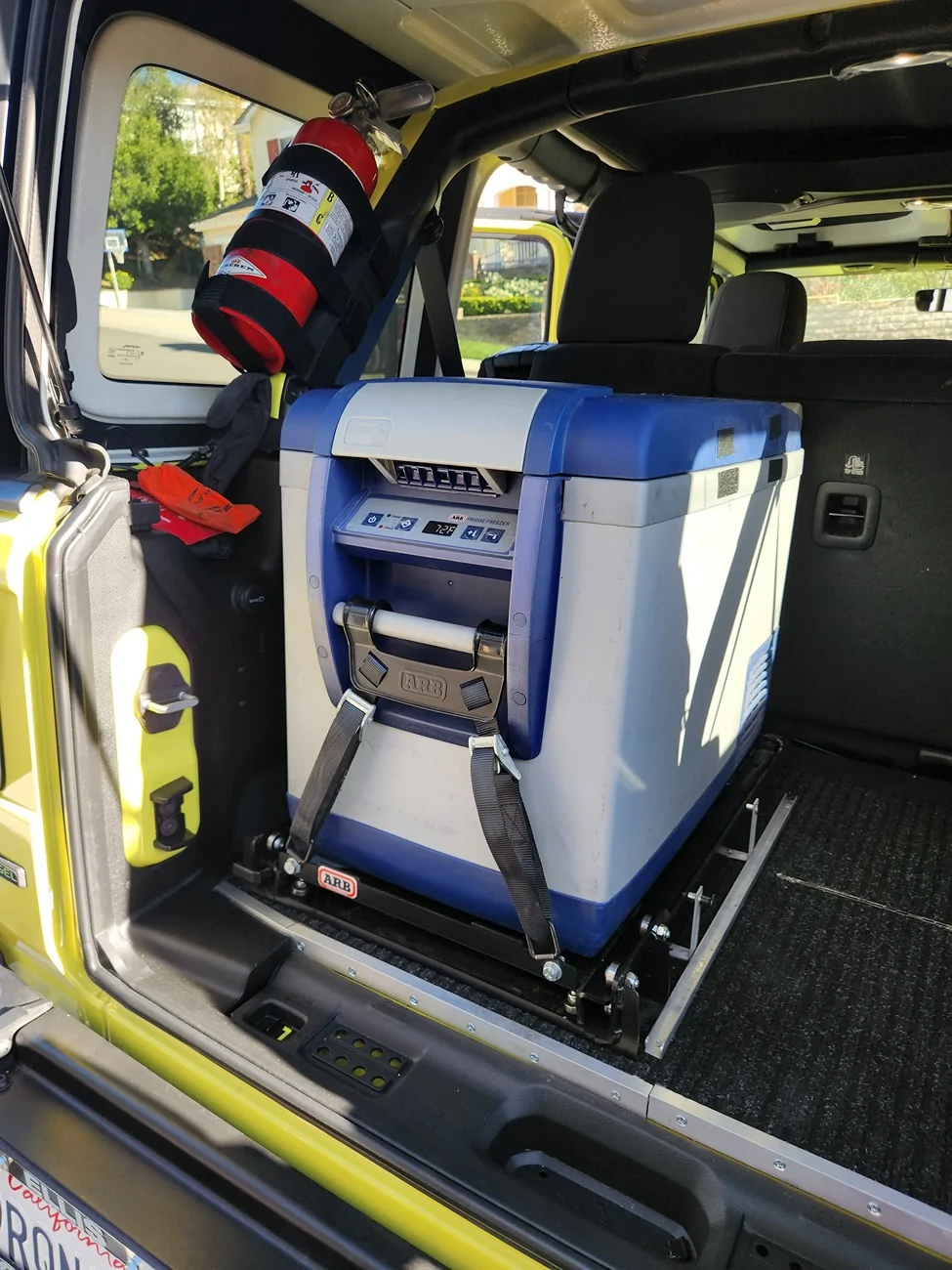

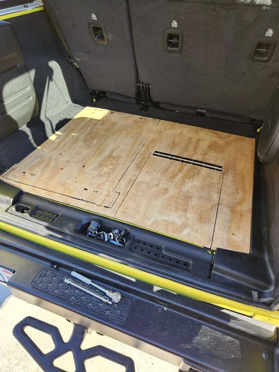

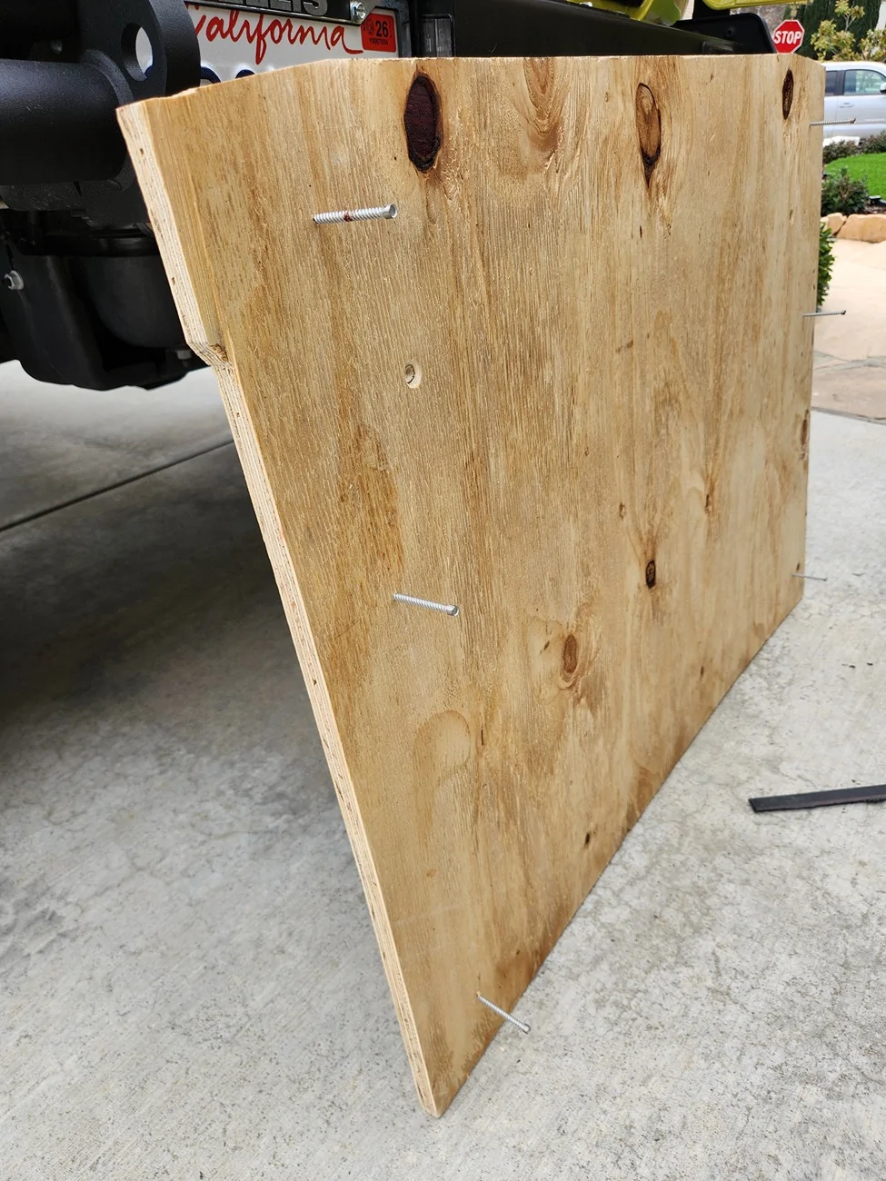

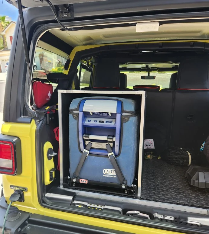

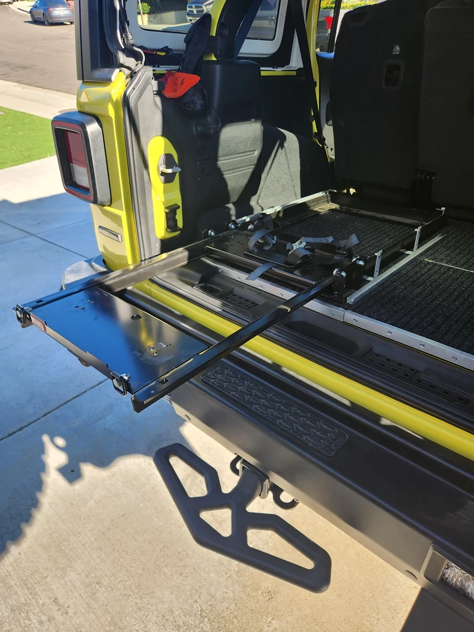

I installed the 50L ARB fridge/Freezer from the JK to my 2023 JL. I removed the original carpet/base. With the anchor bolts removed I used screws with points in the holes to transfer the locations onto the 3/4" plywood base. I placed the ARB tray on the plywood to locate the hatch opening cut. A 12 inch ribbon hinge worked perfect. Because 3/4" plywood is under sized I trimmed it with 3/4" aluminum. Indoor/outdoor carpet covered the plywood. I built a box to cover the tray when the fridge is removed. I also built a box around the fridge so camping items did not fall behind it when pulled out. Cutouts in the back of the box provided air space for the compressor. I installed an A/C power receptacle to power the fridge when power is available.
