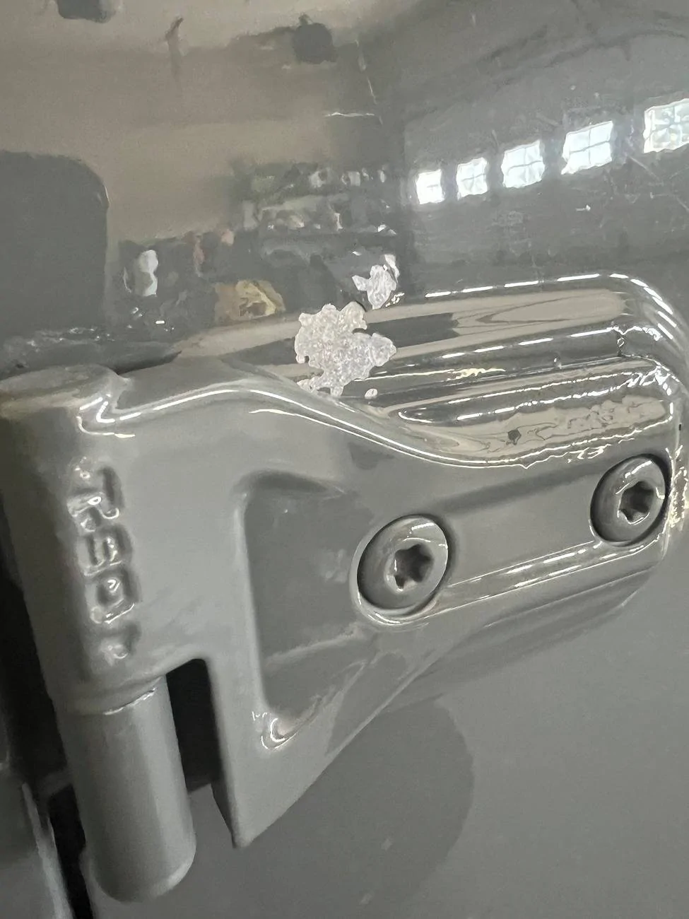

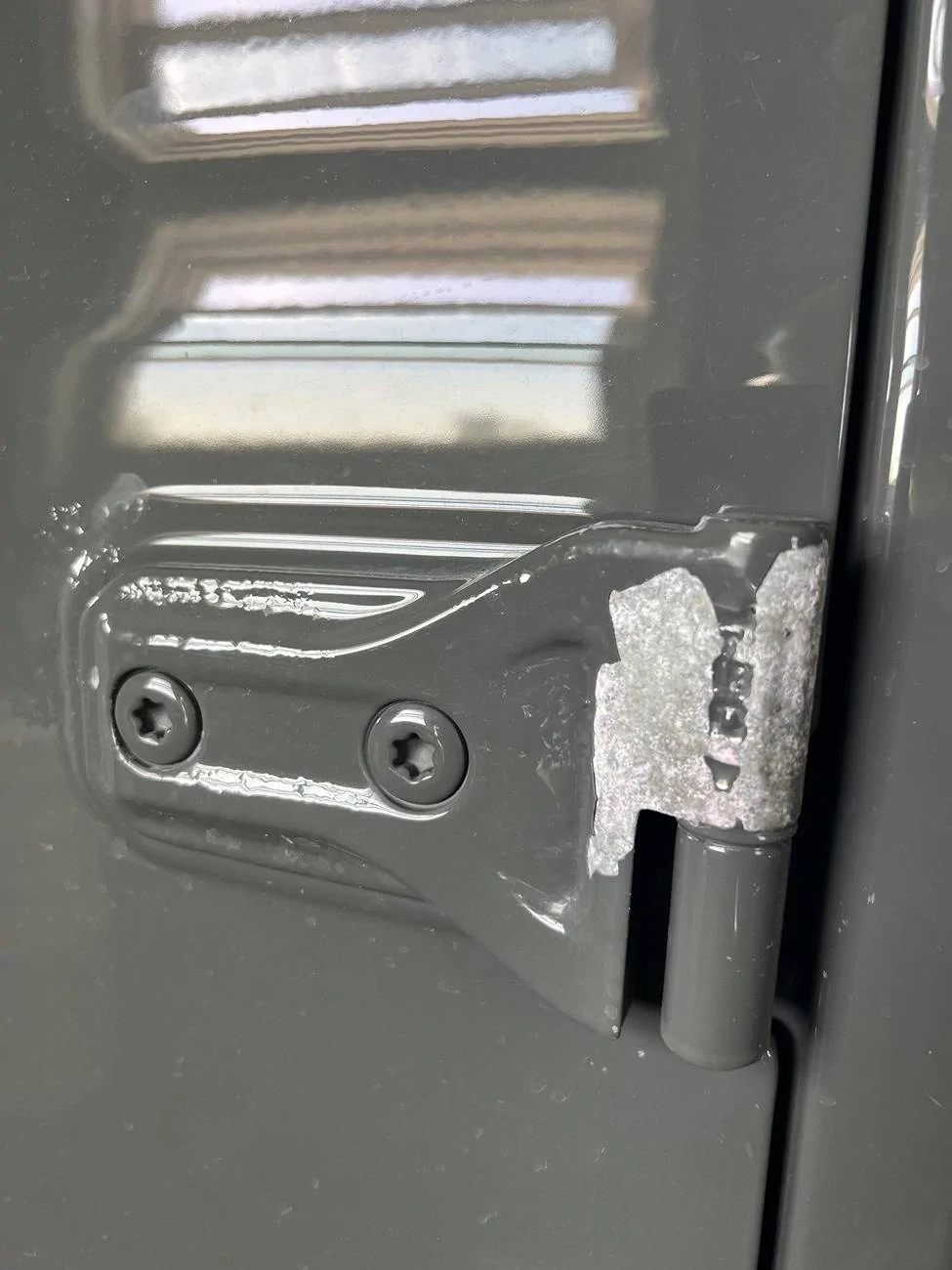

I've been dealing with this BS for 12 months now and have yet to speak with anyone who can or wants to assist me at Jeep. I filed my claim under warranty in Oct 2023 but at the time parts were unavailable. 5 yr warranty expired in Feb 2024 and of course now that parts are available they are giving me the runaround since I am out of warranty. The dealership backs me up on all of the claim details as well and it is all documented which just agitates me more.
Every door of mine is like this.
