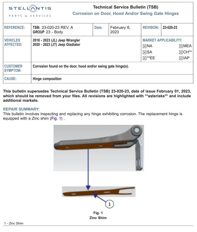

The bolts used to mount them are steal, not aluminum like the doors themselves. So right there is two dissimilar metals in contact. Just going off boat math here, but using a anode (the shims) to eat the corrosion makes sense.
As you said, it's a prep issue which is the primary cause of the corrosion. Since the hinges are painted over it's very possible small bits from the threading, either on the bolt itself of the thread from the doors, is the original cause of the corrosion. Hell, it could be the drill that drilled the threads into the door living bits behind. It's possible the shims can counteract the corrosion process once it has begun, and allow them to eat most of the corrosion rather than the metal under the paint. The corrosion we see after all is just gas pockets forming under the paint from the chemical process. I'm not a material scientist so just spit balling here, but it makes sense to me
There are pics from a few different owners who preemptively removed their hinges to paint underneath that show the corrosion starting away from the center of the hinges where the bolts are. The bolts are not the issue. Raw aluminum under the hinges is.

If the dealer you busted is the same where you purchased the car then go back and insist very loudly that you would like them to file a complaint with Chrysler , which approves the repairs. The problem is galvanic corrosion, reportedly caused by using zinc hinge pads on aluminum doors (there is a chemical reaction between the two metals.) the problem impacts Jeep Wranglers manufactured between 2018-2020 (I have a 2020 with paint bubbling on nearly every point on the car. I am on a very long list for repairs under warranty.).
Chrysler extended the normal 3 year warranty to five years, which means your time ran out in 2023. However, it is a manufacturing defect and several lawsuits have been filed. Your best bet is to file a complaint with the local AG and consider talking to a lawyer. Chrysler points to the problem in a service bulletin, although seems to be keeping the widespread issue quiet.
You're thinking it only impacts 2018-2020??? The TSB from 2023 covers through 2023:

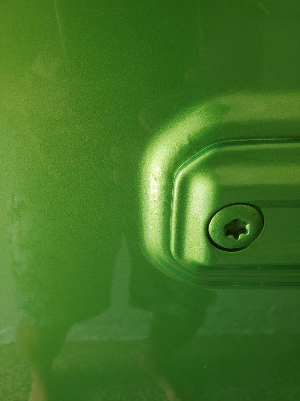

I noticed corrosion on 1 door hinge on my 2019 yesterday. I'm 93 days out of the 5yr corrosion warranty, and 78 of those days the Jeep was at the dealer getting the engine replaced.
