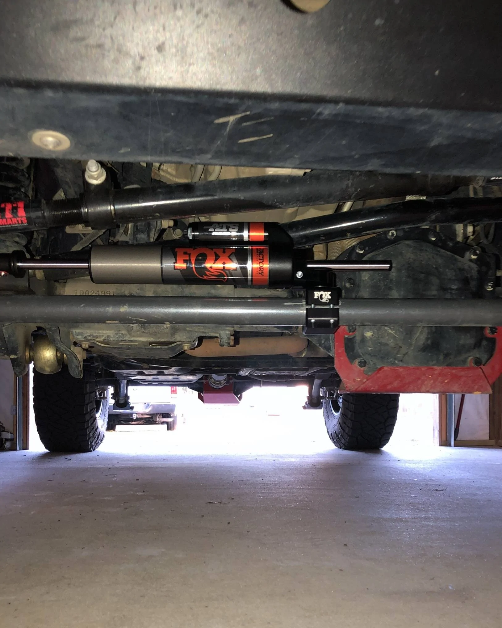

Buying the JK version is what everyone does when they want to relocate the stabilizer out of harms way……. There are several relocation brackets , synergy, MC, Clayton, steersmarts, etc…..,, here’s pic with synergy relocation kit…….

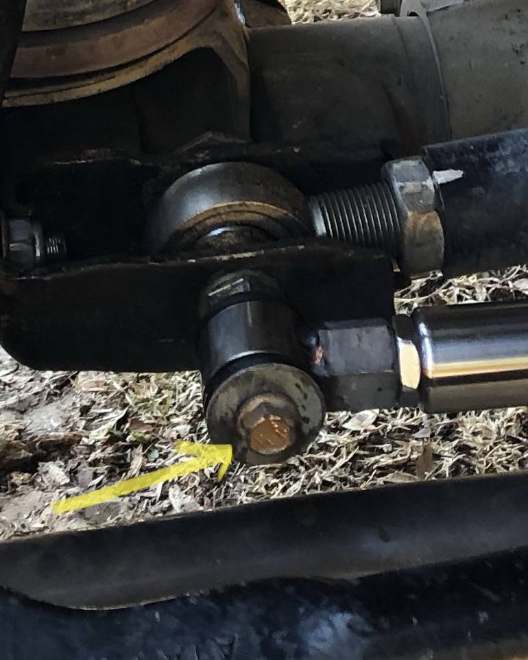

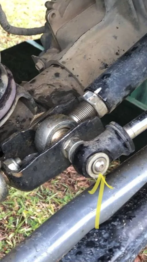

if you use the synergy kit, I recommend to switch the button head bolt out for a hex grade 8. The button head is stainless and the Allen head is easily stripped when removing it…..

I have what is pictured above on the top picture but with the JK version of the ATS (black and silver). Also make sure if you go to a nut or a hex bolt that you have clearance when you turn lock to lock. I did not have the room so ran with what is pictured up top.

Yeah, good point, it was close on mine but cleared…..
