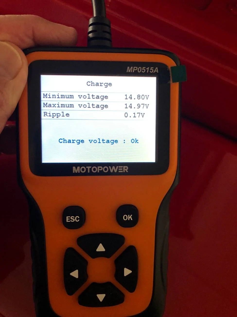

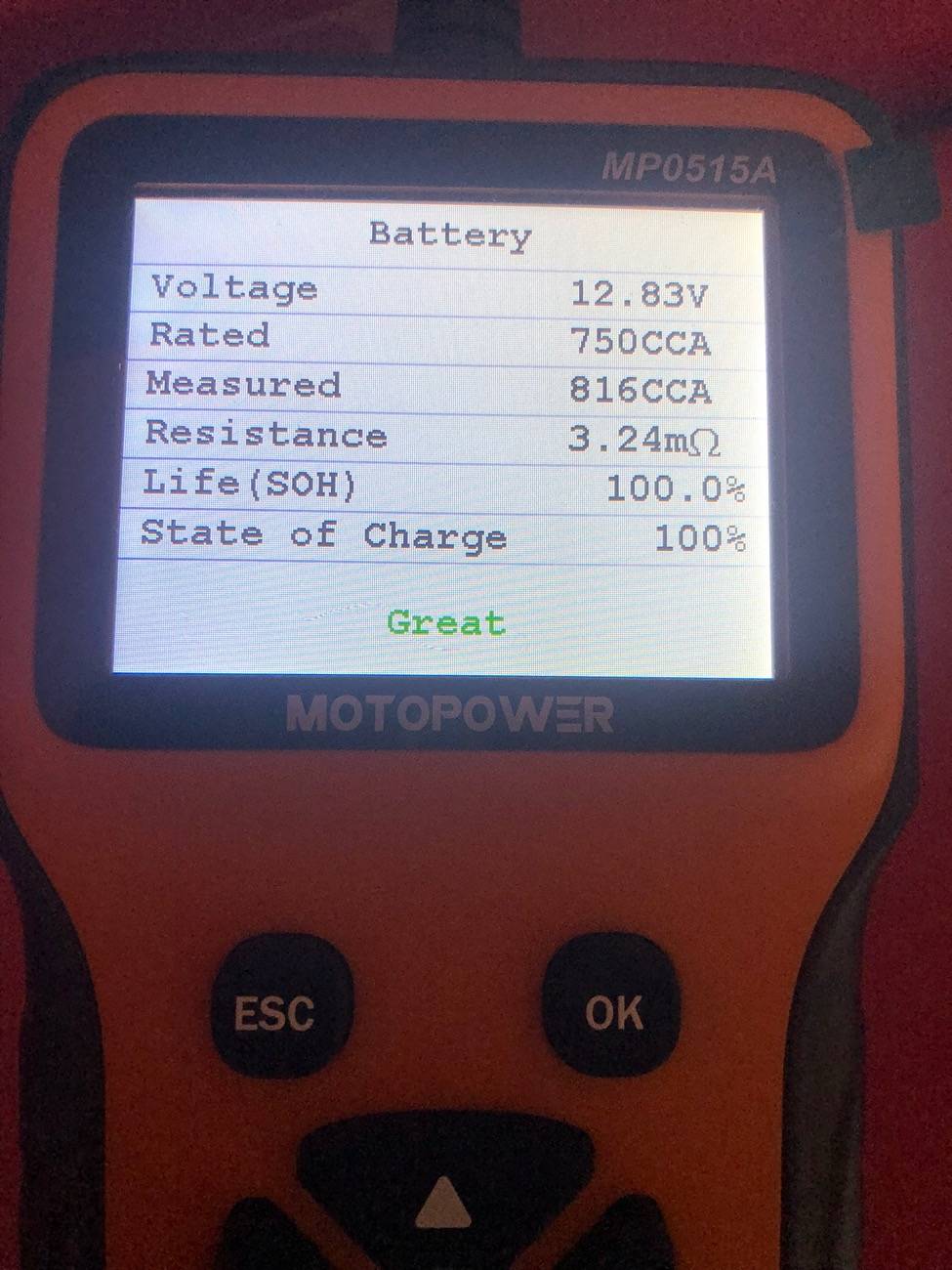

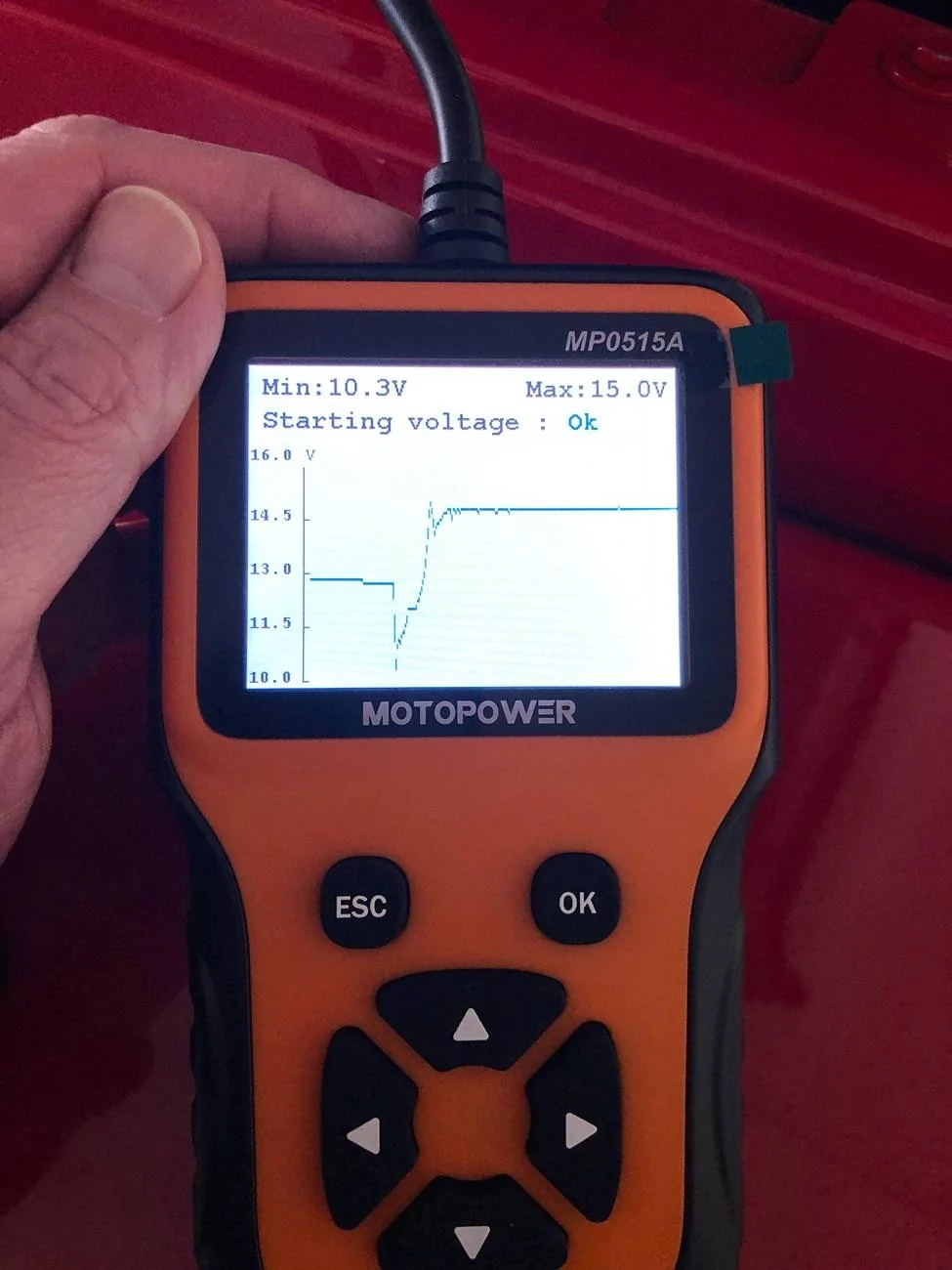

I just went thru this several weeks ago, for me all worked except remote start then I started getting fob not detected so replaced fob batteries and didn't fix the issue so had both batteries tested and both were bad so I have to replace both the main and aux battery on my Genesis system.
WranglerMan
Will
May 8, 2018
104
3,560
2,885
Greenfield Indiana
2018 Wrangler JLU Sahara
Seems these newer vehicles rely heavily on good batteries, they do more than just start your vehicle, also the RFID chips rely on good voltage in a new battery from what was explained to me by another member here.
Besides replacing my FOB batteries which I will now due anually since they are cheap I also picked up this tester for may new Full River batteries that I just replaced, it has a host host of testing ability so I can now monitor the health of them so I'm not left stranded somewhere.
https://a.co/d/2Wcl3rw
