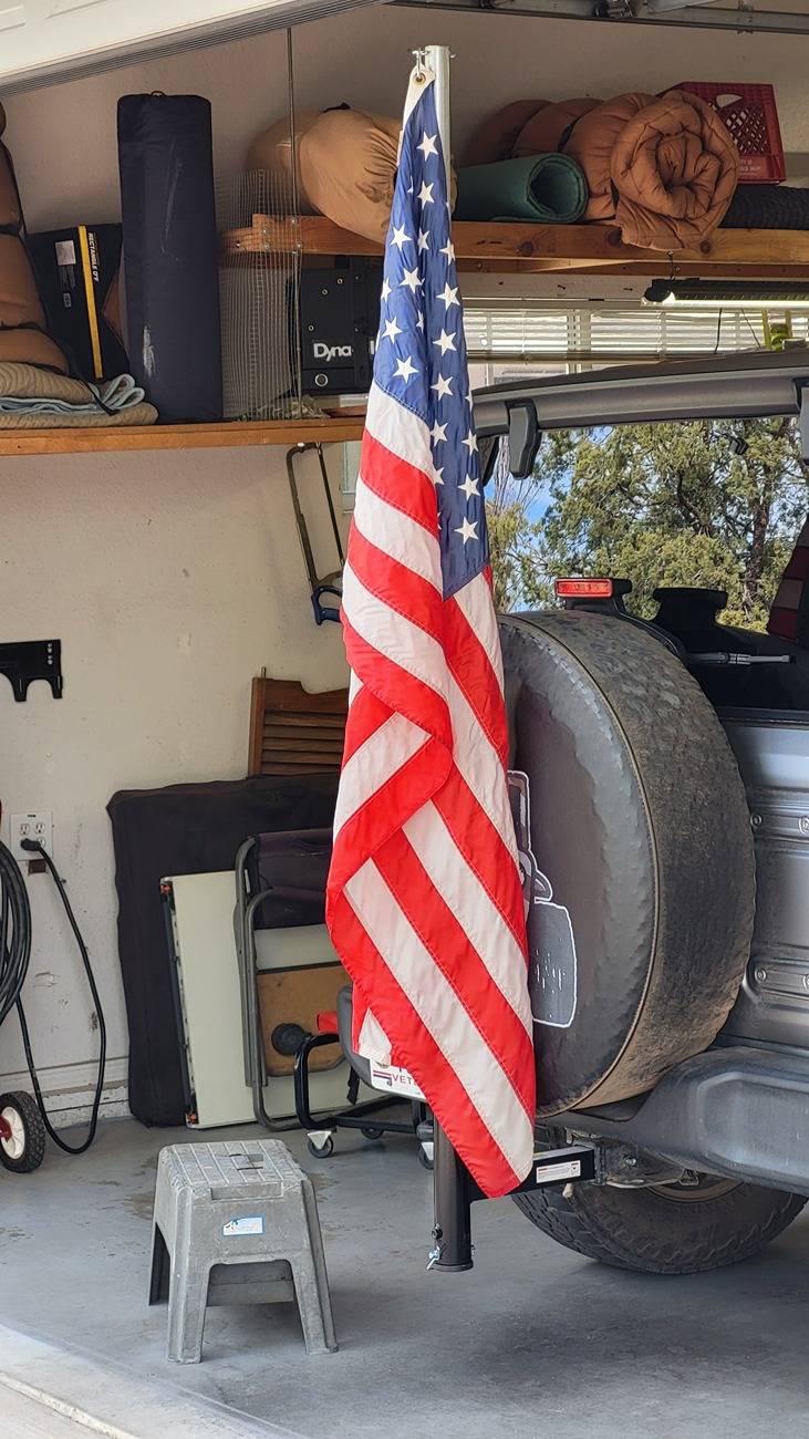

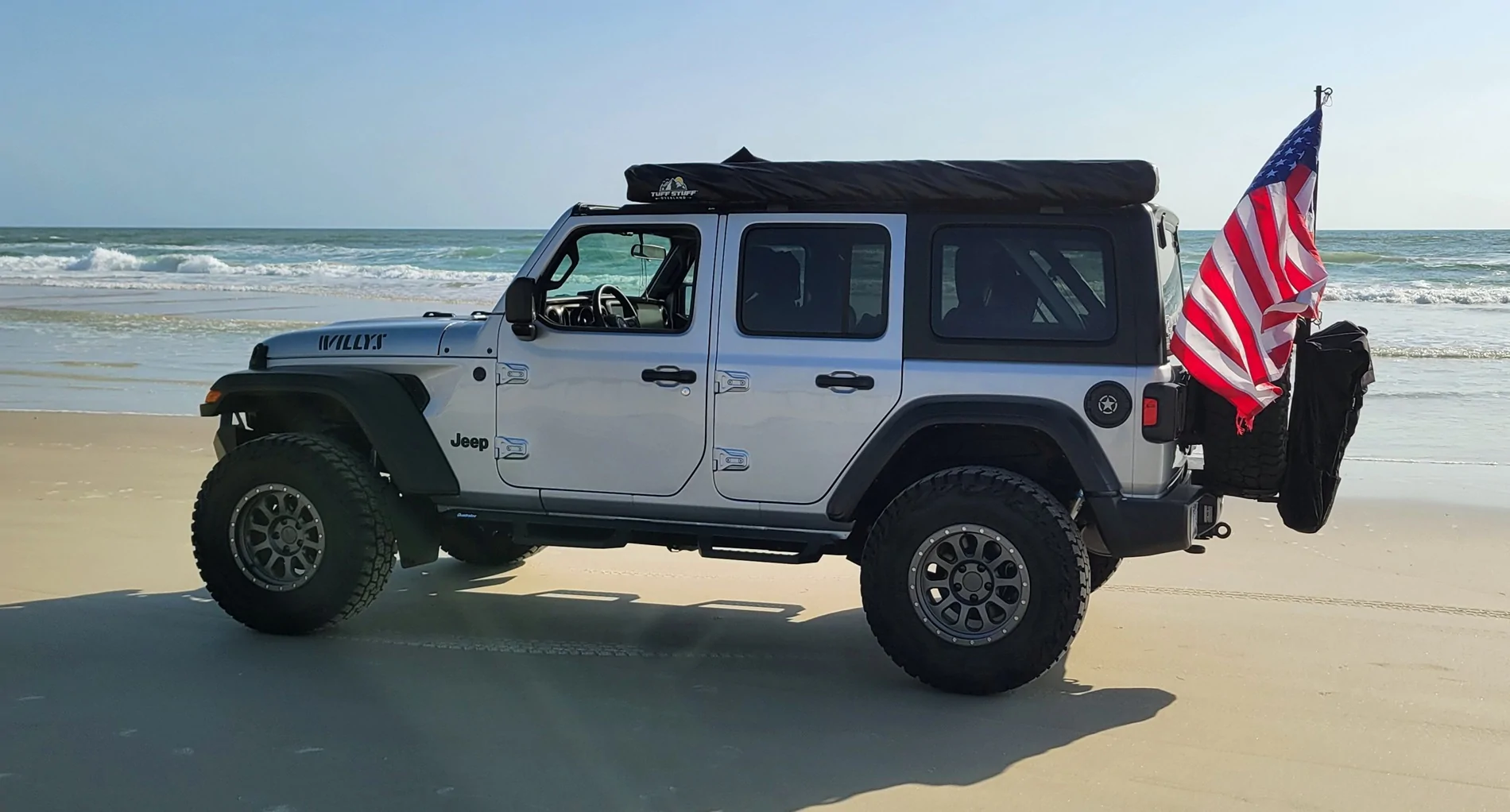

I used one on the tailgate which usually/typically goes on a side window. I tried bending the post with no success, so it was considerably more upright than I wanted it to be.

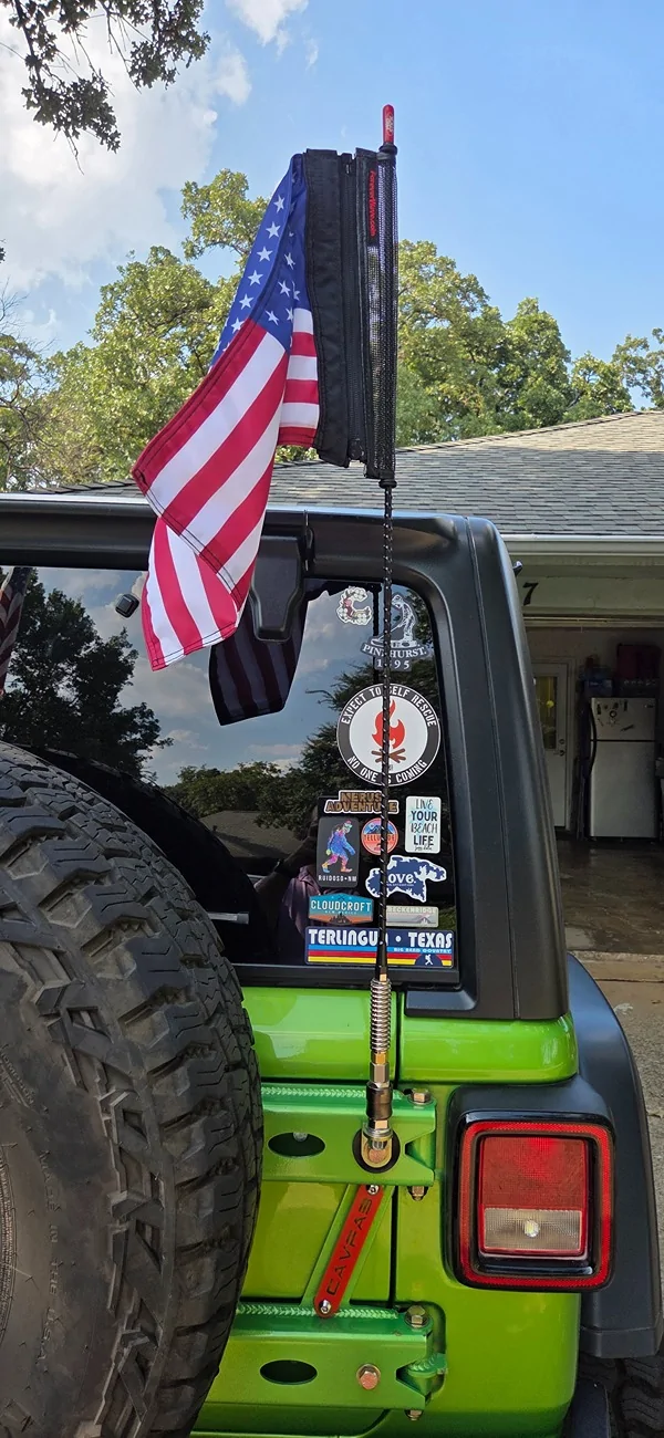

Finally got all the pieces together to add a trail flag today in preparation for Moab in a little over three weeks.
I found a heavy duty L bracket at Seatbeltplanet.com that I mounted to the CavFab tire carrier top accessory bolt. I backed the bracket with a neoprene fender washer to protect the powder coat on the carrier.
I am using a mounting stud and quick disconnect from HandyFlag.com. The quick disconnect has 1/2-20 female threads for the "flag pole", and the antenna/spring assembly I am using as the "flag pole" has 3/8-24 threads, so I needed to find the correct adapter.
The American flag and CB antenna flag sleeve came from ForeverWave.com. I also grabbed a Smiley Face flag just for giggles. It may be fun to fly when I'm in really slow traffic.
It's not the cheapest flag set-up I could get, but it is the exact setup I wanted.
