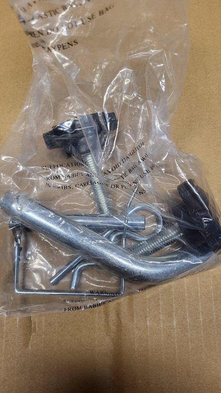

Were on the same track. Just bought this one. It has plenty of room to clear the spare. A bonus umbrella mount!
https://www.amazon.com/MaxxHaul-50240-Flagpole-Anti-Wobble-Receiver
Now I just need Chivas Scotch bag for the parts.

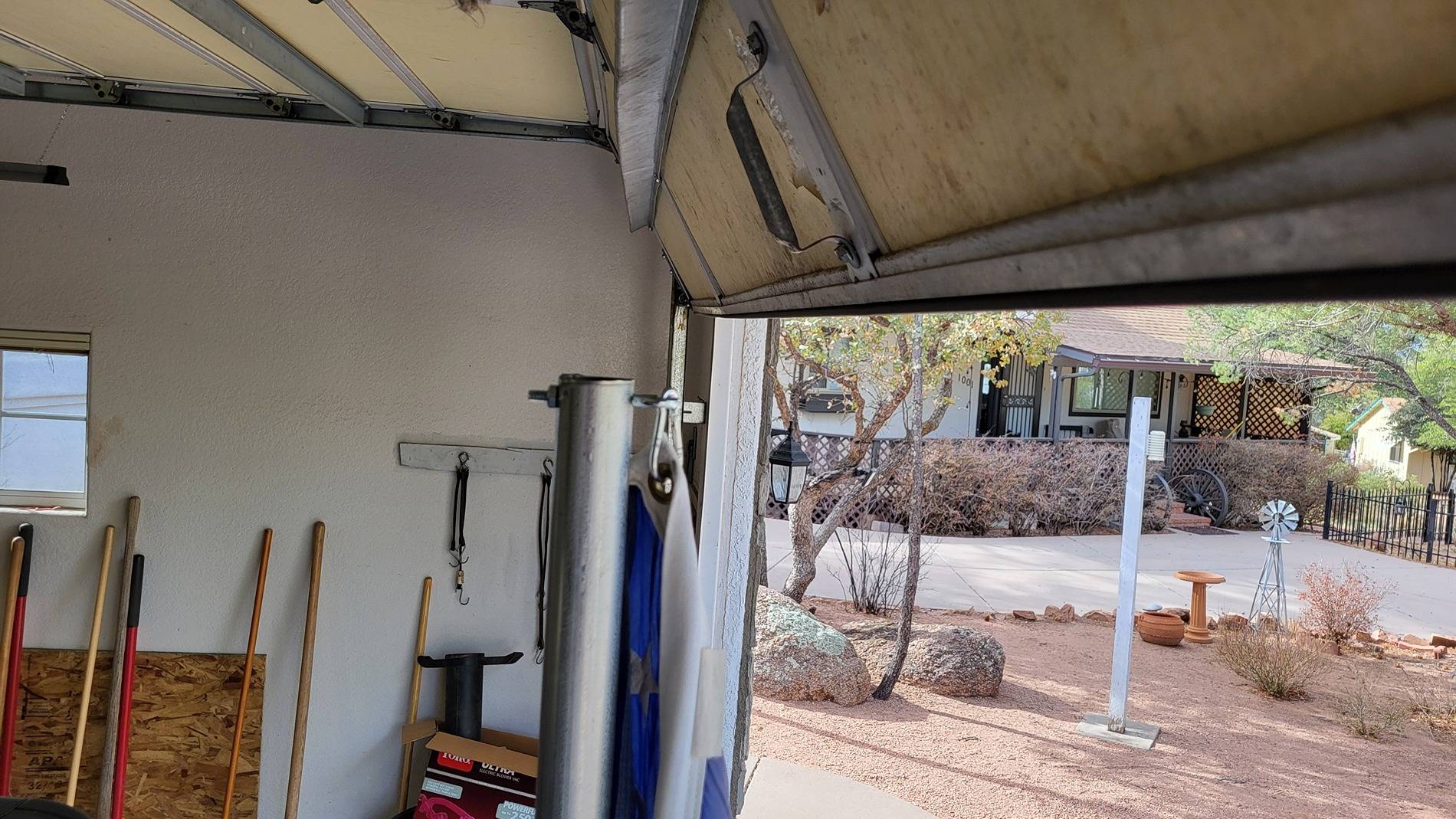

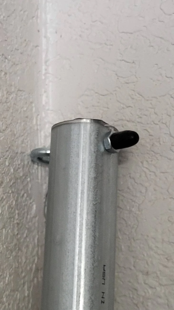

" planning to use it on special occasions like convoys, parades, etc." Update. I used metal 1 1/4" EMT for a Flag pole. It's OD is real close to 1 1/2", same as Market Umbrella. The rest of my cutoff will go to umbrella duty and with an EMT 1 1/4 coupler mate to that pole. Flag pole length dictated by garage door clearance in case I forget. Used vacuum seal caps on eyebolt threads to keep the sharp edges from tearing the Flag. EMT $30, coupler $4 - 5. Got a small organiser from Ace for the misc hardware.
