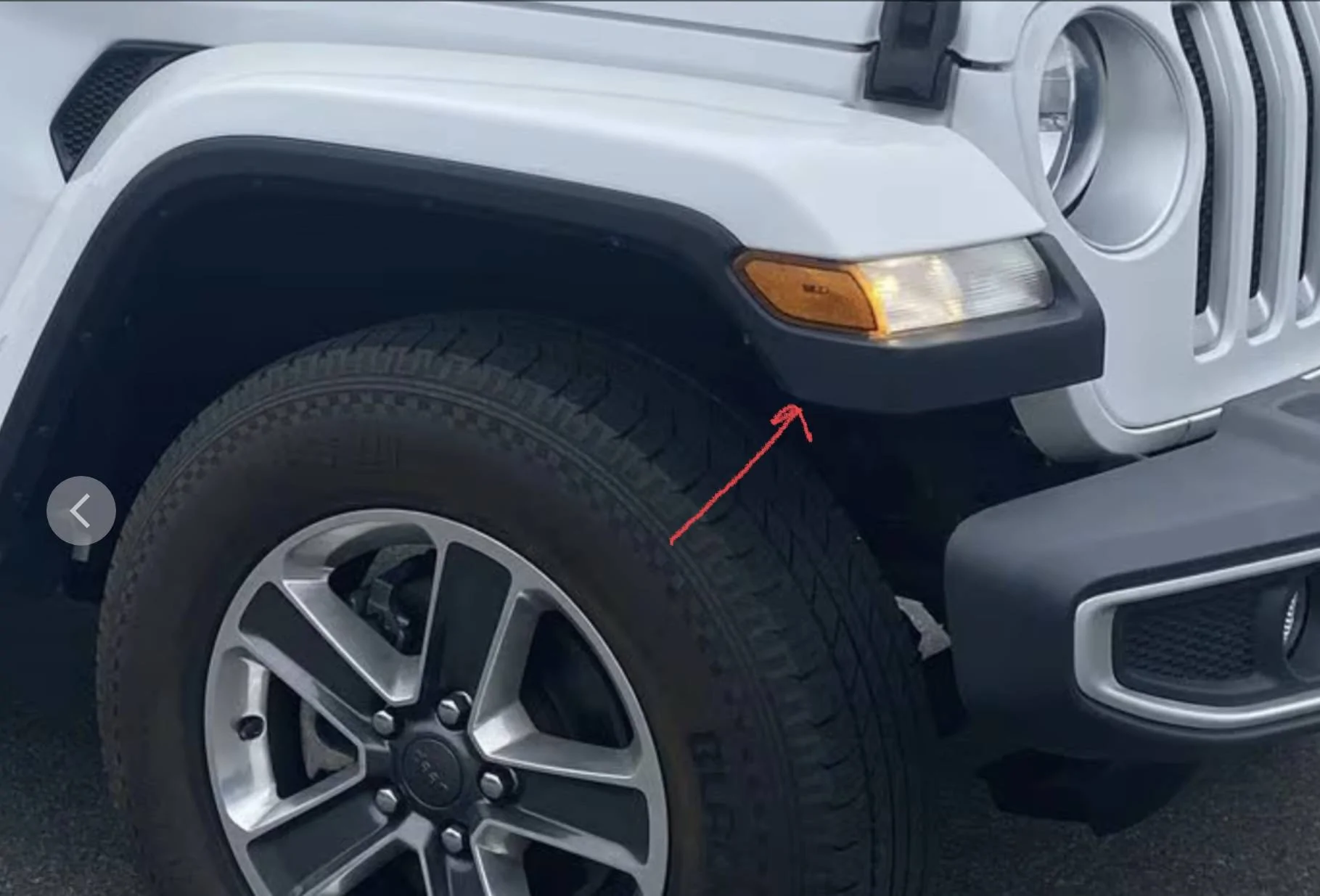

I've suffered a pretty large tear in the plastic skirt/flare/deelybobber that surrounds the blinker/DRL lights on my 2020 JLUS (see photo - not my Jeep, just indicating what part I'm talking about). Researching the part indicates that is not available as a separate part, and the entire fender has to be replaced. Even if the fender were free, the cost to paint to match would make this a non-starter.
I'm OCD enough that I can't leave it this way, and anything other than replacing the part is going to look like @$$, so
a) Has anyone pulled the fender part and can confirm that I can find a part (maybe at a junkyard) where it can be simply replaced?
b) Short of a) above, any ideas as to how this can be repaired and not look like @$$? thanks in advance . . .

Whole fender is going to have to be replaced. On the 2 piece fenders they are plastic welded together and on the one piece they just dont come apart without a knife. Can always go the fender chop w/ aftermarket turnsignals if you dont want to get a new fender and have it painted.

I'd venture a guess they have to be separate pieces. Maybe try and source a cheap donor fender from a junk yard and explore a tear down. Worse case I'd bet even if it meant cutting away from the finished part of the fender you could just glue everything on and be good.

Thanks. Will check with with local salvage places . . . .

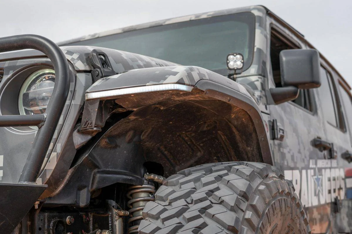

Perfect excuse for a front fender chop as per @yokramer
Jeep Wrangler JL Fender skirt? Flare? Deelybobber? BFE98A83-C5BA-4605-AAEA-E0C57F083C19
AAL ☝, others like Quake, RC
Heck- I almost wish mine would tear, to give me the excuse.
Love my Quakes and they have been awesome to work with and cool people when Ive met them at events.
