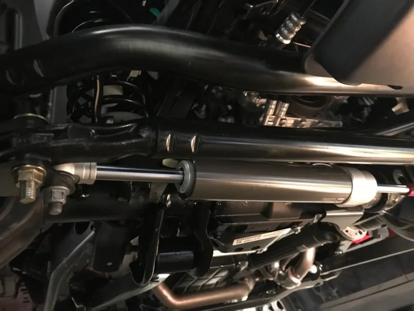

I just installed my Nexus 2.2. It is awesome! Long windy highways, clicked it to firm and it holds perfect. Off-roading, click to soft and it is amazing!

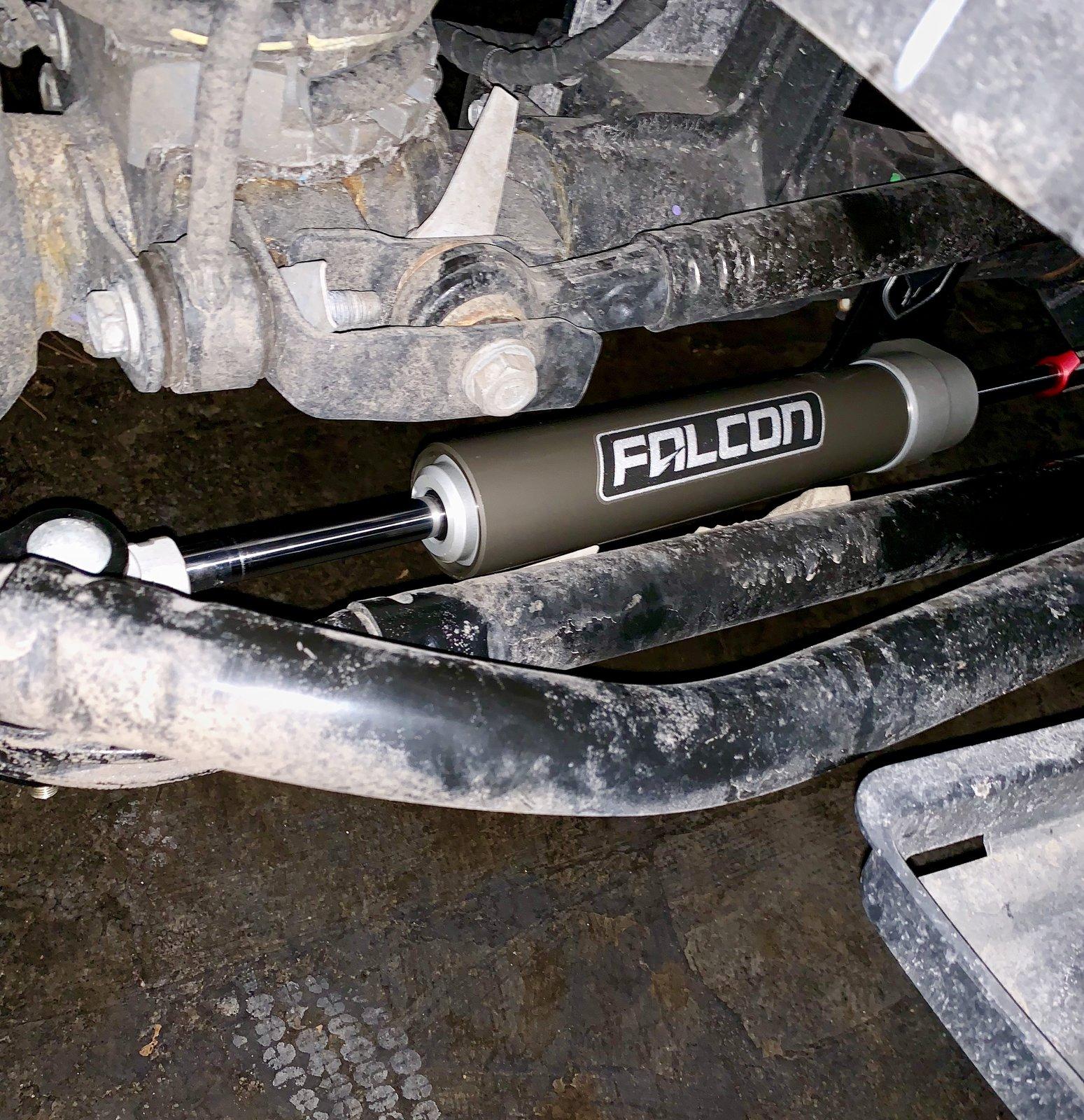

I tried to bend my stock dampner into a banana on the rubicon trail. I picked one up from River City Offroad for a great price, and have been more than happy. The one drawback, is that it sits in nearly the exact position as stock, so it's only a matter of time before I noodle this one too.
Looking into some steering upgrades, and will try and remove it from the bracketry. Hopefully, I can get it top-mounted over the tie rod. It would be a damn shame to ruin such a nice unit.
Running on firm onroad, and soft offroad, on 37's and a RC 2.5 lift.

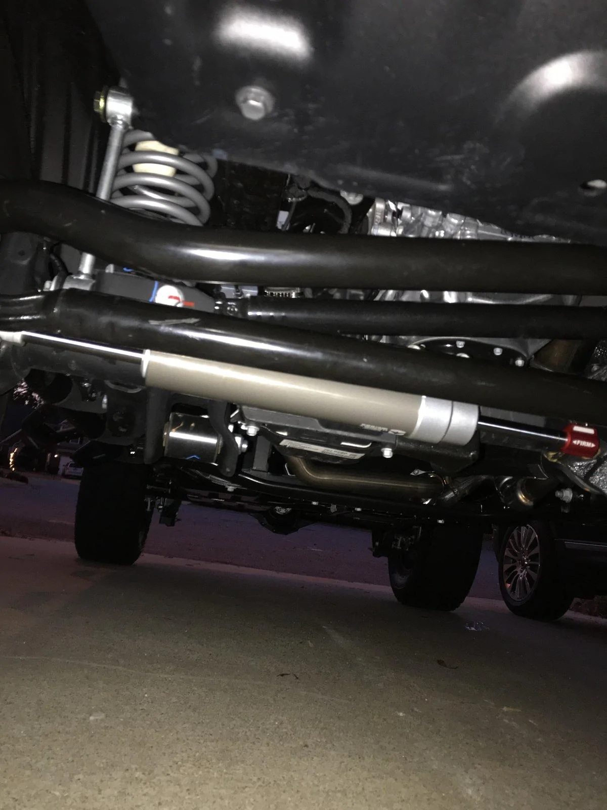

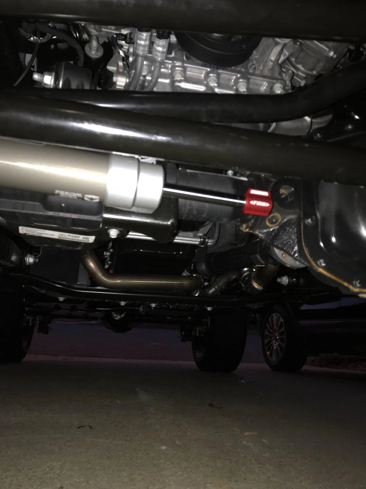

I installed my 2.2 today and it was extended too long. I had my wife turn the wheels to the left and I put it on the tire to compress. She turned it back to the right and it fit perfectly. My steering may have been a little loose, but it is night and day how much better it is now!
Jeep Wrangler JL falcon steering stabilizer EBE6D917-514D-4429-9FF3-42BC7F682159
Jeep Wrangler JL falcon steering stabilizer D435D883-EA85-4CF1-8633-B70E3B09BF34
