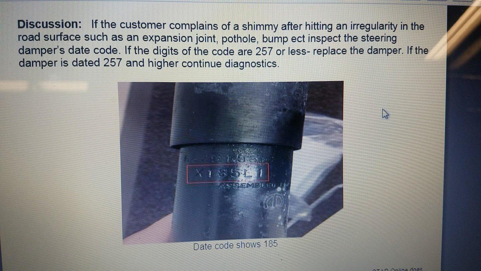

I wanted to thank jeremyjeep for the info about the bad factory steering stabilizers. Mine was no. X151 it's already been replaced.
The only issue with my steering was when I hit uneven or pot holes in our great Michigan roads the wheel would give me feedback.
What I mean by that is when I hit a pot hole the wheel would shake back and forth in my hand. I got a Falcon 2.2 adjustable stabilizer.
All I can say is it took 95% of the shake out of my wheel when I hit something. You can feel the different settings, I'm using medium most of the time. I also replaced the stock track bar with a JKS Heavy Duty unit. I will also be replacing the lower control arms with heavy duty (non adjustable) fixed units. Tire pressure is right at 38. It drives really great now. My ball joints were also barley (the bottom ones) hand tight, I tightened all 4 of them the first week I had it. I also went thru all the steering components and made sure they were tight. This was my experience I just wanted to share it with everyone. This is a great forum I have learned lot. Yeah I was crawling around under my Jeep looking at all the welds to! So far no recalls.
