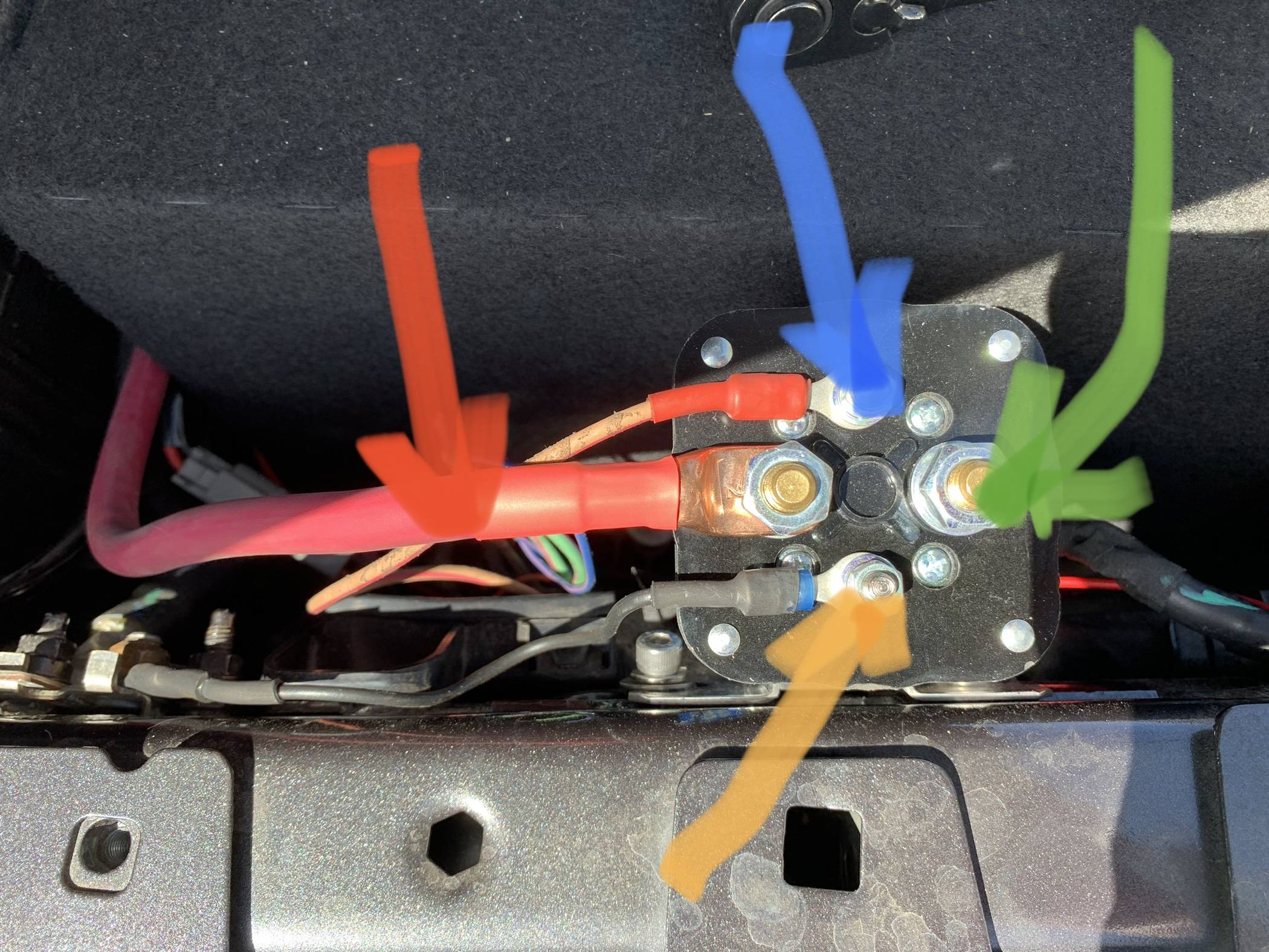

I put Deutsch connectors on the 4 Aux switches under the hood and can easily move things around. My winch is run to a Stinger solenoid and triggered by Aux 1 …
Jeep Wrangler JL Factory Aux switch issues IMG_7729
The 4 aux wires under the hood are the same color as the wires under the dash.

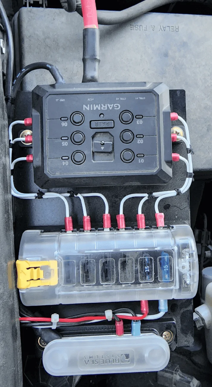

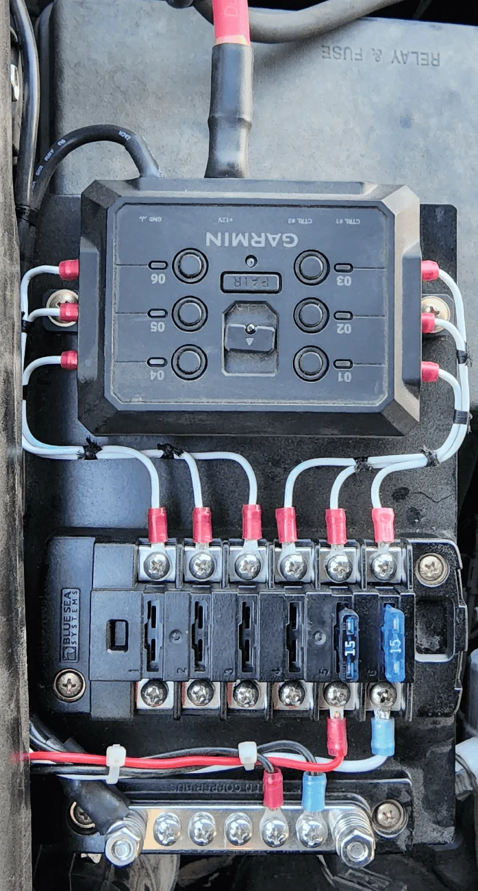

If your looking to wire in AUX switches but don't want the hassle of wiring under the dash etc. I would look into the Garmin PowerSwitch its controlled via bluetooth to your phone or other devices with a free Garmin app. I wired this into my buddy's Tacoma under the hood on a aluminum plate that I cut but, I do believe that you can purchase a mounting plate online. The Blue Sea blade fuse block is not really necessary I just installed it for neatness & easier connection for my buddy to install future accessories. I will be installing one on my JL when I purchase future accessories that need switching. I have the factory AUX switches which power up my accessory lights and all four are now taken. Here are a few parts I used.
