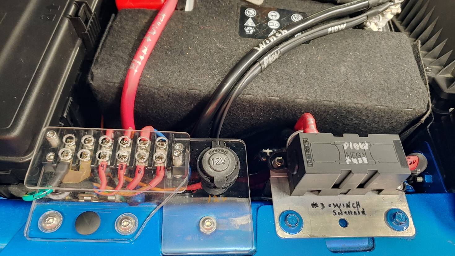

Make it SIMPLE -
Any device I control via aux switches can be quickly disconnected, moved, whatever. Simple small screwdriver.
The 12v outlet is for my Christmas wreath - rather than running into the cab or wiring any other way, just plug it in. It's on the same circuit as the inside 12v outlet which is rarely used.
One battery cable to my winch disconnect solenoid, then I use the hot side of the solenoid as a junction point for the cable coming up to the fuse for the snow plow.
Simple, clean, organized, easy to mod, easy to disconnect in event of a problem as opposed to a direct solder to aux wire connection. All home-made out of scraps in my shop. (except the terminal strip that came from Menards)

Super clean!
