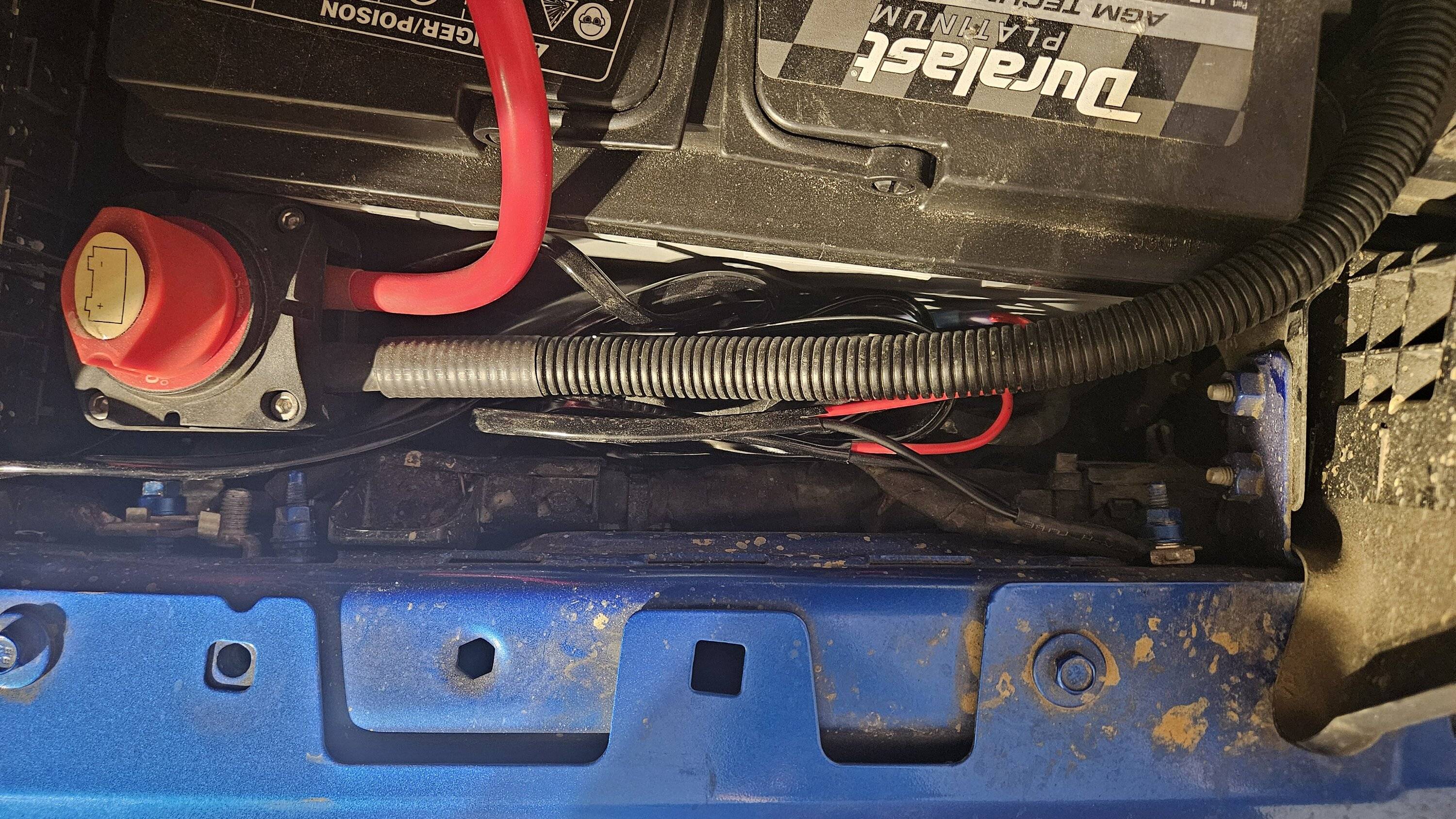

If it's helpful, here's a photo of my (poorly organized) battery area.
Jeep Wrangler JL Factory Aux switch issues 20240221_130839
You can see the three blue screws along the rail - any of those are good for grounding. You can see the one black wire going to the one on the right - that black wire is coming off one of my a-pillar lights.
Underneath the big fat black wire is the mess of other wires coming from my lights. The reds from each of those is connected to the appropriate AUX wire from the little bundle that's in this part of the battery area.
I have 2 spots (L and R) hooked up to AUX 1 and then 2 floods (L and R) hooked up to AUX 2, so I can turn them on separately. These are Nilight lights that came with the wiring harness. The harness had a relay, a switch, and an inline fuse - I simply cut all that section out. Since the factory AUX switches have the switch and they're fused, I didn't need all that.
The winch is connected directly to the battery, but with the power shutoff that you see - whenever I go wheeling, I just turn the nob so the winch is hot. When I'm airing back up at the end of the run, I turn the switch back off.
