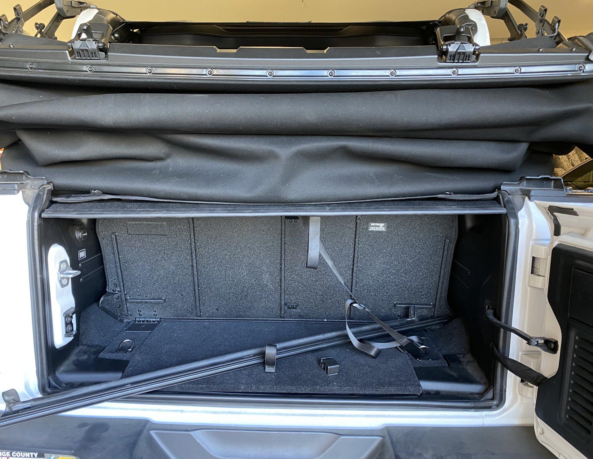

Took me and hour and a half to install mine for the two door and I’m as confused as ever, I don’t think I finished the job since I have extra pieces left. Also, as you can see from the picture below the trunk slants down to the left.

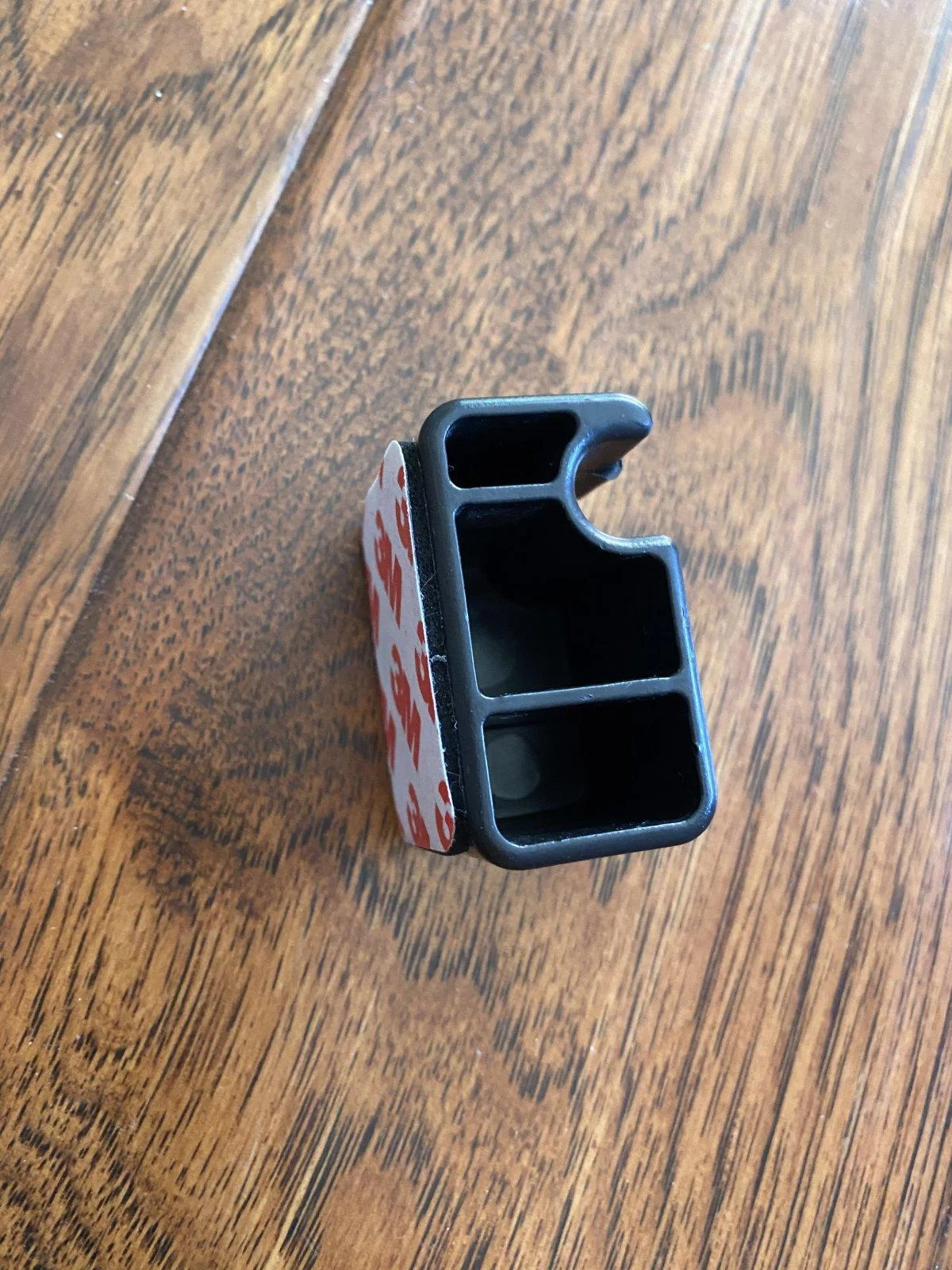

Is it because I didn’t install this piece? Manual didn’t say why I needed it. @RMS114300

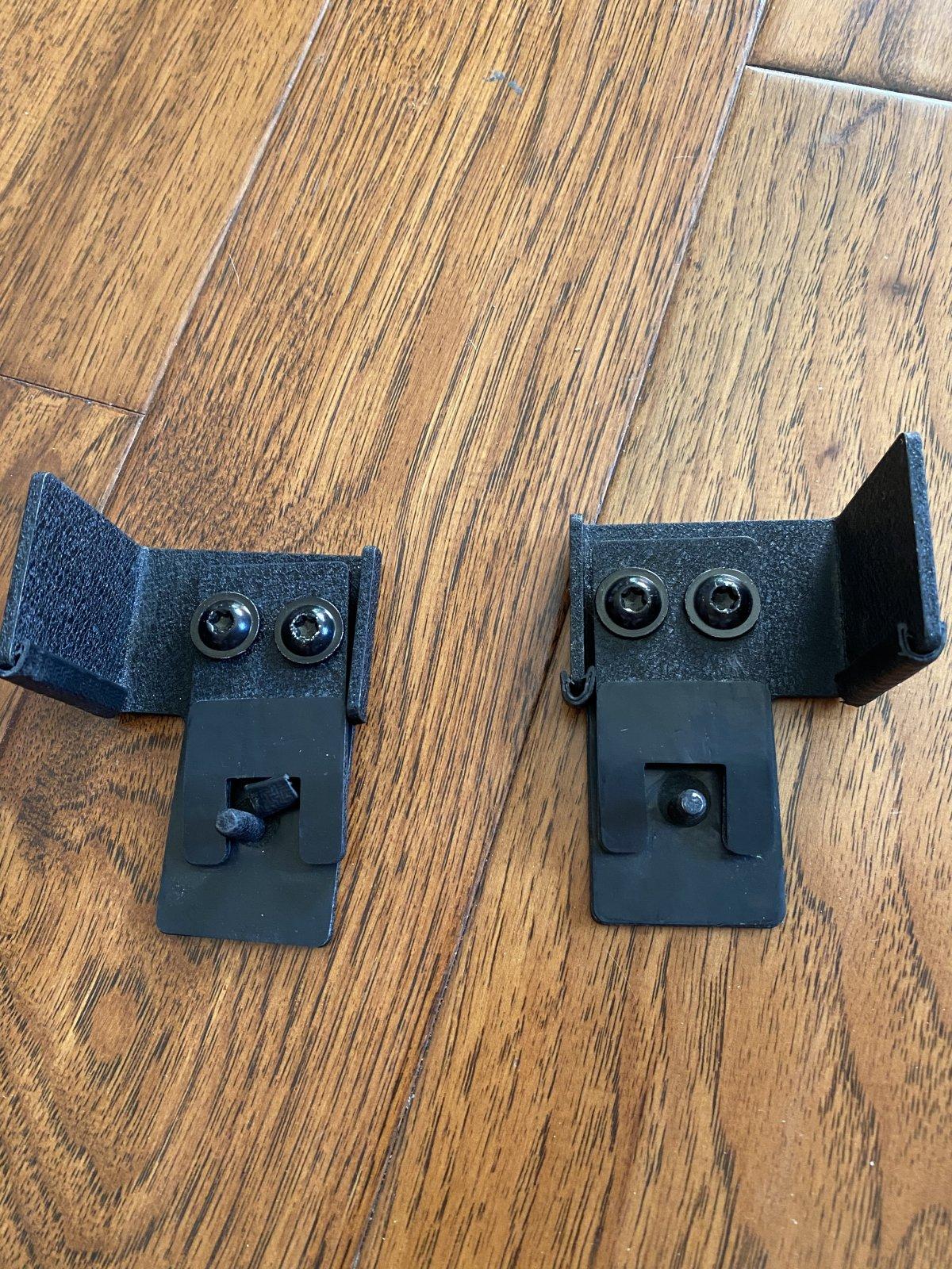

I have these left over pieces and I have no idea where to install them, the picture in the manual doesn’t seem to match my soft top two door JL?
Also, I skipped step number 7. There’s no way the d ring will fit back on there like this!
I have 4door version, and the plastic block in your 2nd picture goes to #8 in your 4th picture. On my 4door, there was a plastic piece with c ring sticking up, and I just plied it off with trim removing tool (you can use flat screw driver) and stick the new block, and the driver side of the top panel sits on it.
The pieces in your 3rd photo goes to the side hole where you bolt the hardtop through, supposedly holding down the front part of the side wing panels. I didn’t install them since I have a hardtop installed and I was not sure if these pieces sit on the hardtop or under it. There are also longer bolts included and the manual says they are for hardtop. The top panel is held fine without them.

So you didn’t install the things in the 3rd picture either? I figured the manual was written for a hard top and that’s why I didn’t really understand where they went. I don’t have the same holes in my Jeep as shown in the manual. I think it will work ok without installing them so I’ll leave them out too. Thank you, that helped very much! :like:

I think those two pieces on sides are to hold the wing part to prevent them from being plied open. I didn’t see them on their unfold/fold demonstration video, nor the product photo, so I just left them out. I tried to see how they look by handholding them around there and about the same height as the side of trunk, and they didn’t even look like touching the top of wings. Wings are held fine with the top panel of EZ Trunk held by the tailgate. I might try wiggling it later.

Yah it seems secure enough being held closed by the tailgate without the extra pieces. I tried opening it from all sides and can’t get it to open with the tailgate closed. I’m happy with it so far aside from preventing my soft top to push down all the way but it’s something I have to deal with.

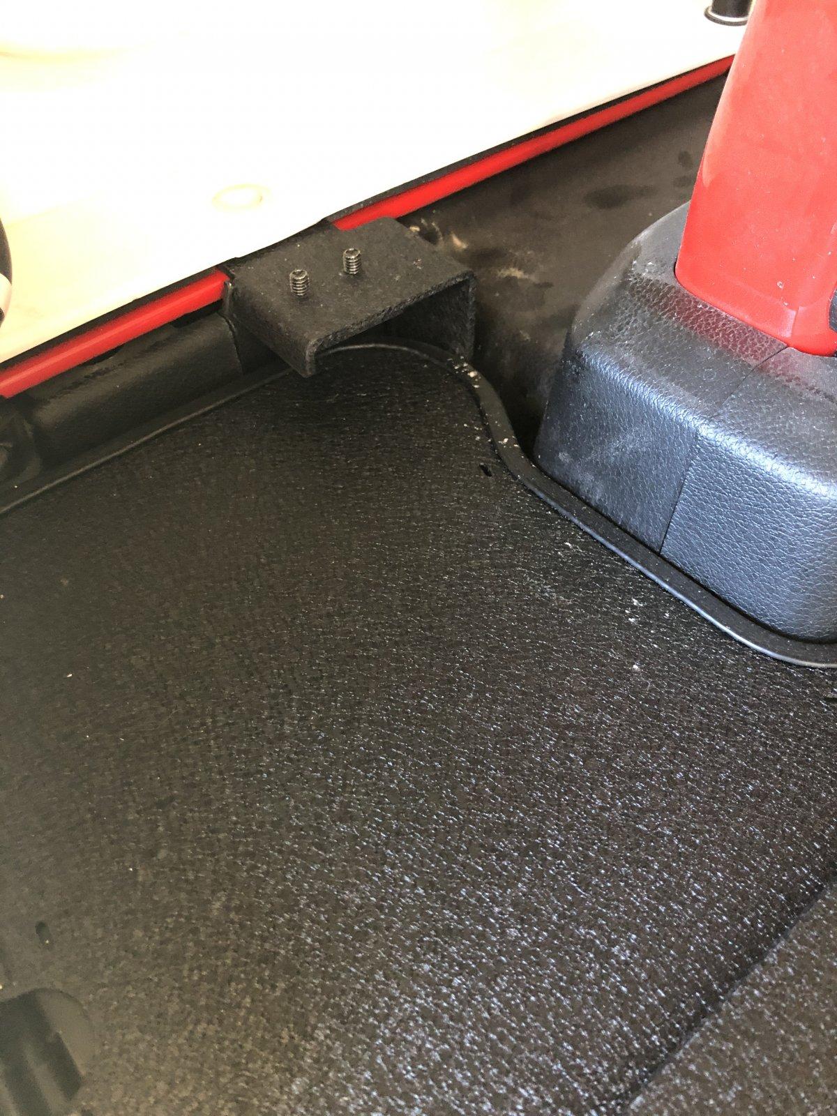

Here’s how I installed this wing pieces. Not sure if it’s correct. I have a 4dr Sahara hardtop.
