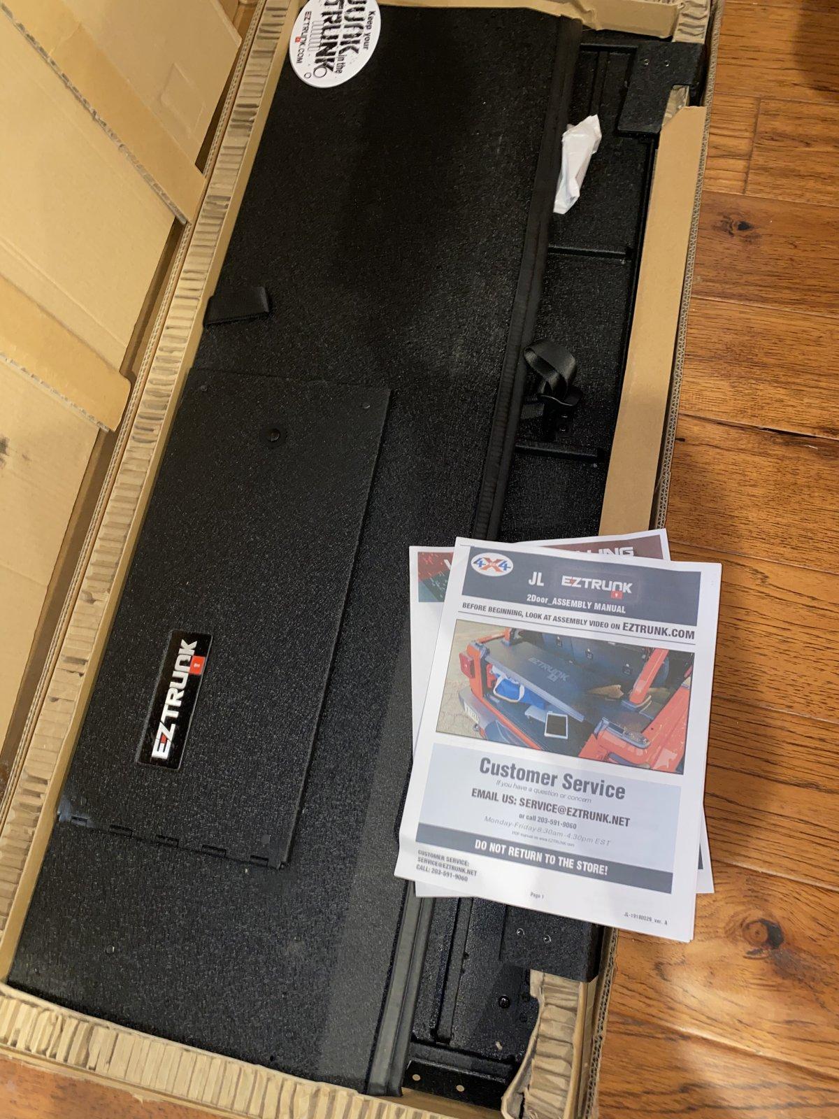

Hello All, I ordered the 2 door on Friday, got it on Monday to Florida so pretty amazed at the delivery aspect. It was very well boxed and looks to be a sturdy product. The instructions are horrible, poorly written and inaccurate in some areas making me "figure it out" on the fly. Excess hardware and not the hardware included in the instructions sheet so no idea why extra (and before you say it, they are not for a 4 door model etc as these are random screws). I couldn't finish the install and am waiting to talk to them this morning.
It looks like a great product, but the instructions were rushed to market, not to mention they say in bold letters to first watch the installation video, which of course doesn't exist as the website is no longer being used (the .com website, not the other)......so a bit frustrating at the moment.

Will try to install mine in the next couple days or so for the two door. Came with instructions but the color ink was running out that they didn’t bother to replace so it’s faded and hard to read in some places.
@2020JLR I am also missing several screws and got 5 of the same one :mad:

Most of the screws needed are already threaded into the plates and the ones in the package are spares. The instructions didn't indicate that of course, but I can see in the upper right corner of your pics that it was the same as mine....for example those two screws for the "wing blocks" are already threaded into your plate....but you may need longer ones depending on the top you have installed, and they should be in the package. Good luck, I think you will like it!
