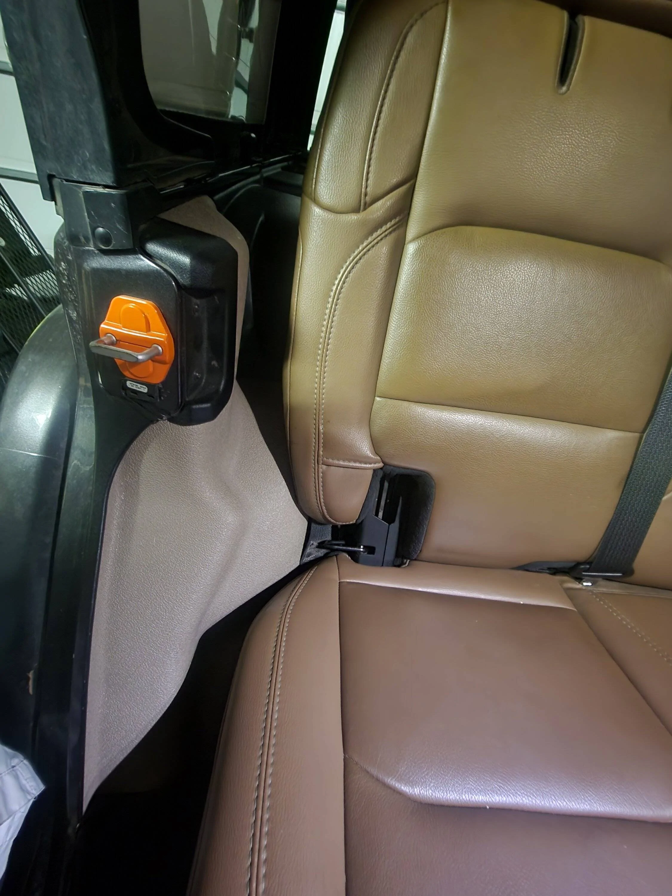

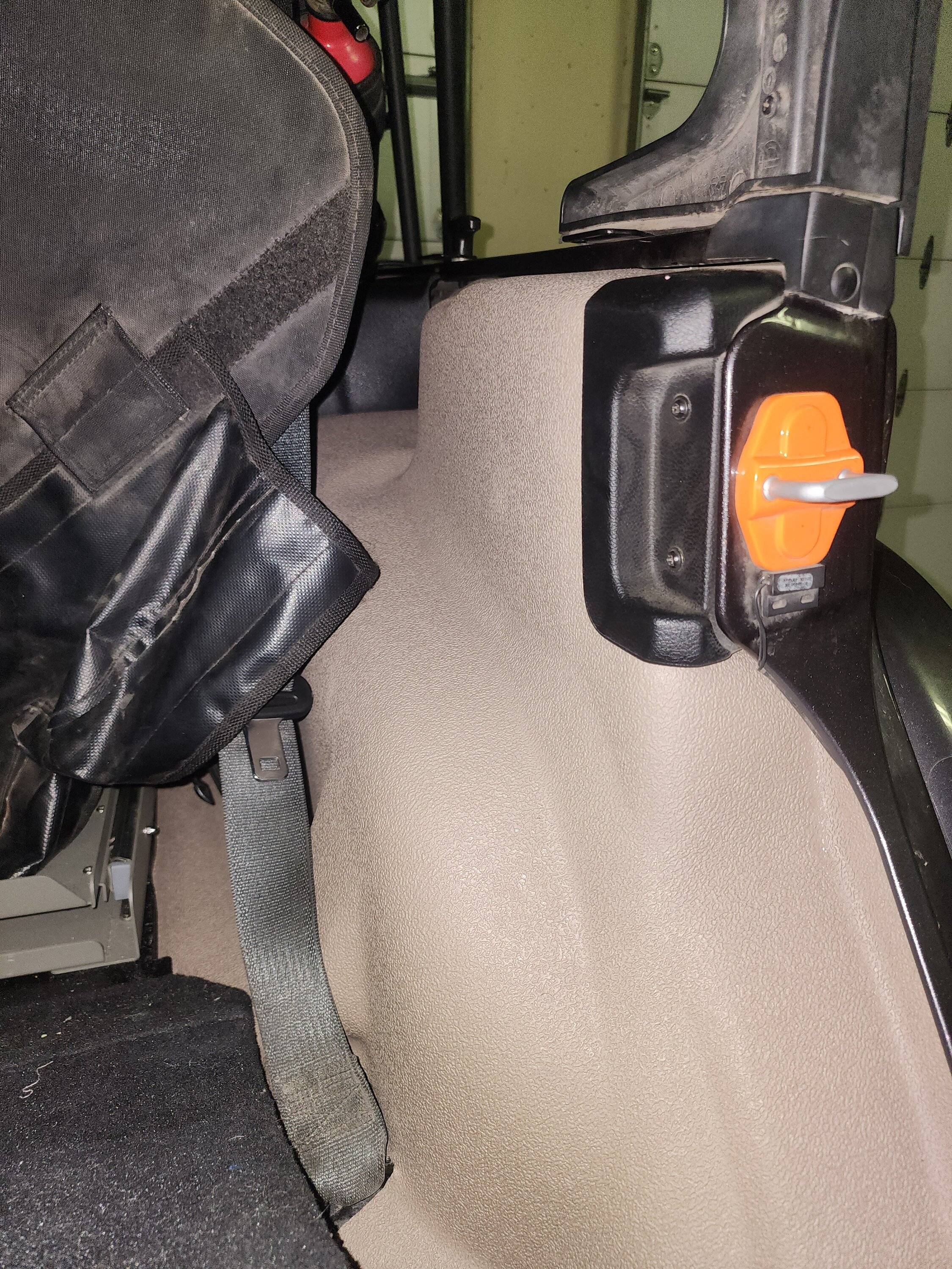

Hi Folks! Just finished installing the rear cargo area that was just released. I've had the front and rear sections done for a while and was pleased the rest was finally released. No install instructions out yet, so I figured I'd share my learnings!
Tools Needed:
  • Trim tools
  • Torx bit to remove rear cargo area bolts
Install is pretty straight forward. The trim along the door sill should be removed on both sides. Also the 6 cargo hooks should be resolved in the back and the plates taken out. Then you can pull the carpet out. Armorlite goes right in, using the trim tools to feed under the panels. The middle cover piece goes under the seats covering the top of the rear seat area Armorlite. The centerpiece goes under the rear seats and lock into place with 2 trim pieces (included).
Jeep Wrangler JL Armorlite Cargo Area for JLU Install Complete 20230831_155215
Jeep Wrangler JL Armorlite Cargo Area for JLU Install Complete 20230831_155254

Are you still able to lift the panel in the cargo area after install? Do you have images of how this looks? What about the tie downs? Do they go back in place etc? I am thinking about getting this in the spring. I also have a sub so would love pictures of that area too if you have it. Thanks.
Yes, the cargo area is still accessbile after install. The tiedowns go back, and the center mat just sits on top, similar to my husky liner.

Ahh so it doesnt replace the carpet there at all since it sits there?
