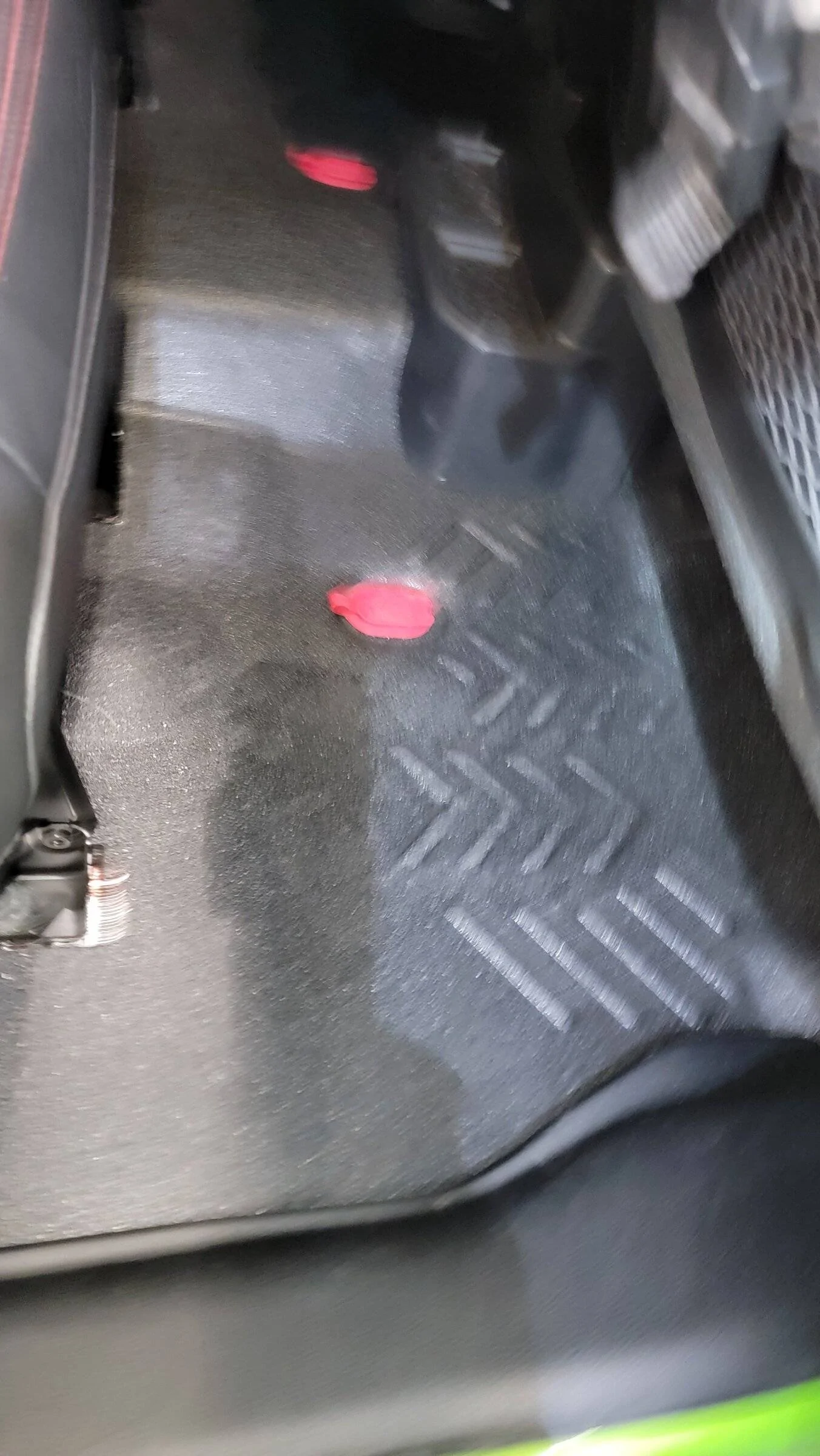

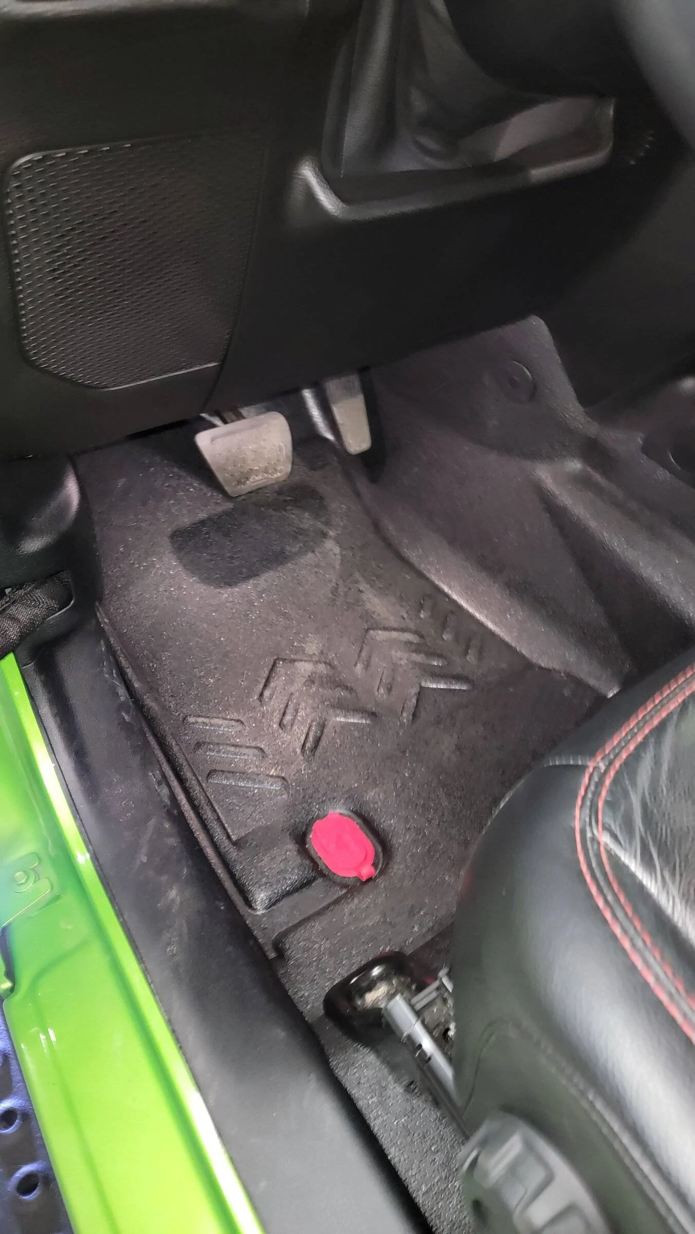

And done! I did a quick test drive and it may be placebo effect, but it does seem quieter inside. It turned out really nice and am happy with the results.

Hi! Quick question, on your flooring, did you use the carpet clips off the original carpet? It looks so much better than a hole with a pin in it. And obviously more secure.

How is the traction of the floor compared to before? Slippery when wet?
Not as slippery as the OEM mats were. It can be somewhat slippery, but it has been fine in the snow and slush.

Someone referenced this post to me recently and I wanted to address a few things incase someone is stumbling on this for the first time.
1. A sound deadener like killmat or dynamat does NOT require a blanket application. It is not an absorber, but a deadener, so it just needs to be on panels that have the most resonance to stop sound transfer. So basically if you knock on the panel and it sounds tinny, put some in the middle of that, if its a brace area and its solid, won't do much in that spot.
2. Do not put the deadener under and close to the trim and console, MOST IMPORTANT leave about 1-2" around the drain plugs. Give trim, console, plugs and seat mounts some room
3. The grommets mentioned in this thread that you once needed to remove from old carpet, we now install those for you on the Armorlite.
