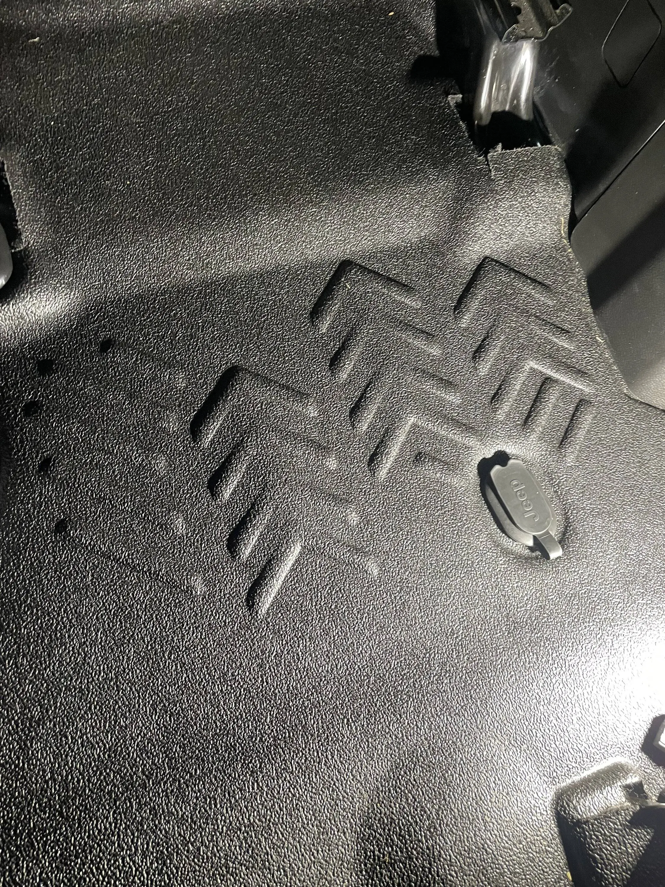

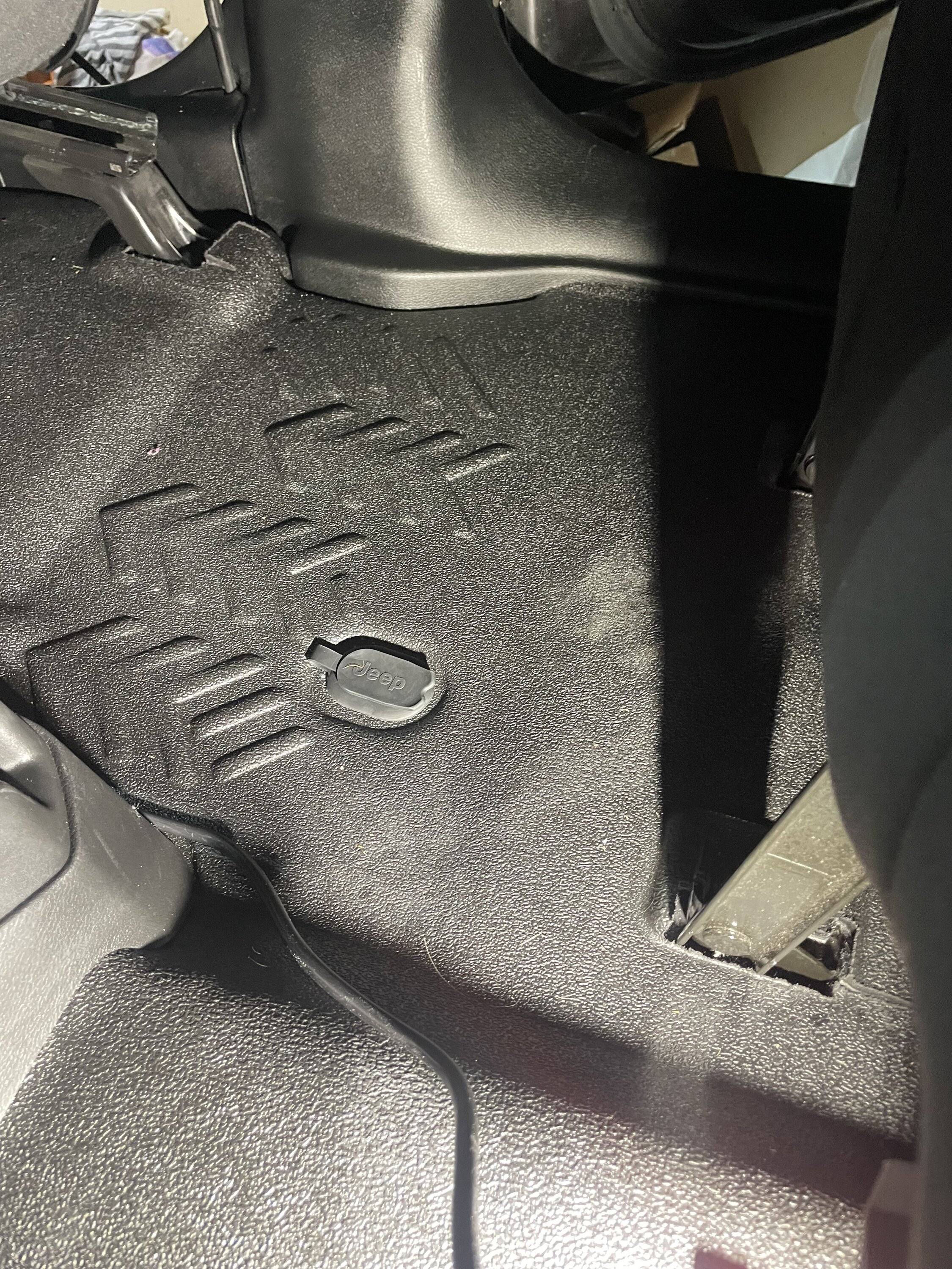

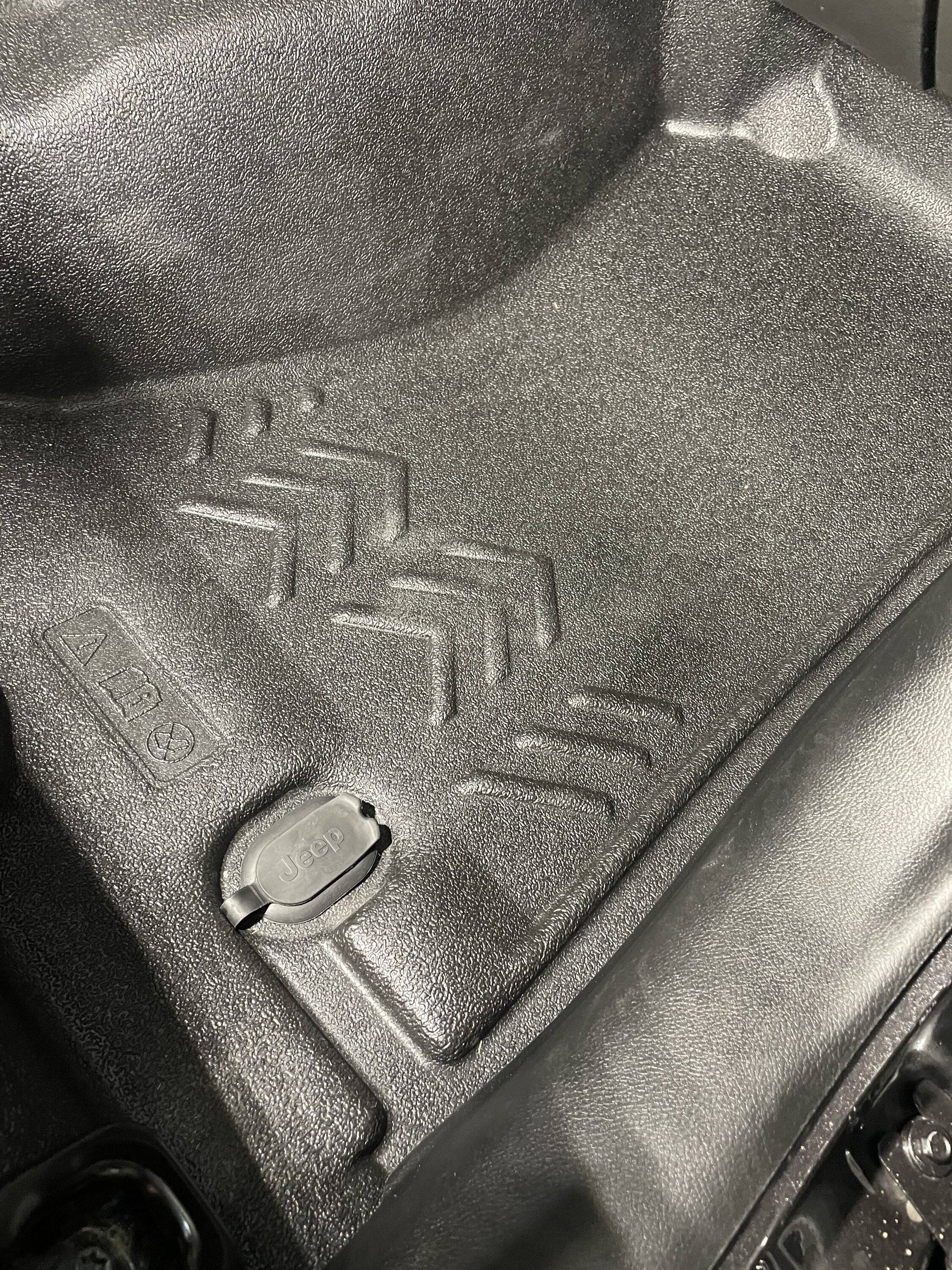

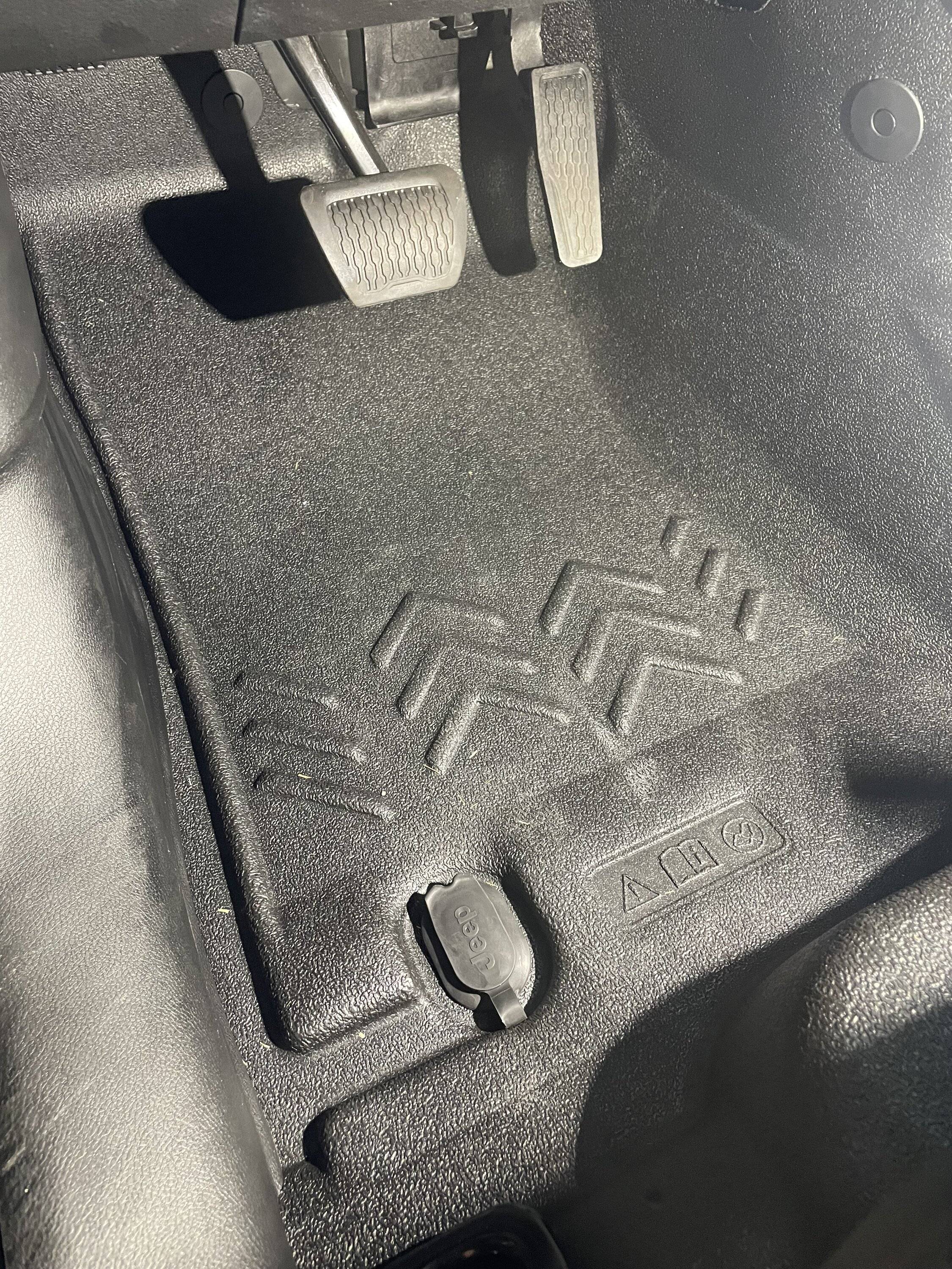

I installed the Mopar Heavy Duty Vinyl Flooring. Benny from @AllMoparParts.com helped me out a ton with ordering. I can’t recommend him more.
Unfortunately, Jeep engineering is still working on drafting the installation instruction so until that happens, there are none.
Good news, though, is that this is basically the Armorlite flooring. So, you can use the Armorlite YouTube video and install instructions to guide you.
Install is straightforward. It does take time to remove all of the door panels. In addition, you have to do some finagling wto get the drain hole cutout to line up with the drain holes in the floor.
Afyer you take out the carpet, you’ll see how much dirt and debris gets caught under the carpet. Before installing the new flooring, I vacuumed and washed the floorboard.
Other than that, not much else to say. They are a huge upgrade from the all weather floor mats my JLU came with. The new flooring also comes with sound deadening insulation underneath which is an upgrade over the carpet which has little to none.

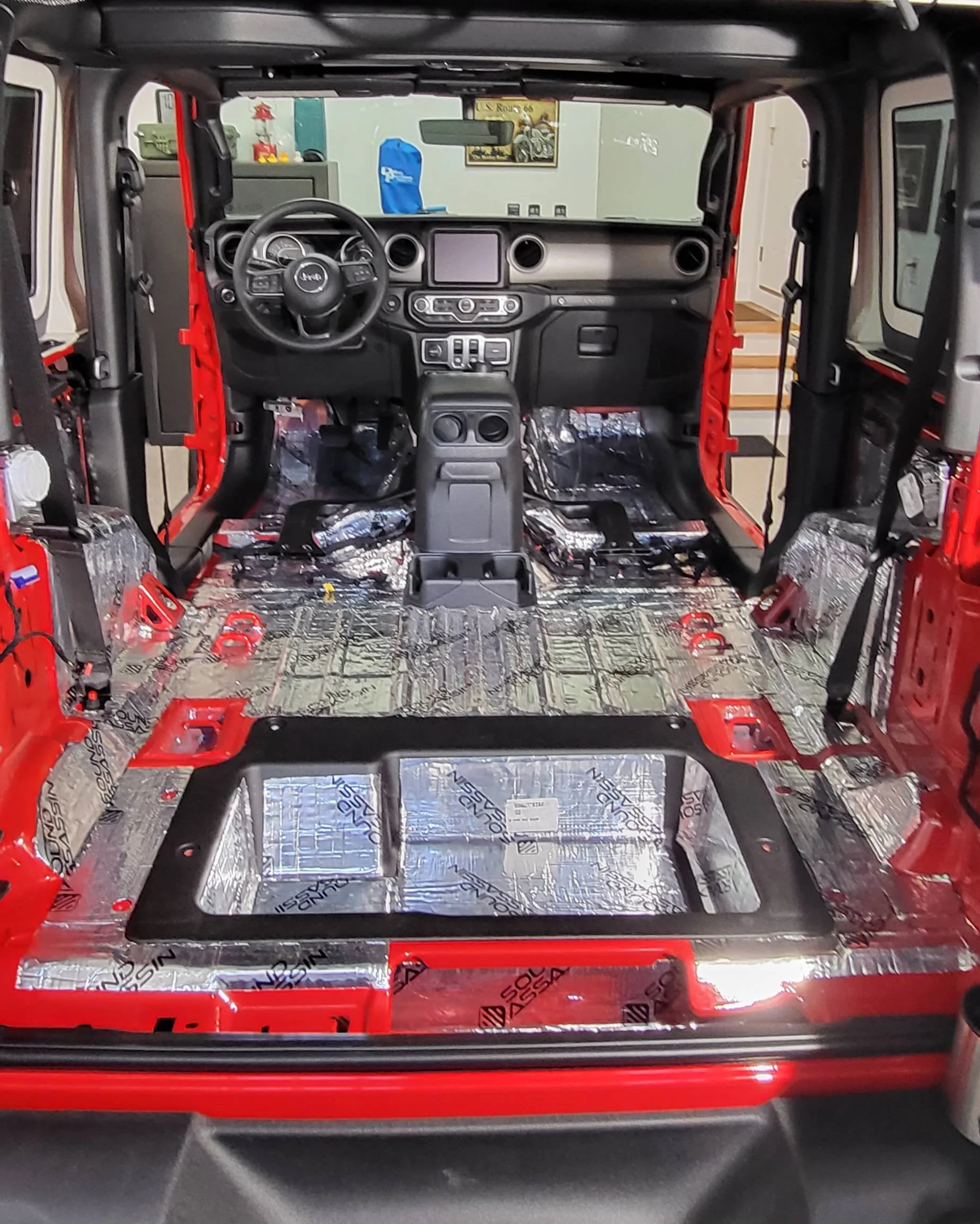

Its really an OCD thing that I want the entire set or nothing. Plus, I think Ill get some Sound Assassin or the like for sound deadening when I get it.
I'm running carpet, but let me tell you, if you pull the trigger on Sound Assassin (or similar), you will NOT regret it!
Major difference! ?
