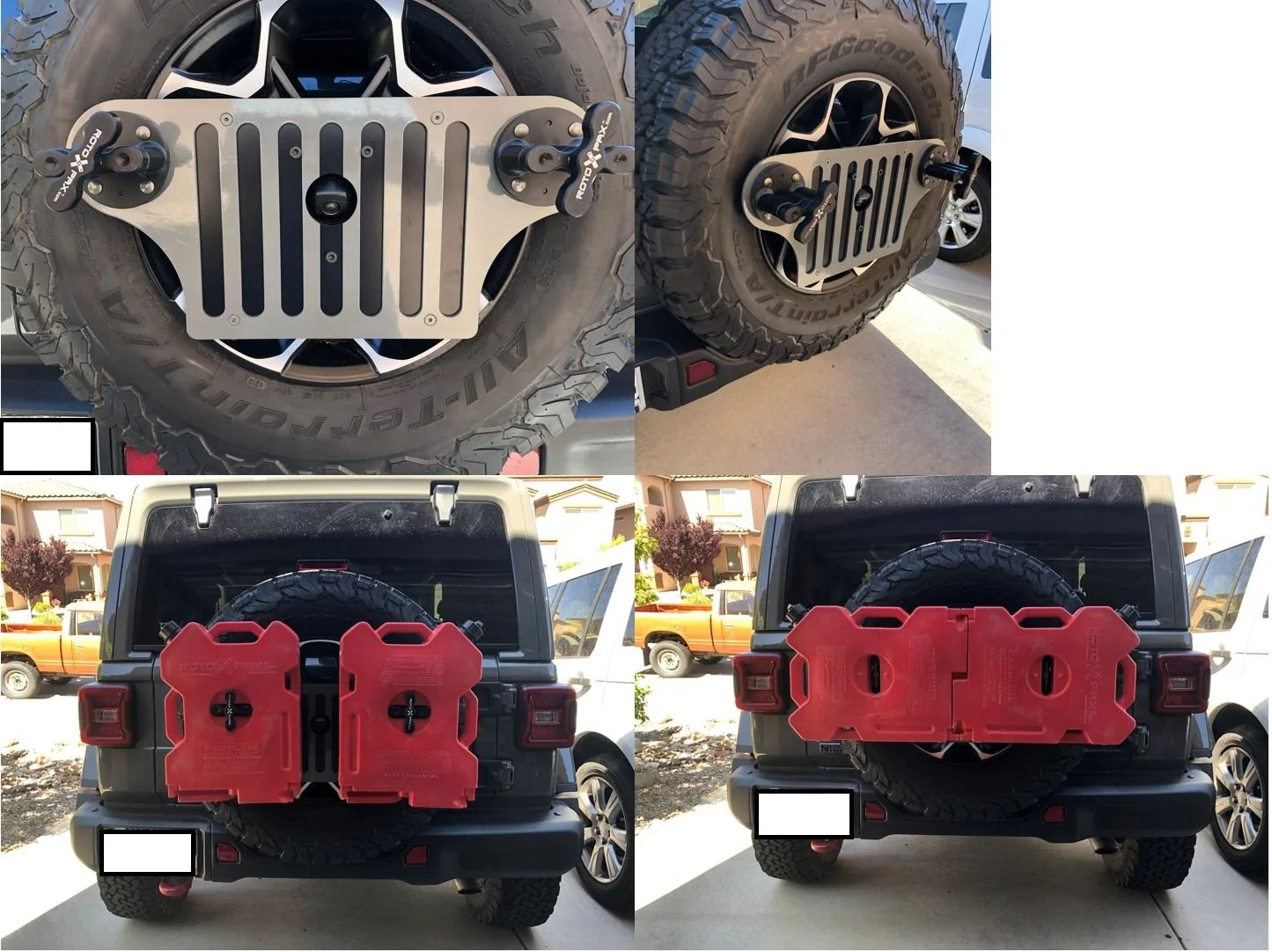

Where there's a will there's a DIY way! Couldn't find anything I really liked without changing the stock metal Rubicon bumper. Fortunately have a brother who's a genius with metal and paint. The basic mount is two pieces of 3/16" steel (one black, one color matched to the Jeep), weight comes in at about 16lbs.

@RichP
Very interesting. With mount and two full 2 gallon cans you are pushing 55-60lbs. Any issues having the weight out that far on the tailgate?
How many inches from the top of the camera tube to the top of the metal mount?
Also, if your brother decides to make another, list it and price it. May be interested.
ETA: Can he make from aluminum?

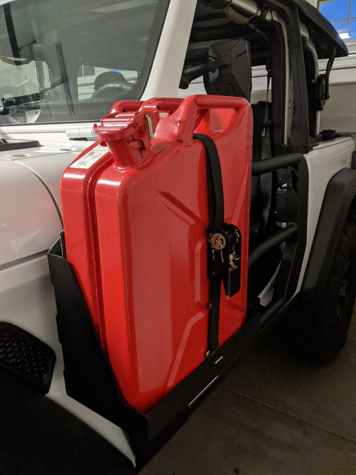

Jerry can came in tonight, looks great. One last teaser picture before I do a write up and road test.

it looks like it would not work with most rock sliders like LOD destroyer as you can’t access the pinch seam holes

I considered the added weight question, as compared to folks adding larger wheels/tires and adapters I feel comfortable with this setup. As always the real test will be to take it out and bang it around a little, and of course after bolting it on I used the highly scientific method of grabbing the setup and lifting up and down to make the whole Jeep move! Seems pretty solid, time will tell. I did consider aluminum and might have to think about trying that, 2 sandwiched layers of 3/16" steel is probably overkill. From the top of the camera housing to the top of the bracket is 3-1/4". The RotoPax mounts are centered horizontally on the top two lug nuts mounting the spare.

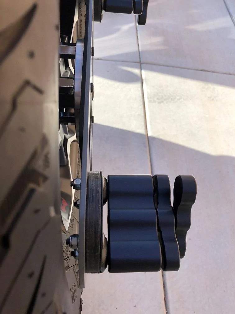

Also, here's a pic of clearances/hardware behind the bracket.

LOD Destroyers will be here within the next week or two. I read the LOD instructions and don't see any issues. Will report back once they are on.

The trail rated badge was a big concern, might need to glue two of them to the mounts to make up for it.
It does stick out past the fenders a bit, perhaps the rotopax mount would be a slimmer option.
