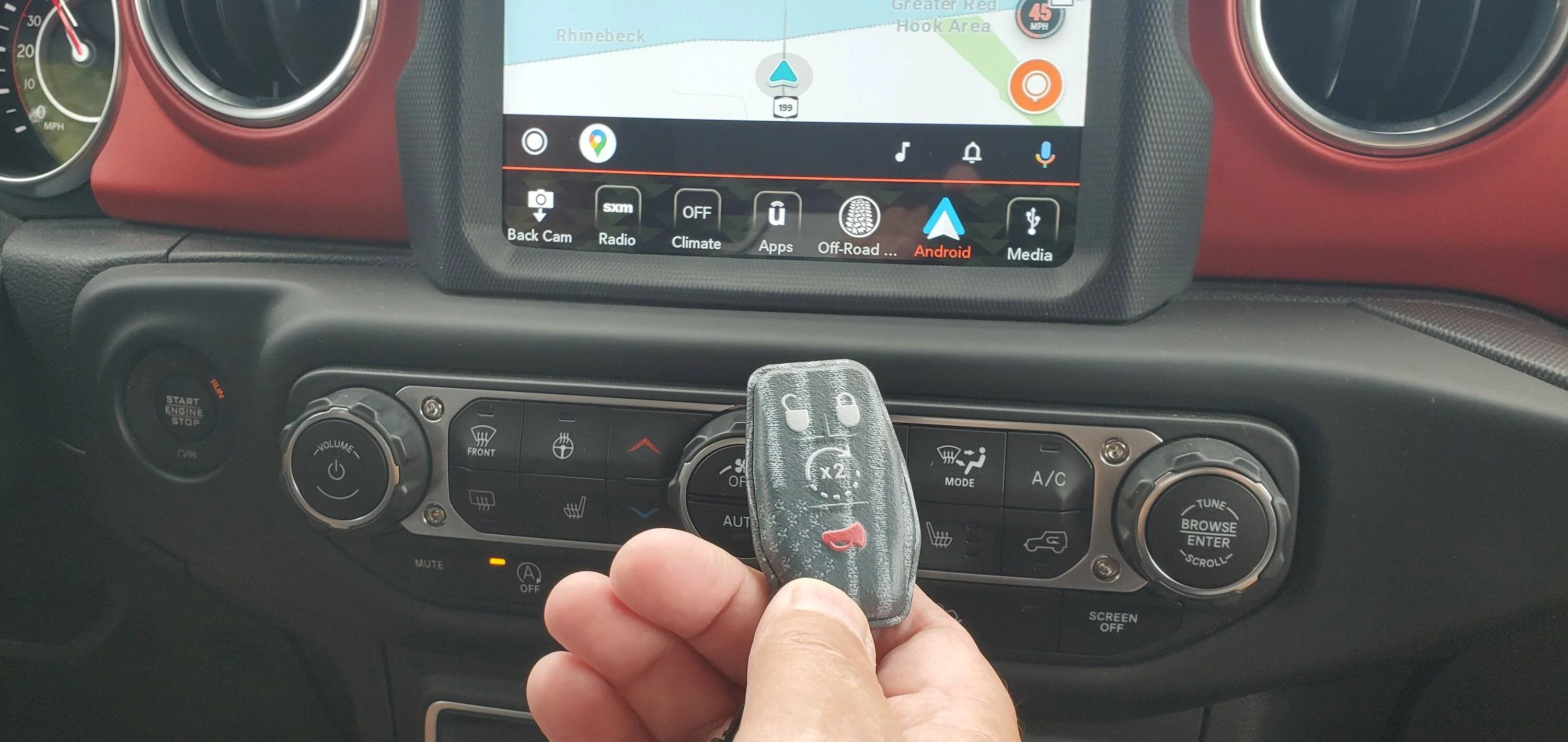

Your are no limited to two. I got a third one from the dealer so I could have a spare with me and a spare at home for a recent cross country trip. I also tested removing the circuit board and battery from the fob for my sport (manual locks and windows) to use as a spare. I could use the shell with the RFID chip to start by pushing the start button with the tip of the fob and if needed, install the battery in the circuit board to use it to start the jeep.

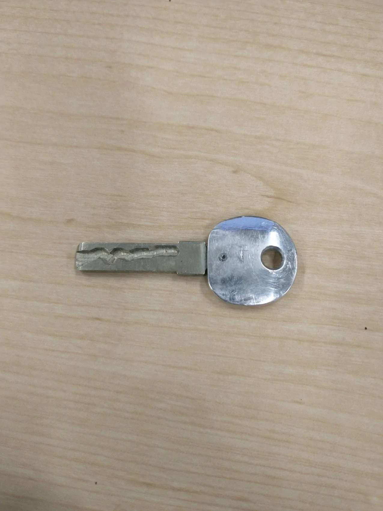

But techniques to leverage this limitation have been discussed. One solution involves keeping the backup fob on the Wrangler, hidden, inside a Faraday bag, and having a backup physical key cut (which doesn't have to be by a dealer). Likely the key is also hidden.
Lose your original fob and get in with the physical key. Worse case scenario, the auto alarm screams until you locate the backup fob and disarm the vehicle.
