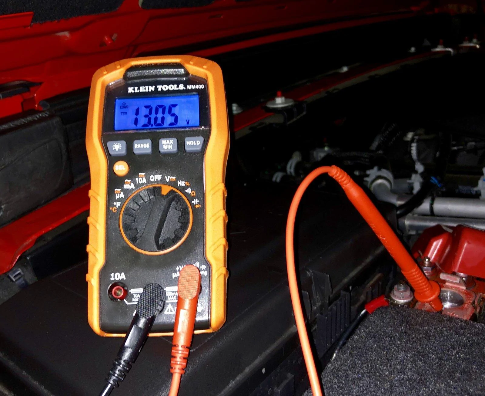

Well after about 3+ hours on the battery tender it say battery is 100% so checked with meter and getting 13+ volts while battery at rest, I put the negative and positive leads on the main battery without disconnecting anything but the tender, is there a simple way to check each battery separately without disconnecting anything.
I thought I read you could put the positive lead on N1 to get the main batt and on N2 for ESS and just use the negative off the main for both
