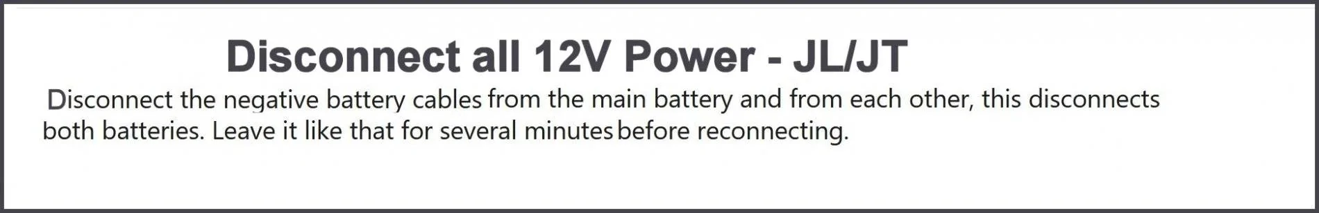

Based on my research, I believe this to be correct.. Can you add to or correct the following.. 8-)
IBS > Clear/Reset:
Disconnect all 12v power to the JL/JT *
Now, when 12v power is restored, the IBS starts a lengthy relearn process.
Until the relearn process is complete, accurate battery state (MAIN battery) information is unavailable to other vehicle systems.
This relearn process requires 5 normal, operator initiated starts with at least eight hours off time between each start. Usually, the process takes a few days of vehicle operation to complete.
Important: The relearn process is restarted every time power is reconnected to the IBS after a complete 12v power disconnection in regard to the vehicle. This has a major effect on the stop/start feature. (ESS)
On edit: I forgot to mention, that you can, with vehicle turned off, just unplug the IBS, leave it unplugged for a few minutes and then plug IBS back in and that to will restart the relearning process.
IBS > Clear/Reset:
Great info. When I just recently replaced my main battery, I had the AUX disconnected. So, without doing it with intent, I had removed all power. I guess I did and IBS reset, then.

@Jebiruph
IBS > Clear/Reset:
I cannot add to or correct any off this. There's more detail here than what I was aware of.

Actually your last post made me realize that I did not say... I forgot to mention, that you can, with vehicle turned off, just unplug the IBS, leave it unplugged for a few minutes and then plug IBS back in and that to will restart the learning process.
I will go back and edit my post... 8-)
