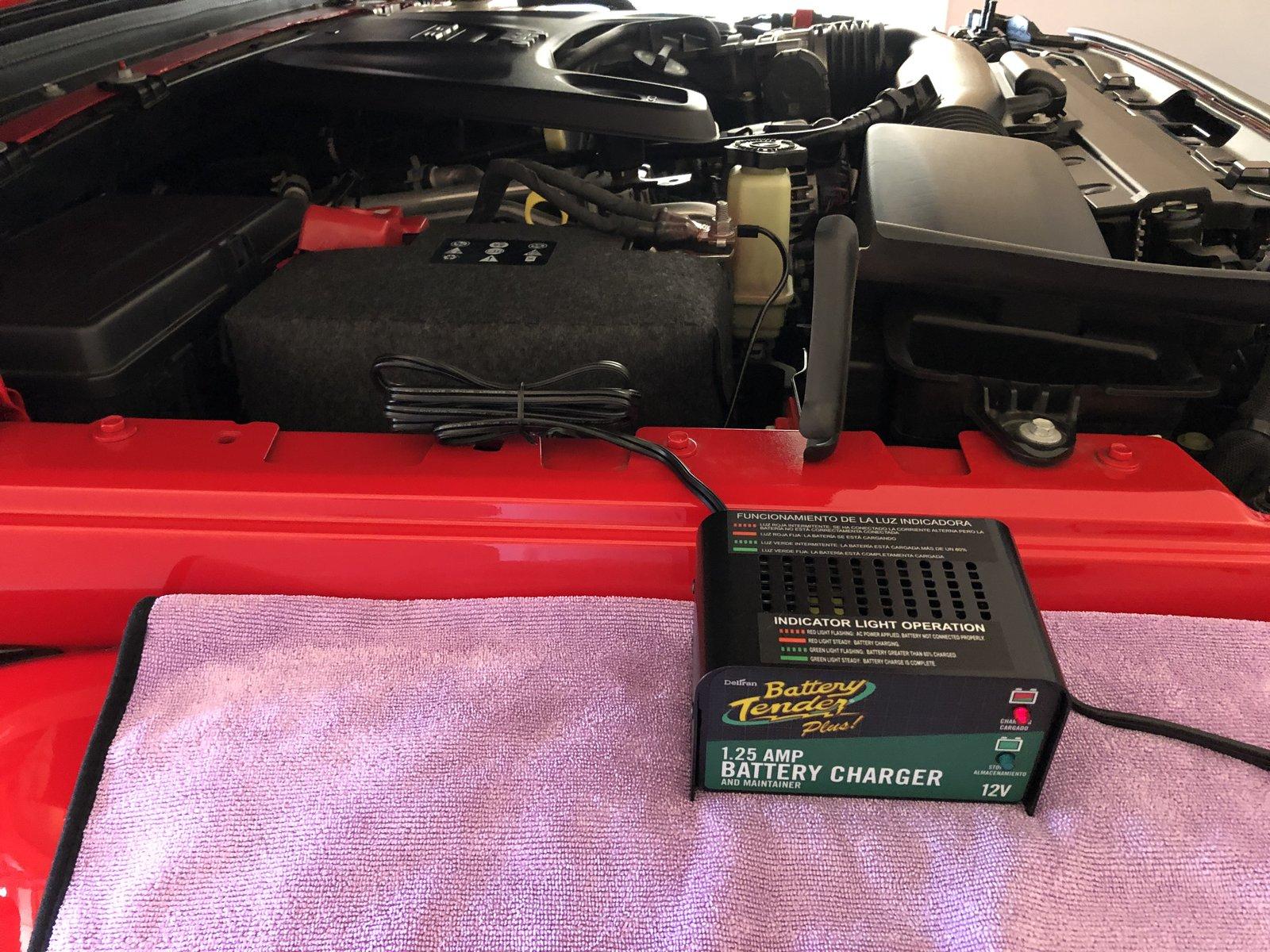

When I get home tomorrow morning I am going to catch some sleep and then wash it and wax it then put on the quick connector for the deltran battery tender and hook up the tender until I get a solid green light and then see what type of voltage I am getting with my new meter.
My Jeep does sit sometimes for several days after after doing some research and talking to a few members I decided to follow there advice and use a battery tender just to keep the battery healthy, I know the battery is not gonna last forever but anything I can do to prolong its slow death I will and the way these new vehicles have a parasitic draw is a big killer and I don’t think the alternator can keep up with my short distance rides.

Well decided to pass on sleep and did a quick wash and quick detailed then popped the hood and hooked up the quick connector and plugged in the tender so we will see how long it takes

Well maybe my new battery was pretty charged up when I got it, after just two hours the red light remained on and the green is flashing, from my understanding that’s about 80% charged so going to let it ride till solid green
