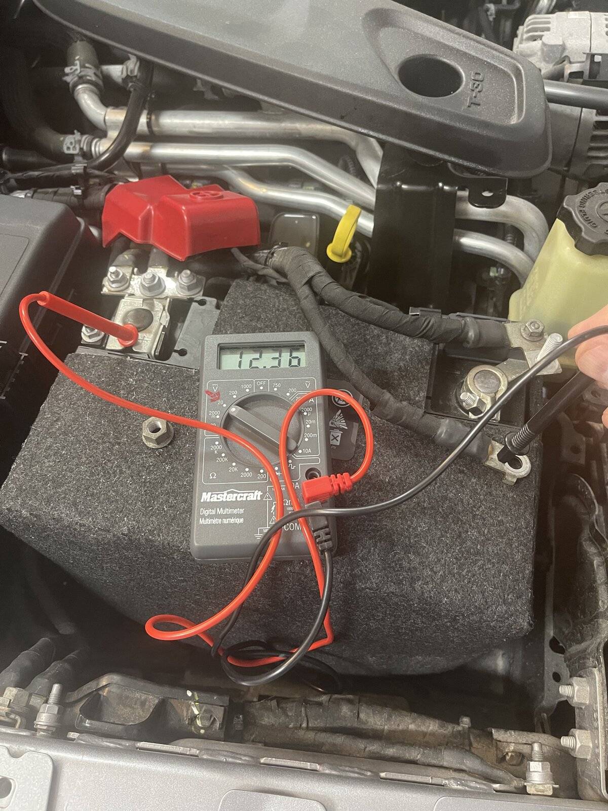

Ah cool, good news, I like that?… Now to find what is wrong with my ESS?
Just took a reading of the ESS battery by disconnecting its negative cable to isolate it and got this

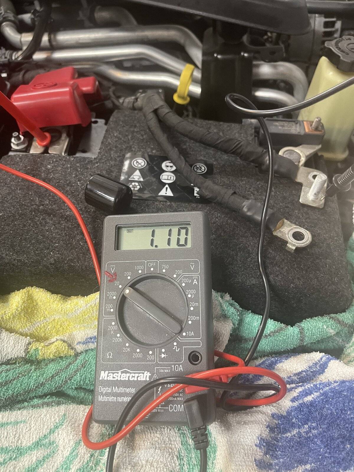

Then thinking I might have the new version I isolated the other one and got this:
It looks like you have the old version. The black thing on the negative battery terminal is the battery sensor (IBS), disconnect it to reset it and let it relearn the main battery.
I didn't think of it at the time, but for future reference, when you disconnect both batteries like this you removed all the power from the system which would have already reset the IBS.

So does the reading of the ESS battery shows that its good or bad ??
Hey Steph1:
I am hesitant about drawing any conclusions about the acceptability of your ESS battery from your 12.36 volts voltage reading alone--which IMHO is low and probably a, if not "the" factor in ESS not engaging. True tests of the battery lie in the use of load testers, not multimeters.
As trickle charging your vehicle is an inexpensive and often beneficial thing to do regardless of where fault lies here, I recommend that if you park in a place with accessibility to shore power, that you place, as discussed by me prior, a good trickle charger on the posts of the main battery for a few days and see what happens. Again, on the 3.6L JL at rest, this will charge both batteries.
We can discuss future directions for you to take after we've ruled in or out that trickle charging allows your ESS to engage. I can tell you that I do this, and need to to get ESS to engage, and am an infrequent driver like you.
Do I like having to do this? No. But it does work for me and other owners.
If you need a trickle charger recommendation you can repost or search here.
