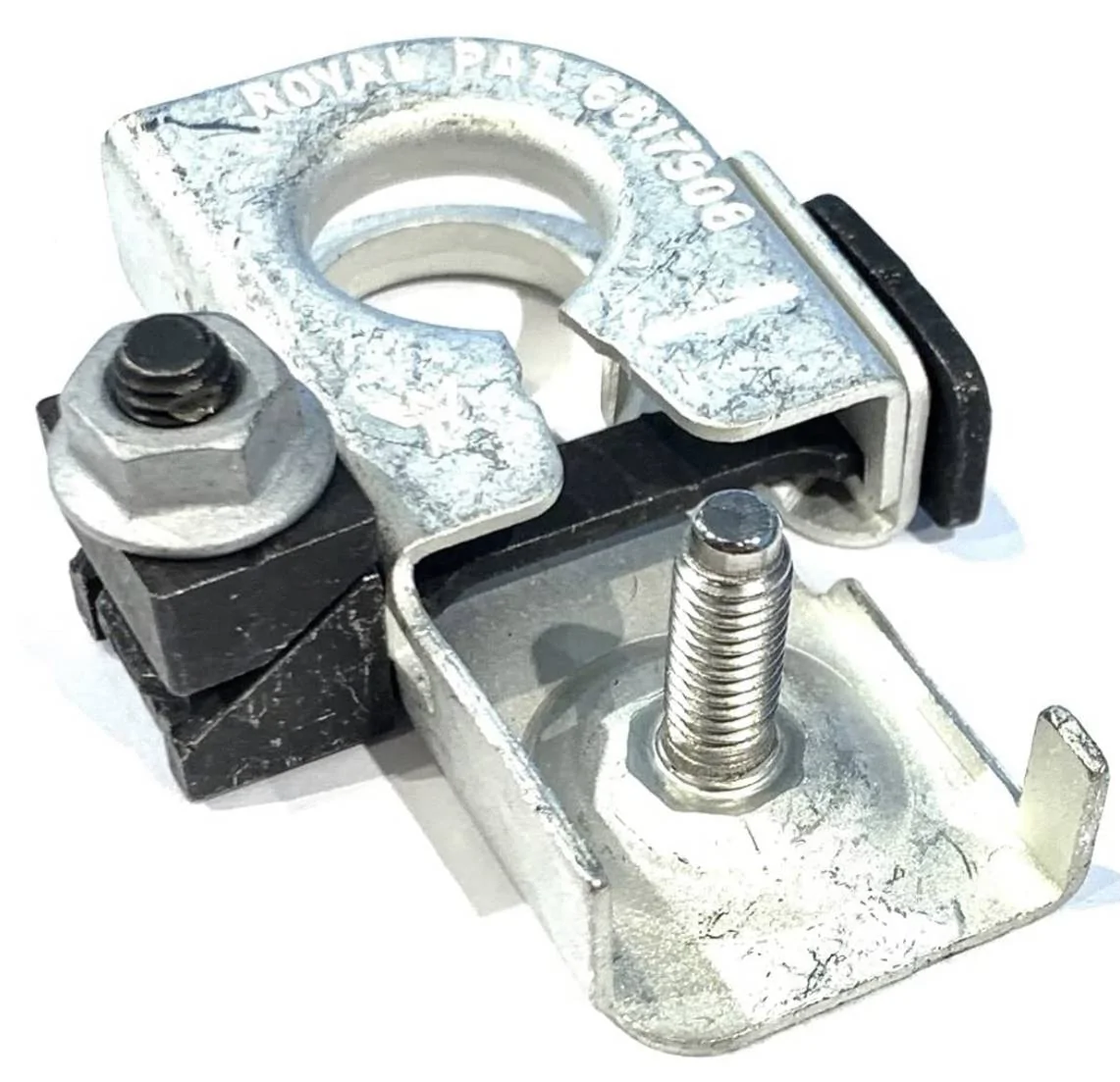

@Steph1 anyone of the smaller terminals on the main battery is fine, I personally would not remove the main nut off the terminals that attach to the battery, the terminals themselves are not what I would call heavy duty especially the one that is on the main crank battery and remember that electrical tight is not the same as mechanical tight, it’s really easy to over tighten battery terminals.
The positive off the main is of this type and as you can see it’s some type of compression terminal that works by pushing the two slide pieces against each other which in turn compress the terminal around the post.
These type of terminals are not very beefy and don’t take much to break or bend, the negative one has several smaller nuts on the top that would be suited for the ring terminal for the charger and so does the positive.

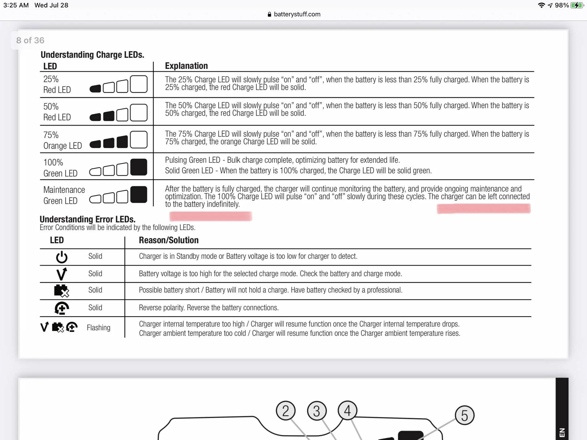

Got my terminal cables today and just finished the install and realized I forgot to ask... Can I just leave it plugged-in ??? or should I unplug it after a few days ?
Leave it plugged in and connected as long as you want, it will go into maintain mode and come on as needed as the voltage trickles down.
