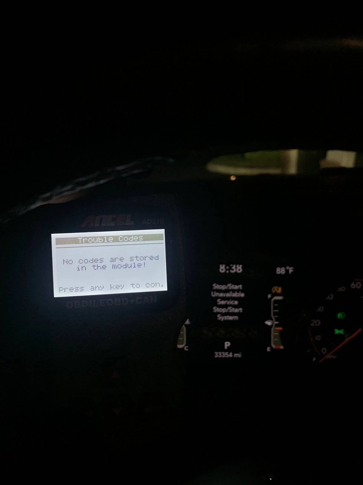

Scanner tool says there are no codes. Tried to clear codes anyway and the service stop start light is still on.

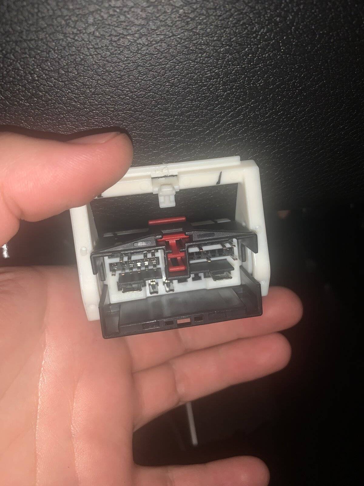

I have narrowed things down to be a problem with the door. If i unplug the door the Service ESS and autopark light do not come on. Does anyone know of a tutorial how to replace the faulty door latch that i am reading about?

Are you sure you do not have a bent terminal in the door wiring harness connector?

I just checked the door pins. All look fine. Even took needle nose pliers and tugged on them to see if any weren't seated correctly.
The door switch lighting works, locks work, exterior handle and interior handle works, mirrors work.
