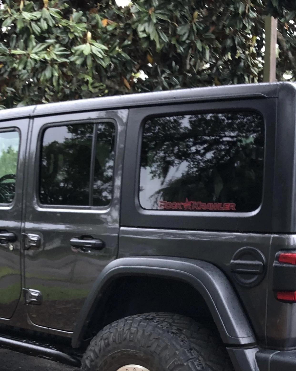

Then you need a Rock Krawler lift with their, RRD shocks, comfy on the road and a beast off the road.......:)...... but AGAIN just my .02, and this is an unbiased opinion........:giggle:.
Jeep Wrangler JL Pretty sure I've blown my Rubicon shocks.  Are Falcon shocks the best? C28DA611-224F-4225-987B-7DD78F0F1CC5

Ordered the 3.5" X-Factor yesterday for my jeep. I can't have my wife's jeep being taller than mine.
