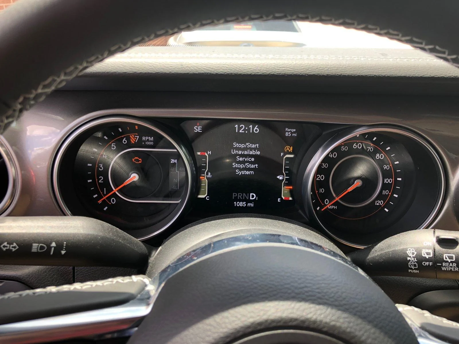

I haven’t seen this issue posted yet...
Bought a JLU Sahara last month, automatic trans with Selec-Trac, and 3 weeks ago I noticed an occasional engine stutter or sudden hesitation at random while in motion. The Jeep stalled while pulling out of my garage last week. Two days ago I was driving at 50 mph when I felt 3 successive lurches which felt like the engine was going to stall, then got a "Service Stop/Start System" warning on the dash without a CEL.
I took it to the dealer, who couldn’t find an error code. They wouldn’t be able to work on the car until Monday, so I drove it home to bring it back on Monday.
Today, it near-stalled three times again doing 30 mph and threw a CEL. I have no problems if I disable ESS. Why would ESS have anything to do with driving at speed? Has anyone else experienced this? I always drive belted in, and didn’t open the door. The hood is latched tight.

My JLUR is in the shop for the same reason. Been in there almost a week and a half and they have yet to diagnose the issue. Except mine followed up with a check engine light... hoping to get it back soon.
So it turns out this is not an ESS issue at all, though it does seem to trigger the ESS warning. The problem is the crank position sensor itself. My Jeep is sitting in the shop now waiting for a new sensor (on backorder), so I probably won't have it back until next week. This is disappointing for a vehicle I have only been driving for about 3 weeks.
You might want to point the dealer in that direction. Earlier in this thread, I linked to another post where this was happening to a Jeep Cherokee driver as well.
If your Jeep threw a CEL, they should have some place to start. It stores the code even if the CEL goes away.
