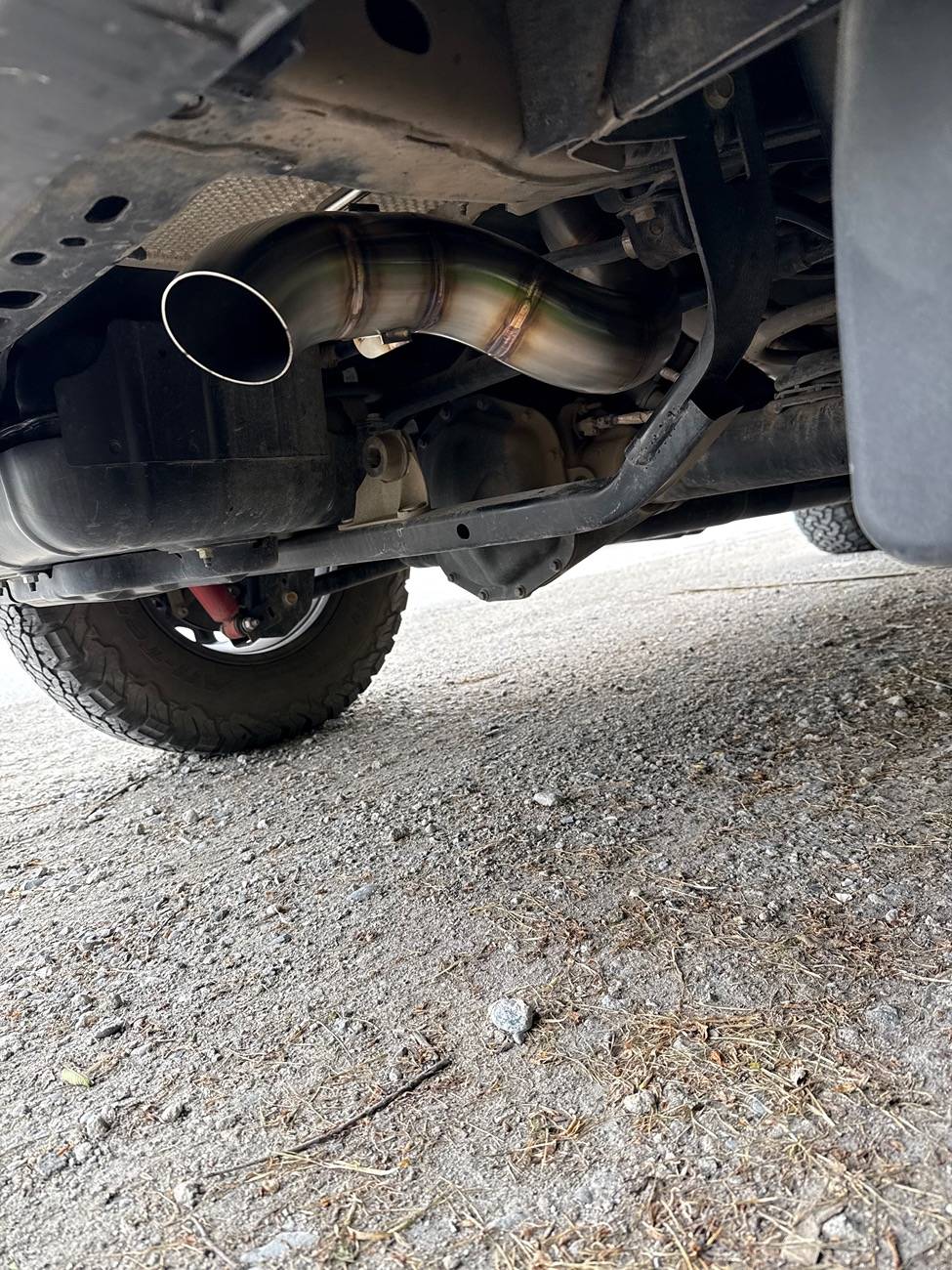

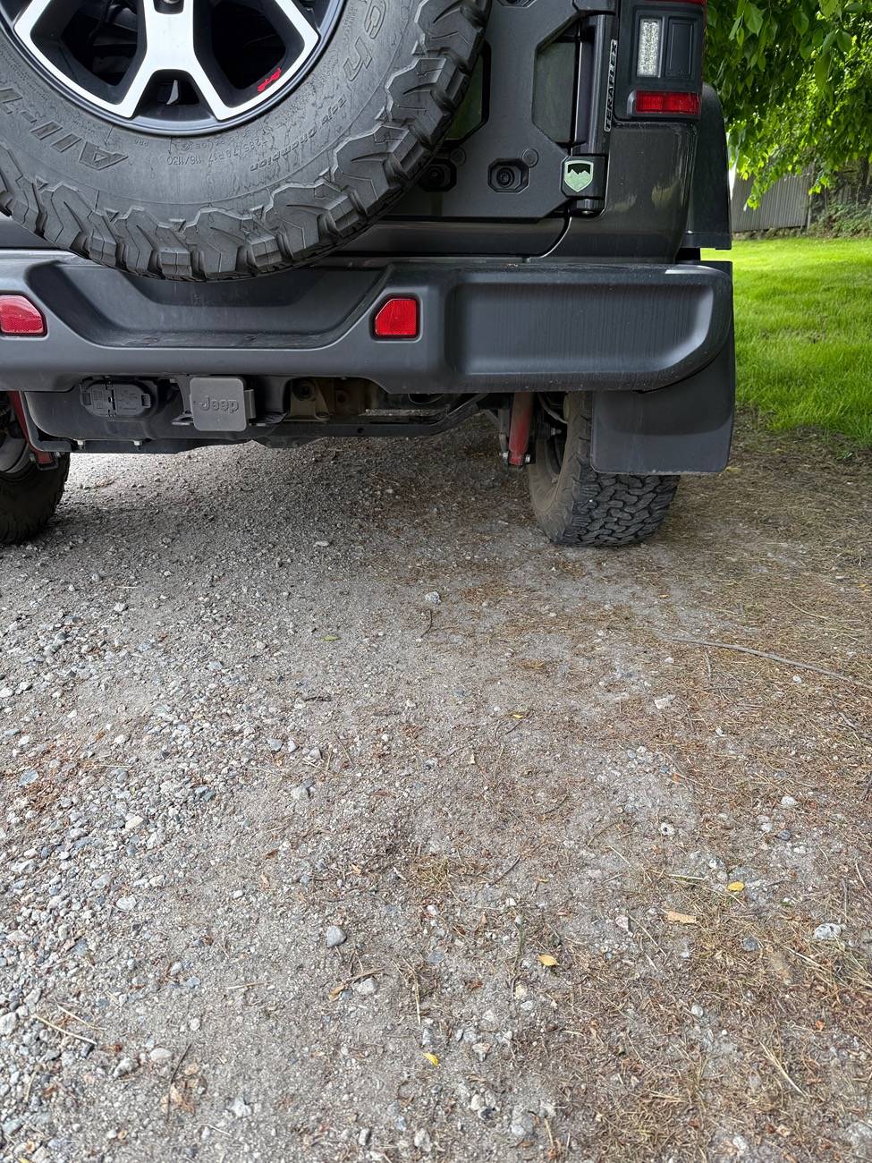

3.5hrs and they had me on the road
Jeep Wrangler JL EOC performance parts ltd IMG_4904
Jeep Wrangler JL EOC performance parts ltd IMG_4905
Turbo back exhaust, 50hp tune, and transmission tune. Quite a difference! I went with the resonator, glad I did.
Also saw I have 3 leaking shocks. Luckily, I happen to be going to a place tomorrow to deal with that….
