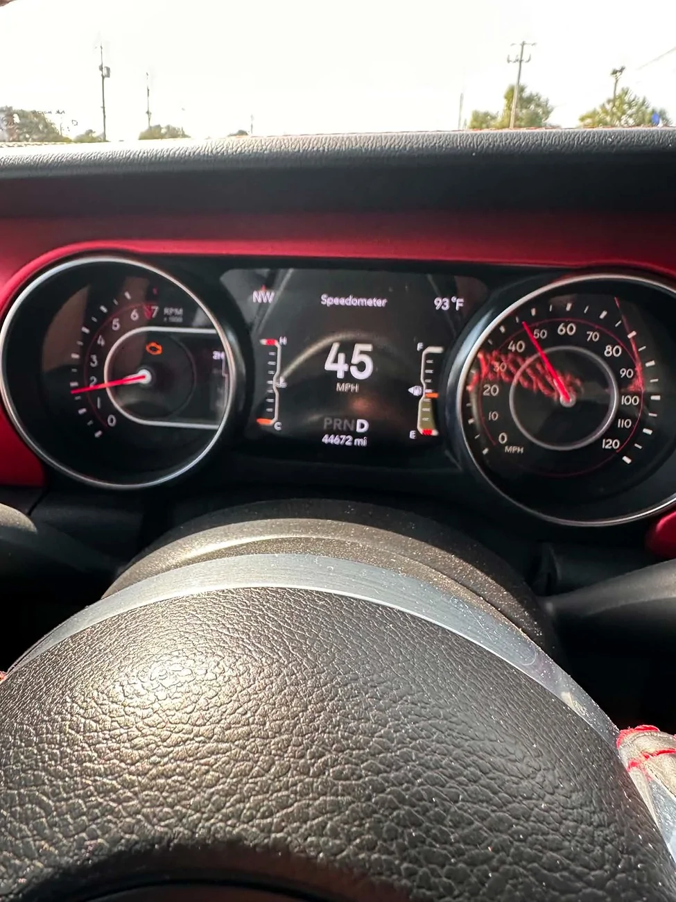

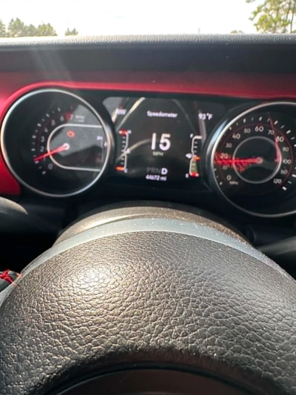

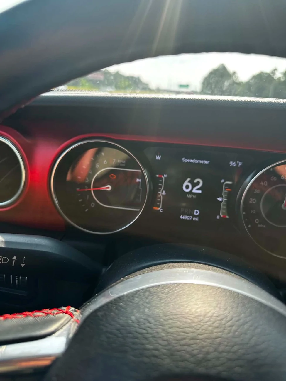

Thanks, Going to look at that. I ;m posting a few pics here of the check engine light on and the temp control hasn't budged on the dash. This is me driving after about 15-30minutes.

Yeah. You need a sensor or have wiring issue to the sensor. But high codes like that are almost always the sensor. Even if your thermostat was stuck wide open you’d have more coolant temp than that.

The fact that your analog temp gauge remained at dead-cold after operating the vehicle clearly indicates a failed temp sensor and/or wiring, as the previous poster said. That temp gauge should have been a third to halfway up to H.
How is your coolant level? I am concerned that you have also smelled coolant, which indicates a leak and/or an overheated state.
