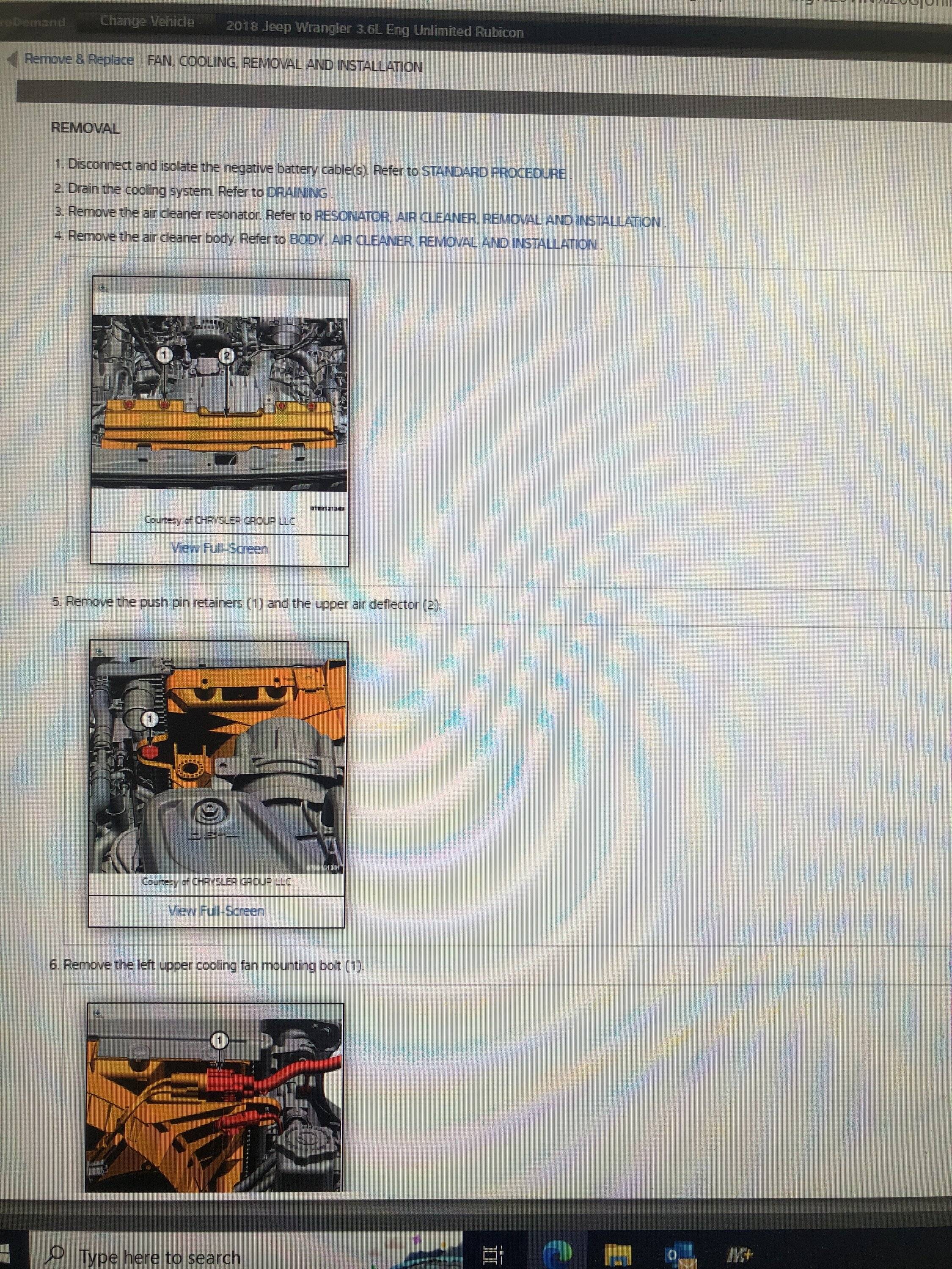

I haven't found any videos online describing the process, but I assume I can pull it from below without removing the radiator?

No you pull it from the top and is the first thing you have to remove to get to the radiator.

Thanks alot. I did see a video on a 2015 that looked similar.

Got it replaced, no issues. Wish everything was as easy. Thanks.
