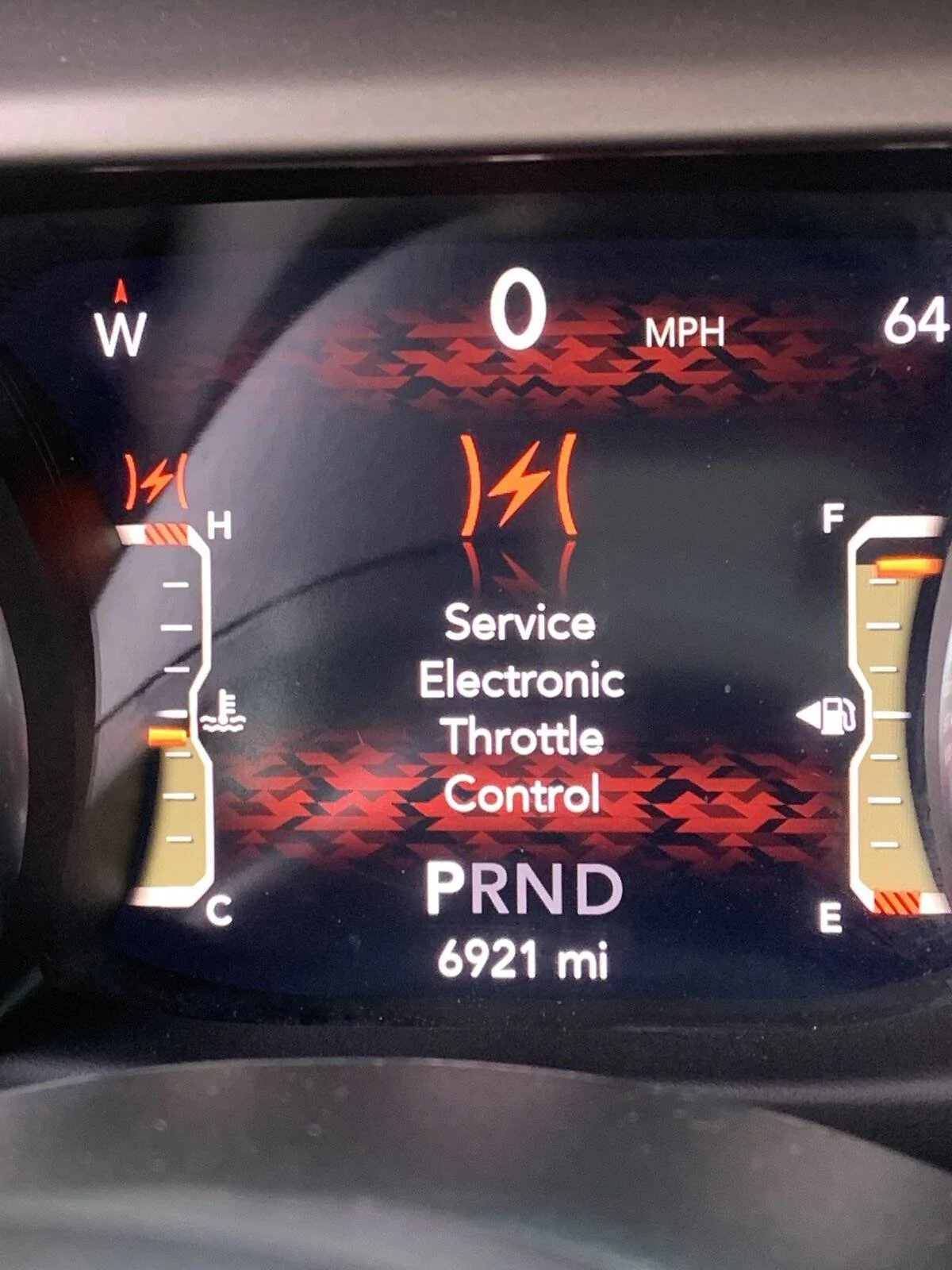

I too now have the dreaded ETC issue. I'm taking it in tomorrow. What a joke, I haven't even had this rig for a year and it was at the dealership for a month for the steering issue and now this.

Did you get this fixed? What was the issue? I have mine at the dealer right now for the same issue. They don’t have a real answer but are suggesting I pay for a Mopar tune to calibrate the tire size to help correct and clear the computer, which doesn’t sound right.

Im at approx 10k miles and same issue. Electronic Throttle Control flashing back and forth with the speedometer, check engine, and engine stuttering. We tried to reset it by removing power from battery and restarting it. It idled just fine for about 15 minutes but as soon as I got back on the road again, lost power. Now its been towed to the dealer and they are so backed up they arent even sure when they will get to it.

No resolution from the dealer on my end. Basically cleared codes and kept running. Still ongoing problem and expect to be back at the dealer soon.

I heard from the dealer last night, they said that there was a piece of foam packaging material left on mine during the build. It mustve finally caused the failure. They were shocked and are sending pictures to Jeep. They will clean it up and clear codes today, Im hoping thats the end of my issues. I hope you are able to get your figured out as well.

I know this is old, but I'm experiencing this same problem with my 2021 JLURD. Where was this " foam packing material"? Was it a shorted wire?
