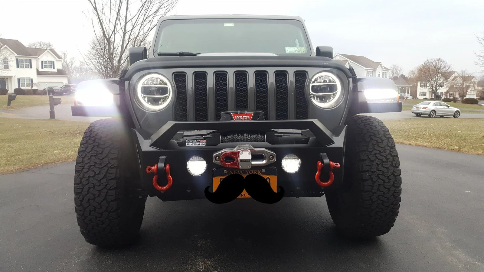

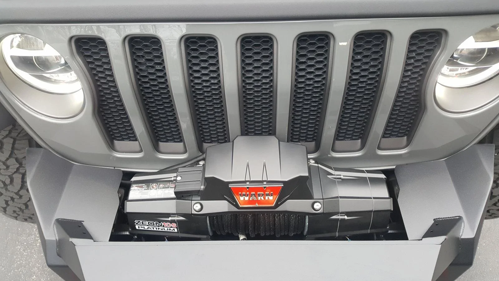

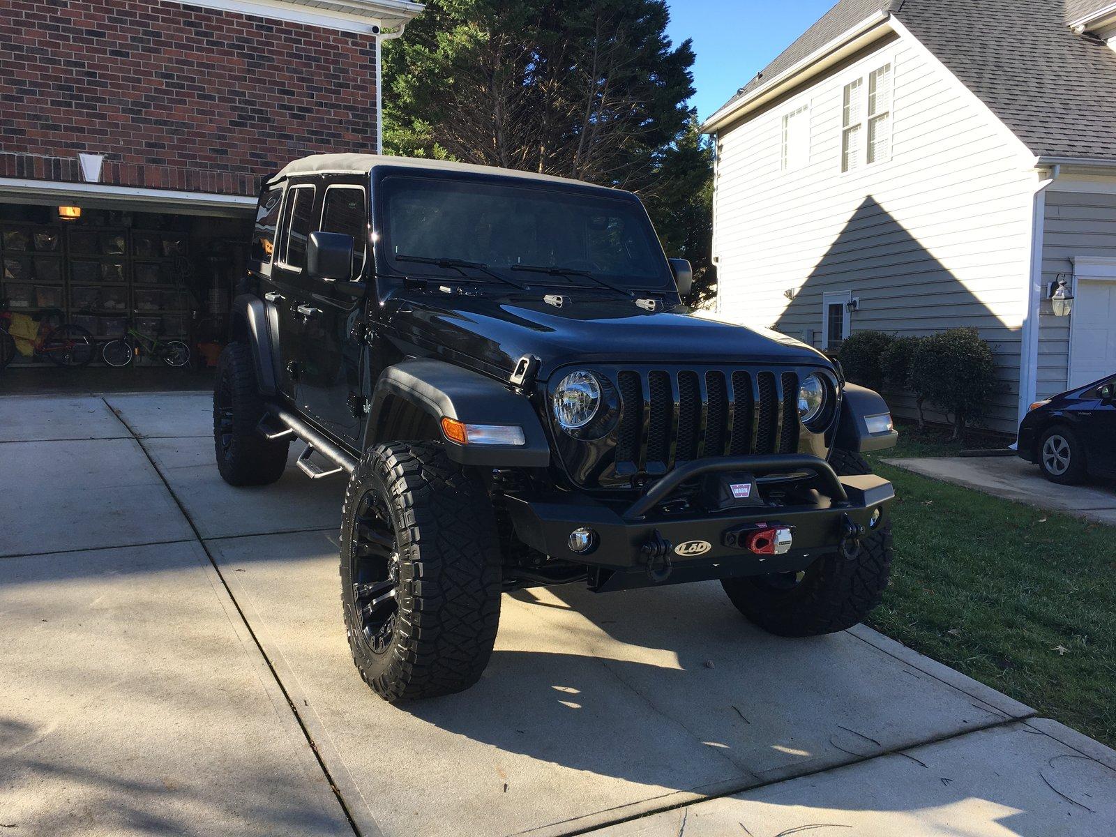

Any more pics on your rig? Nice but not cheap!I recently went with an ICI Magnum RT front bumper for my 18 JLUR. After researching for weeks, this bumper had all the features I wanted- integrates factory LED fog lights, winch ready, bull bar that has mounting holes for LED light bar, and skid plate included. The only mod required was to drill out the four led mounting tabs on each LED light to accommodate the larger included mounting hardware. I installed a Warn Zeon 10S Platinum on it and it dropped right in and lined up perfectly. All bolts were easily accessed and no frame cutting required!!

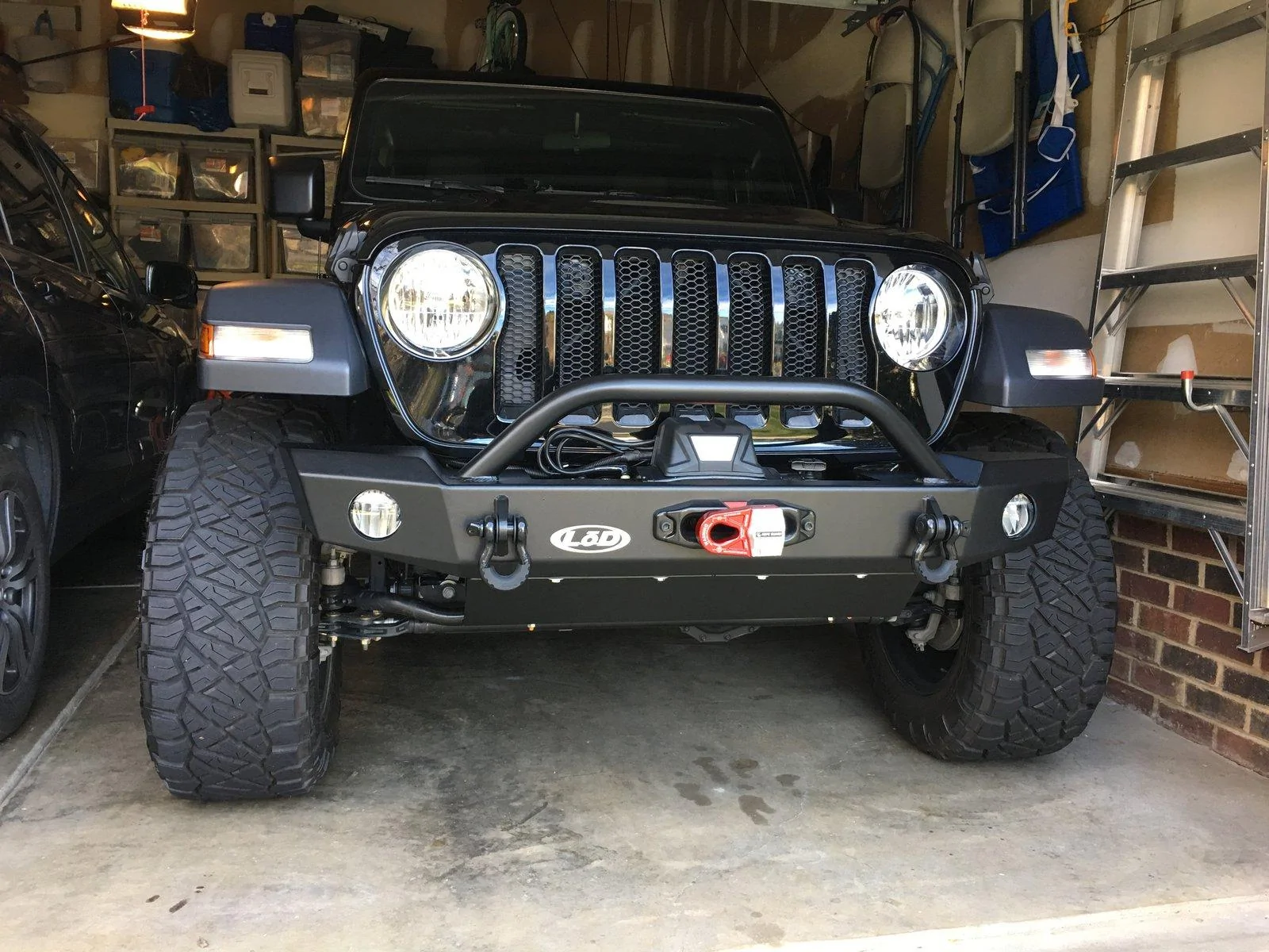

I would highly recommend this bumper. Took a total of 2 hours to unmount the factory plastic bumper and then install the ICI. Hardest part was fishing out the LED fog light wiring harness out of the factory bumper!
I was surprised you don't hear much about this company and took a chance. I liked the front so much that I also ordered the rear to match. Probably do that install next week.
