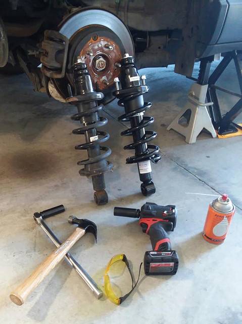

In all instances, it's been money very well spent. Yes, more than twice have I used hand tools, etc. to avoid a dealer visit, or perform enough advance DIY work to reduce the cost of any visit to the Svc Dept. that may need to occur.
E.g., I was quoted $900.00 to replace two struts on Offspring's Honda. I purchased the parts and did it myself for <$300.00.
P.S. -- Peace be upon the name of Aero-Kroil.
