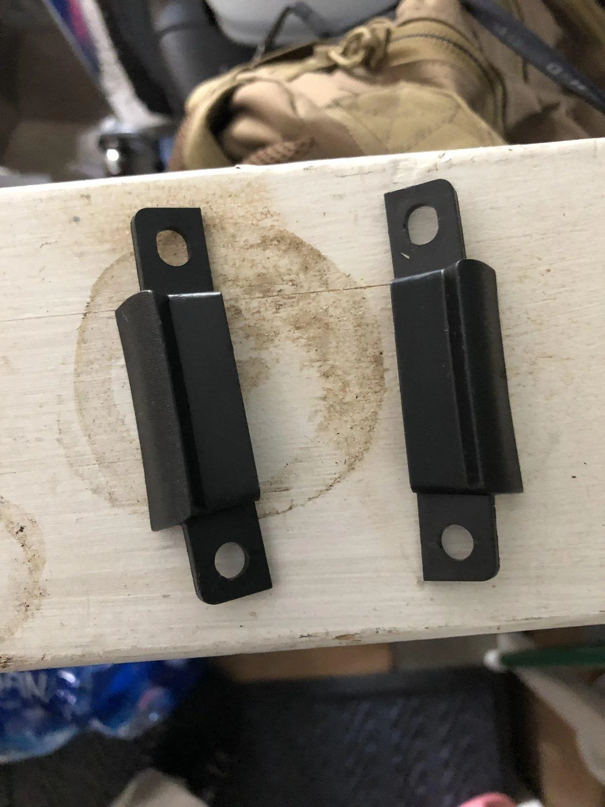

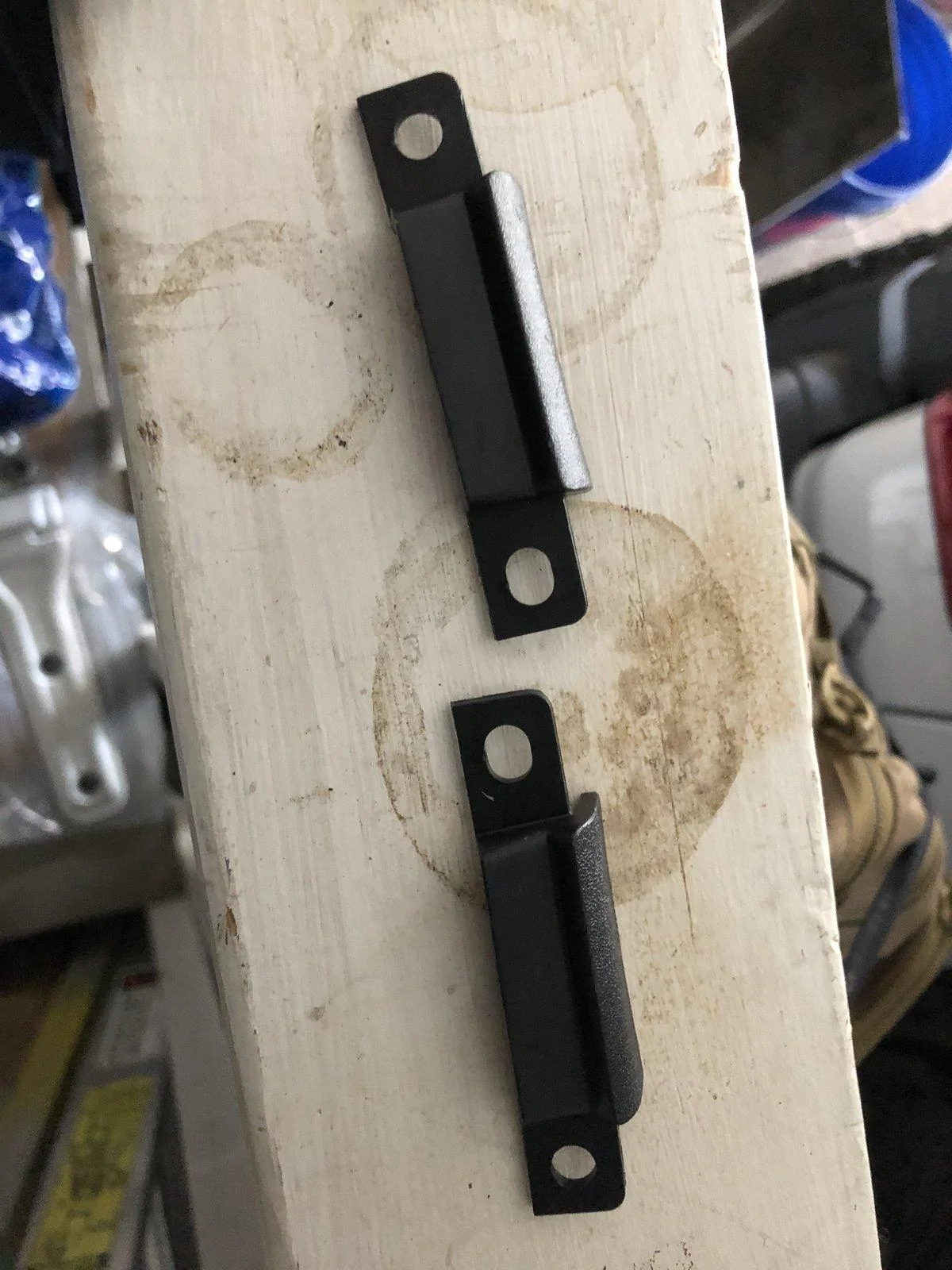

I bought a 2018 JLU Premium soft top on CL for $550 for my 2019. It fit like a glove. the seller stated the "wife" didn't care for the wind noise.
Anyways. I've been trying to figure out where these two pieces go. They were in the bag with the various smaller parts. I didn't see it on the parts list and watched all the install videos. I'm thinking it didn't belong to the top or the seller had taking them off which didn't need to be taken off. There were four loose screws also. Thanks.

They are trim pieces overhead at the top of the windshield. That are removed when you install the metal brackets for the hard top. If you have those brackets installed, you don't need them.
Thanks. I can't find the location you're referring to. My hardtop came off with just the bolts in the rear and sound bar. I don't see any metal brackets on top of the windshield. It does not leak or make funny noises, so I'll leave them off. Thanks again.

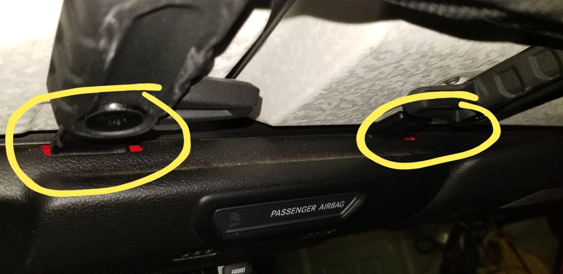

They go here. They are only installed on Jeeps that did not come with the hard top.
Odd yes those are for the latches, but mine came as hard top only and had those installed.. just went and checked my window sticker and it was NOT dual top optioned from factory. Lol I was gonna pissed if dealer sold as an spare to someone.
@digitalbliss Sorry re read your comment you said came without a hardtop.:facepalm:
