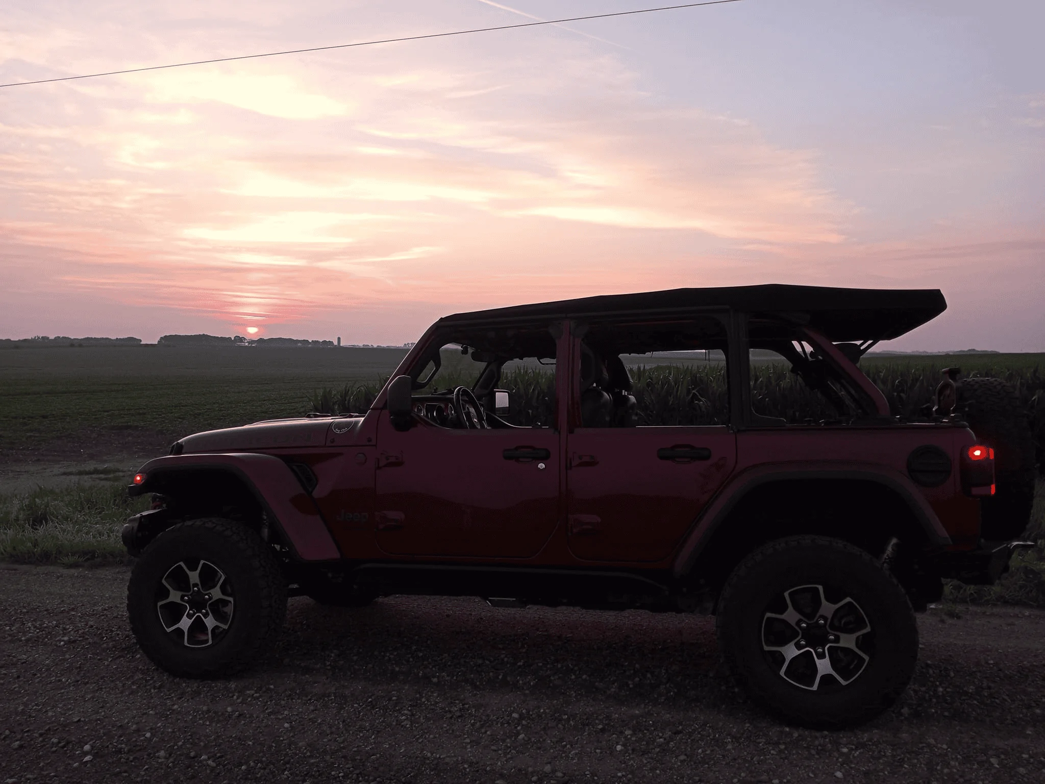

I swap mine only twice a year unless on a long trip and I need the security of the full doors/windows. Very easy but no shortcuts that I am aware of aside from not screwing in the hinge bolts. FWIW, I do use mine.
