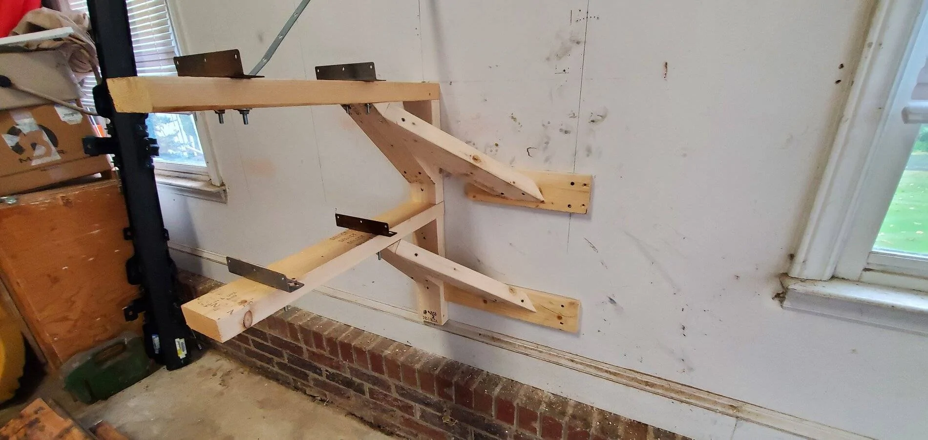

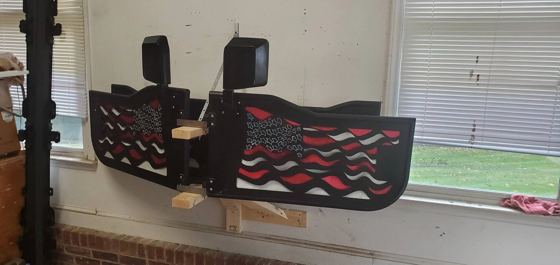

Built me some door hangers using what scraps I had on hand. 2x4s, waterbed corner brackets and some 3" screws, and metal strapping. The old waterbed brackets were very strong and had holes in the right locations to insert the door pins. I just hope when its quits raining and I take the factory doors off to test fit all works well.
