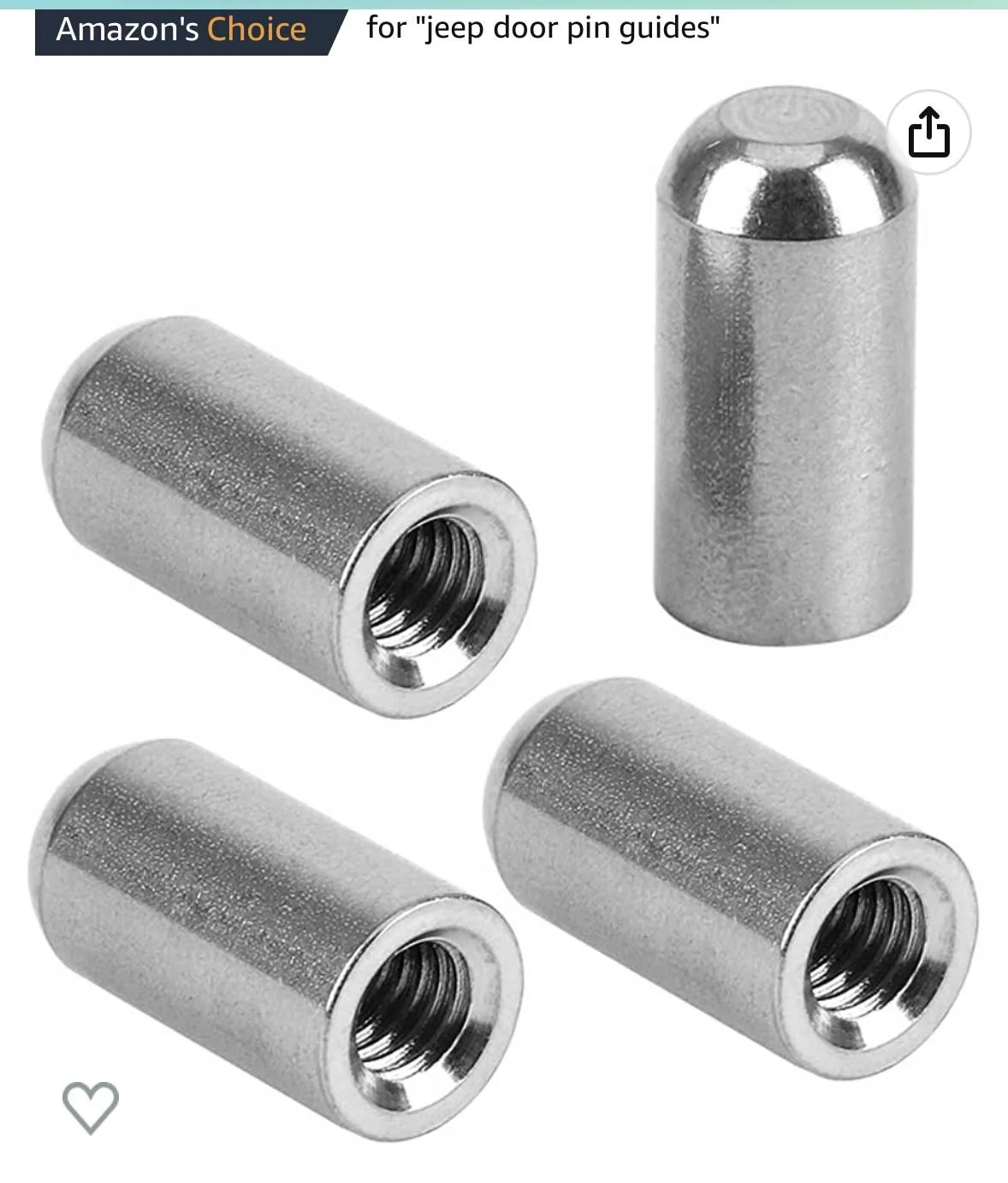

I picked up some of those bullet shaped nuts that help with installation and just left it at that.

Yeah, when I swap my doors for tube doors in June I'm planning to replace the bolts with the silver bullets instead.

Then do something like these. I’m in northeast and have run something similar on last few rigs. Anti seize on the pin threads and a little grease and be good forever.
