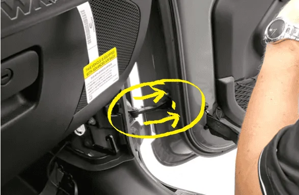

Finally got to take my doors off for the first time and had an issue when putting back on. The door guide (picture is stock, not mine) traveled too deep inside the door. I can pull it out somewhat but not enough to reach where it needs to be to mount with that last bolt. I assume that housing has an area where the arm can go in and out depending on wether the door is open or not. My guess is that after I unscrewed the bolt, I closed the door partially and pushed the arm in at a weird angle too deep. Should I just grab a set of pliers and pull with pull force?

Thank you, and I learned a new word, detent.
