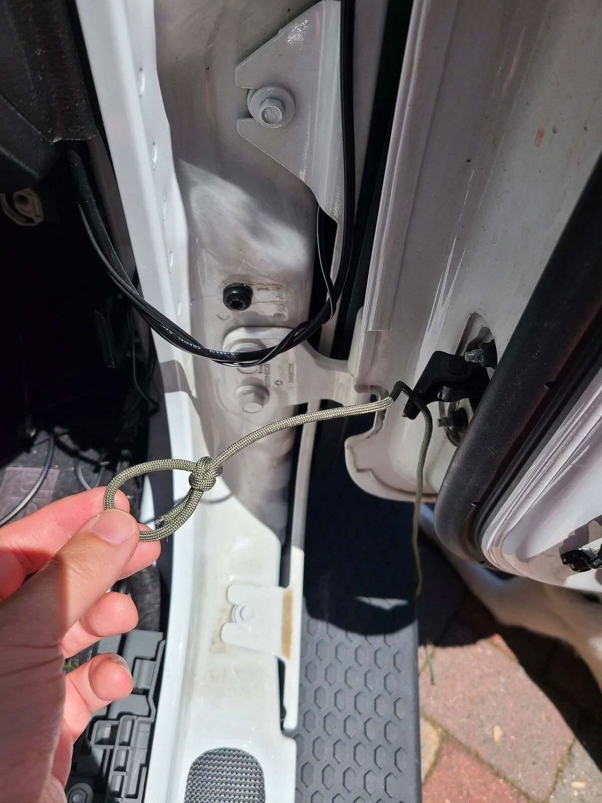

Take a cord and put it through the detent bolt-hole, then tie a loop at the end:

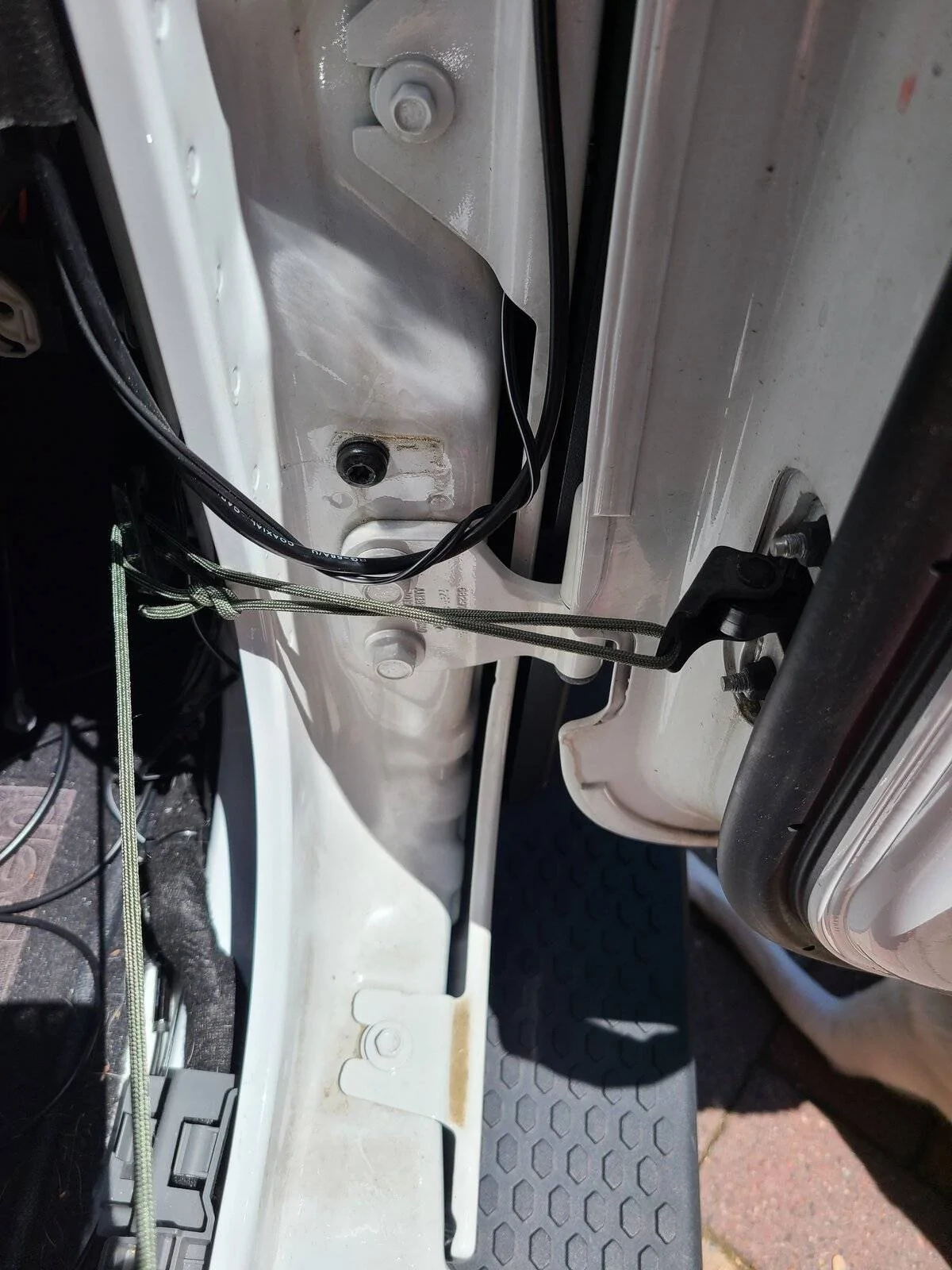

Put the loop over the hook that the door check attaches to, then loop the free end around it as well:

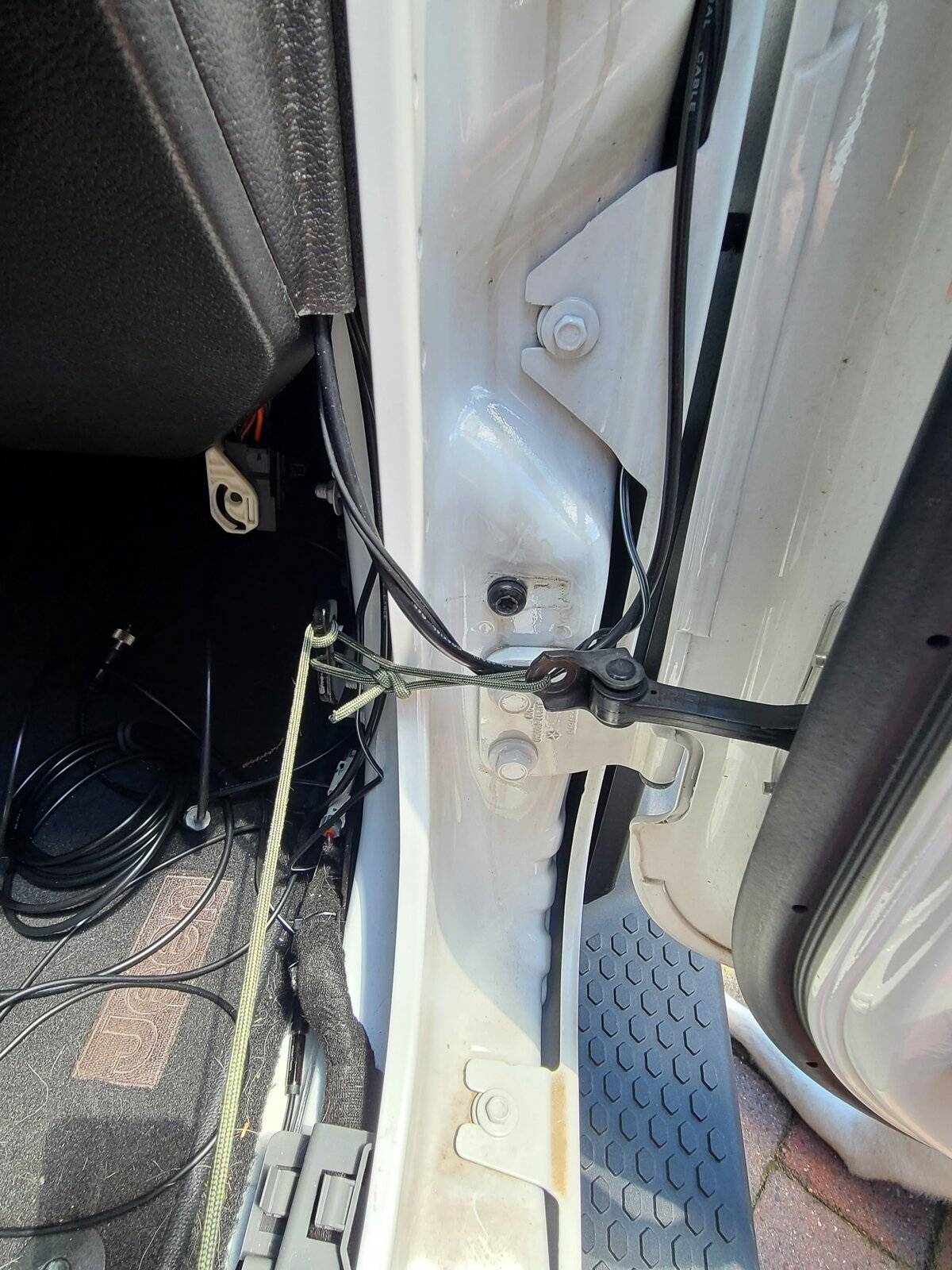

Close the door upon yourself as much as possible, pulling in the slack on the cord, then loop the free end once or twice more around the hook:

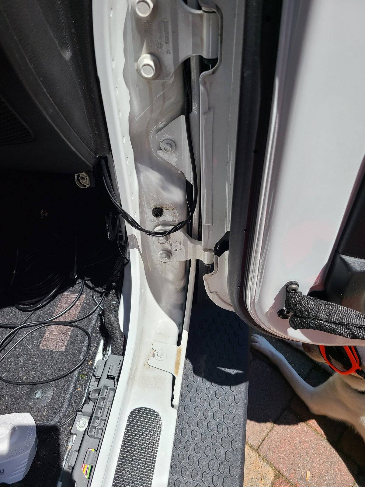

Push the door all the way open while holding fast onto the free end of the cord, and the detent will kachunk back out as you do it:
If it doesn't pop all the way out the first time, close the door, pull in the slack, and do it again.
