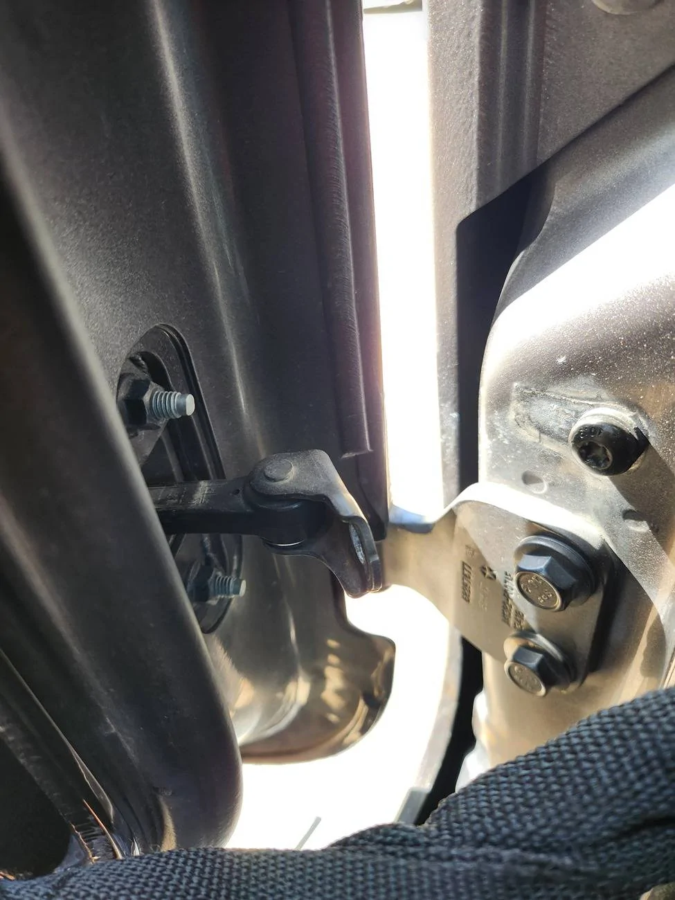

Hi,
Sorry for the noob question. I took my driver door off since the weather is nice and the arm thingy is stuck in and wont come out. What can I do to fix this? There are 2 nuts i can take off, would that allow me to fix?
Thanks for any advice

Close the door enough to put the cab side screw Back through it then open the door.
Pape
Jul 4, 2023
1,906
2,032
Quebec
JLU Sahara
since you are half way out try to screw it in place and than just open the door to pull it out.
They are really stiff. Alternatively you can use a wire / cord and as a extension to attach it tp the screw and open the door. All in all the door is your leverage :)
