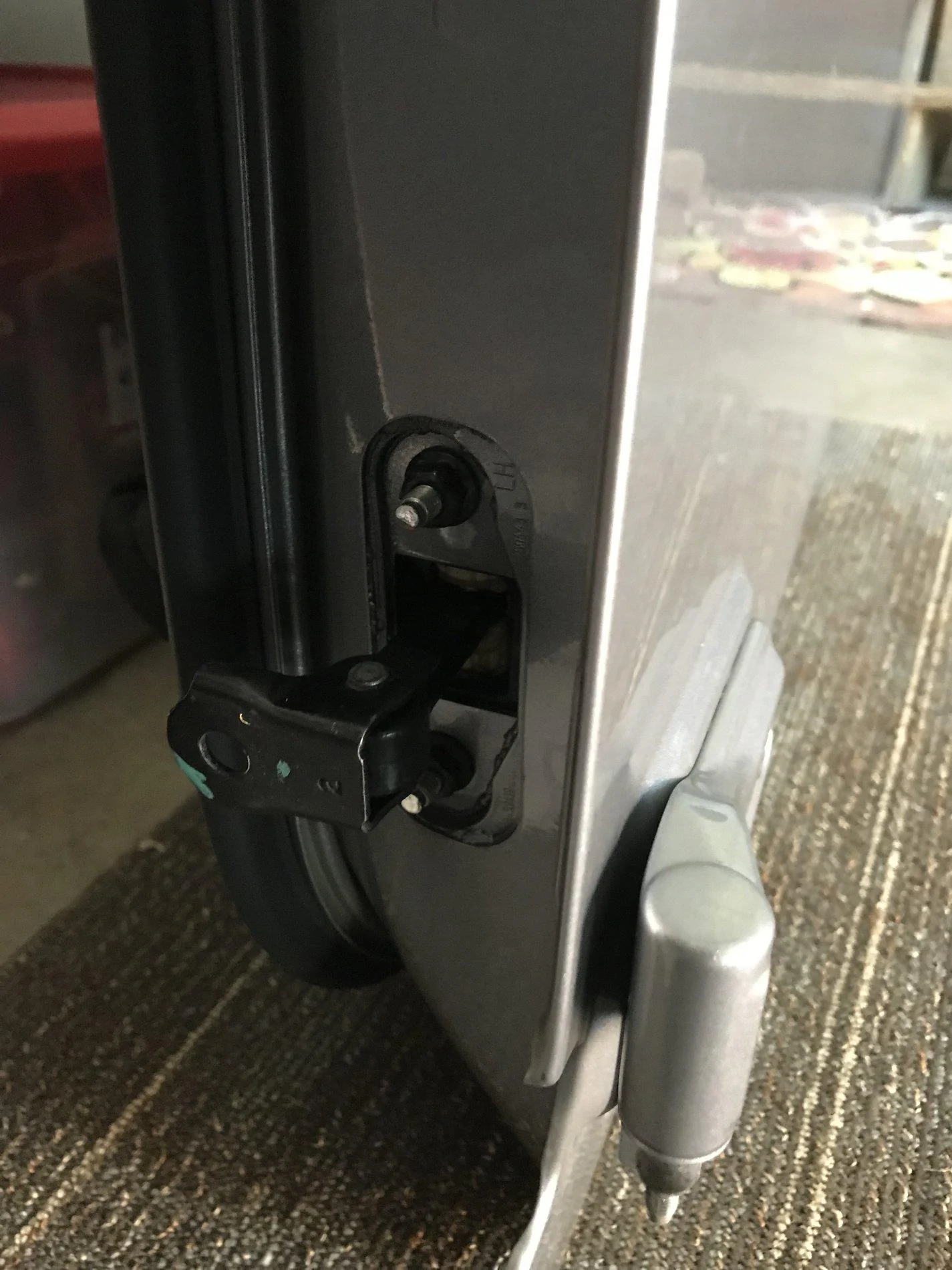

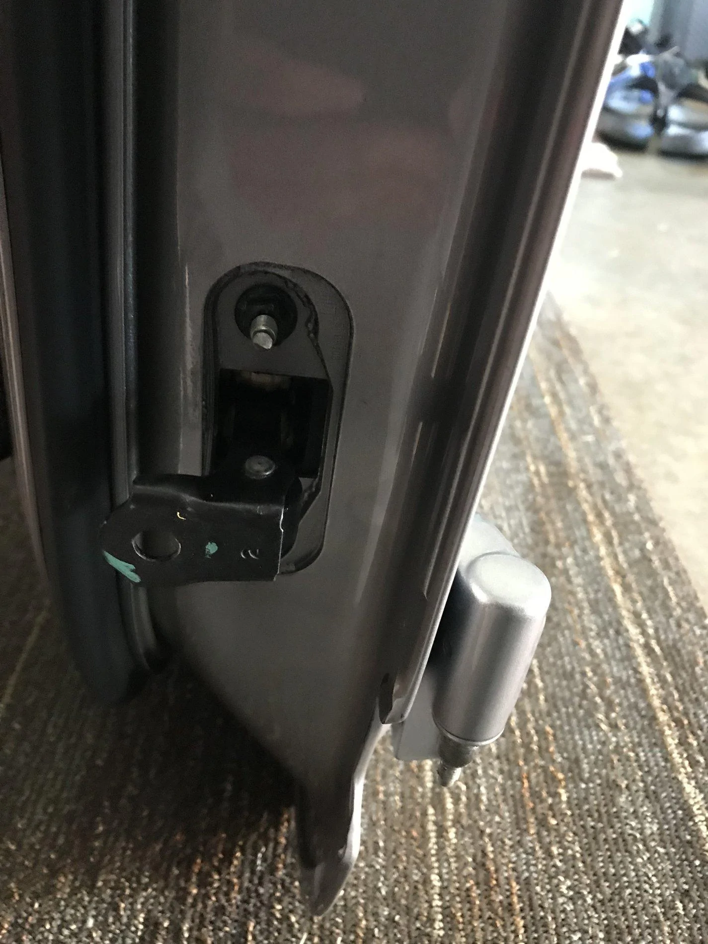

I deliberately popped my door check strap inside the door to be able to easily take the doors off during summer. To get the door check straps back out, I did the following by taking a shoe lace wrapped through the door check strap bolt hole, around the metal hook for the wiring harness check strap, and over a wrench handle. Hold the shoe lace tight and stationary with the wrench handle. Then, push the door open to the first detent. (I used my foot). At the first detent, there is enough room to get the stock door check strap bolt into the hole in the door jam.

I just pull it straight out with Vice grips. Put a rag on tighten it up.and pull it right out.

Vice grips didn't work for me....but a long (12'') straight slotted screwdriver (inserted through the door check bolt hole and in to the bolt hole on the body of the jeep.....the leverage of the screwdriver and closing the door popped the door check right out).
I assume you meant "and opening the door popped the door check... ". Otherwise I'm confused. Their needs to be a tool to pull this sucker back out!
My bad, yes opening the door.
Thanks you saved my day. I used a coord, tied a nut on the door check hole and wrapped the other end of the coord around my arm and pulled hard at the same time I pushed with my foot. popped right out.
