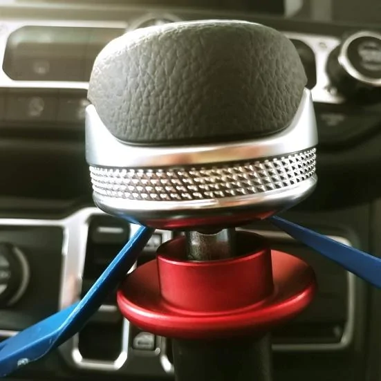

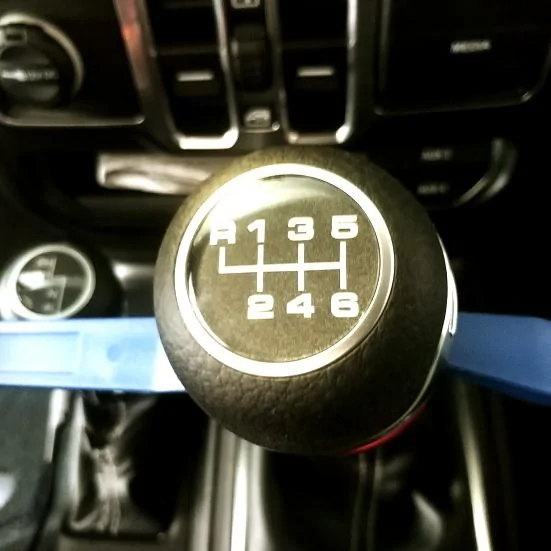

The OEM knob "justs" pop off, but for me, it took a stubby hammer, a couple of pry tools, a curse-word, and a few beads of sweat.
I used (Harbor Freight) automotive trim removal tools on either side of the knob to get it started. Work them under the knob (use a hammer and tap, tap, tap, not whack, whack, whack), and get the knob to move upwards.

The second photo is a bit misleading, the knob is actually already removed, and the pry tools don't look like exactly like that...the photo is to better show placement where you can work the tools under the knob.
Just like what the service manual reads, you give the knob a sharp jerk upwards. I pulled a few times on the knob and pry tools with both hands, and it finally came flying off. I made sure to pay attention to where the spring landed. Luckily, the plastic spacer that goes between the spring and shaft of the shifter didn't go anywhere, so I didn't have to go looking for it.

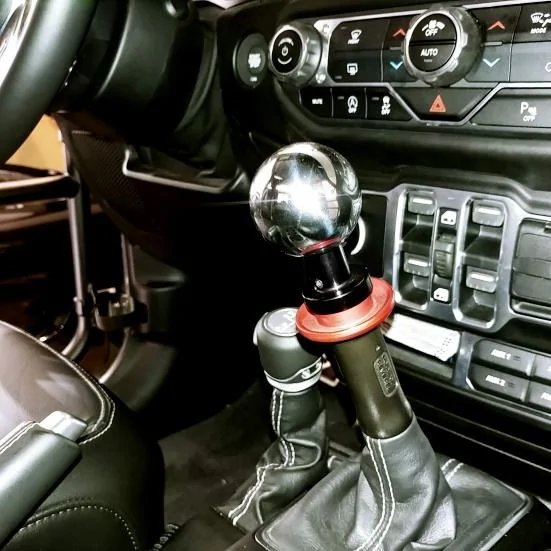

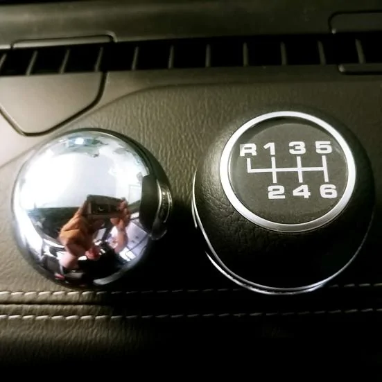

The 16-ounce (450 grams) polished Twisted Shifterz knob is a little smaller and more ergonomically shaped, but I'm sure it'll slip more easily from my hands on mitten-mornings.

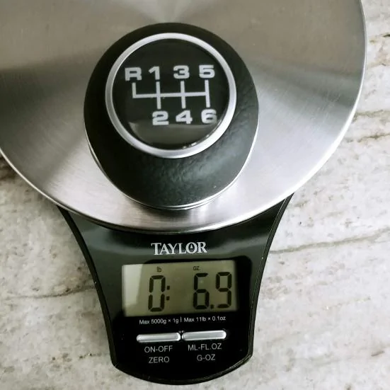

I was pleasantly surprised by the heft of the OEM knob, almost 7 ounces or 200 grams.
I kept getting images of Destro in my head looking at the replacement. I may have spent too much time in front of the TV in the 80s watching G.I. Joe cartoons.

I changed the manual trans knob on my last 2DR (2003 TJ) and I still have the Hurst knob I used back then. I've already pried off the knob with a t-shirt, for which I'll post a video, but I'm wondering how Twisted Shifterz set up that knob you bought to work on the stock shifter shaft. Of course you know it's not threaded, so I'm not sure what kind of adapter they sent you...
If you could give me a little insight that would be great.
Thanks a lot.
Jeepney Johnny
Rico!
Apr 8, 2020
339
625
2020 Jeep Wrangler Sahara
The only thing I got from Twisted Shifterz was a polished round knob and a jam nut. I used a Speed Dawg adapter with that knob. There's a couple of set screws on the front and back of the adapter used to secure it to the OEM shifter shaft. When installing the adapter, just pull up on the red collar, and make sure it can fully move before final set screw adjustments.
