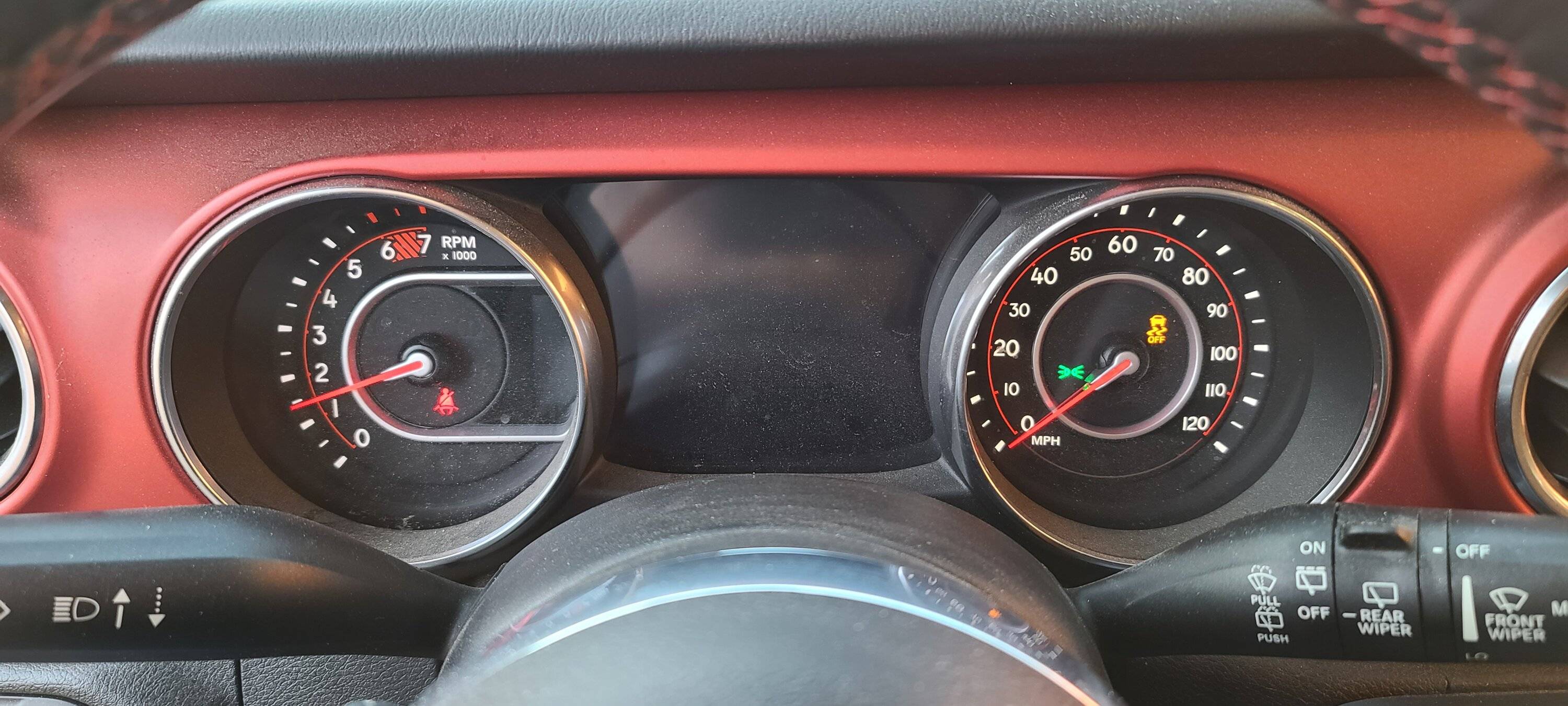

Ran out a couple nights back, and all was well, until I noticed the center screen went completely black on my way out of the neighborhood.
I still have turn signal indicators and the headlamp and foglamp indicators, but everything else is gone. The screen is still getting power, but it's looking just like a TV that's on but blacked out.
A bunch of related threads talk about either full replacement or of a software update. The extra kick in the pants, is the Tazer being married and that screen is needed to unmarry.
I wonder if I should just get another unit and install it myself. I just dont know if that can be done without the dealer software magic. I read about them being needed to relay the odometer reading over, but is there more to it?
Any help would be immensely appreciated!

I don't have a scanner. The tazer allows reading of codes, but I can't access its settings without the screen working.
I tried unplugging the tazer mini to see if that helped, but that wishful thinking didn't work. I now have both negative battery terminals disconnected, to force a system reboot, and will reconnect them at the end of the work day. Keeping my fingers crossed on that one.
Would a handheld obd scanner be able to determine if the screen needs to be replaced or not? If so, do you have any recommendations? I'm good with mechanical work, but have never had any need to delve into the computer end of things. Uploading pics to this forum was a big achievement for me, a couple years back. ?

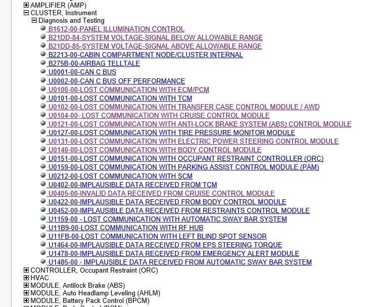

The diagnosis for the cluster in my service manual is lengthy and requires at least a code reader. If you want to pursue it yourself, I'd highly recommend you go to the Tech Authority site and purchase the Service Manual Products - Mopar Tech Authority

Mike,
Thank you very much for the link to that service manual. I'm so out of touch with computer stuff that I haven't even had a computer for the last several years. I'll have to dig into that site deeper, to see if a printed copy is available.
I use an online subscription version called AllDataDiy. If you have a tablet, that may be easier than the USB version.

Still a no-go after reconnecting the batteries. Did the IPC self diagnostic test a couple times, with same results...
Looks like I'm needing a new IPC? That's assuming the speedo needle should've also did a sweep?
