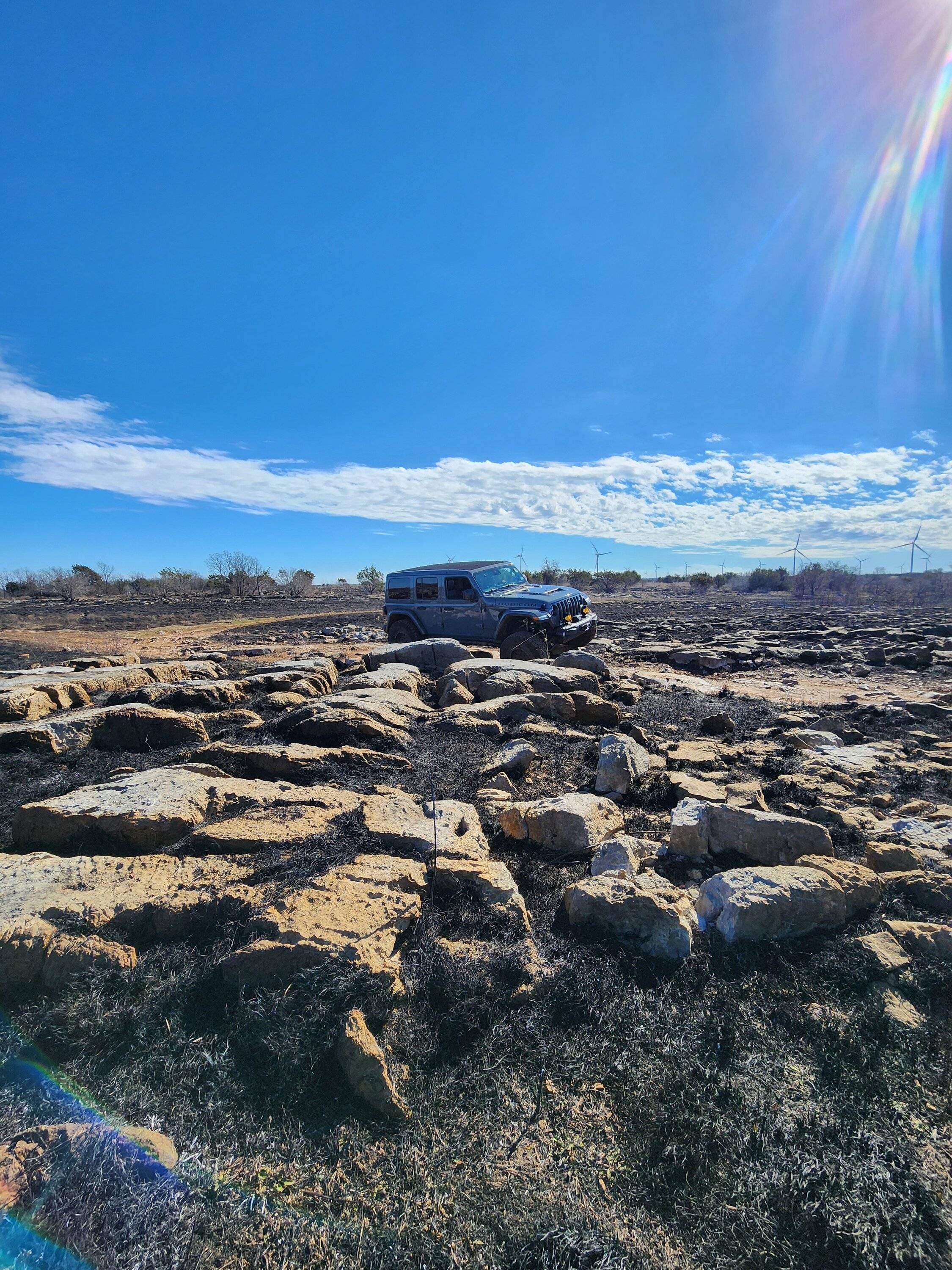

I run an engine/Trans skid and rear diff skid on both our Jeeps. I have had days where I was just doing easy trails and have dang near knocked my bottom off and then days like yesterday, where I was wheeling hard and never even scrapped anything the entire day.
