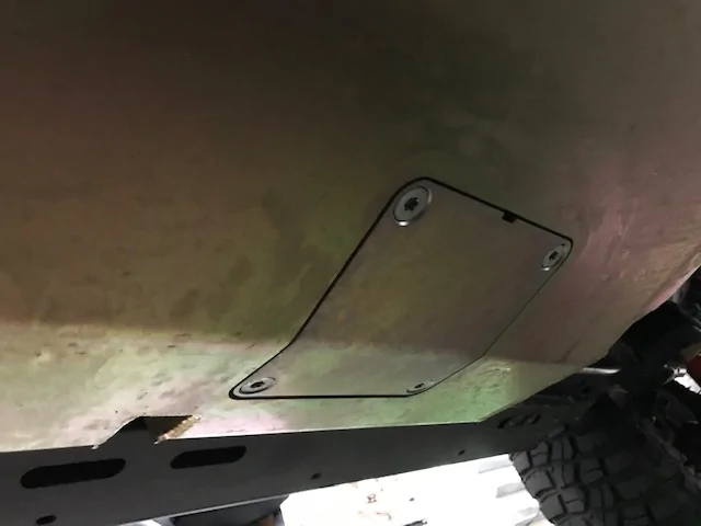

But I have the Metalcloak. There is a removable panel that gives you good access to the fuel filter. I've done one change so far and it's easy. They have you remove the wimpy stock skid during installation so it's just 4 bolts to remove the panel and the filter is right there.

as @grimmjeeper said: Drop this door on Metalcloak the wimpy stuff is gone. Pull the door before you take it in, that part would be a simple job with no mess.

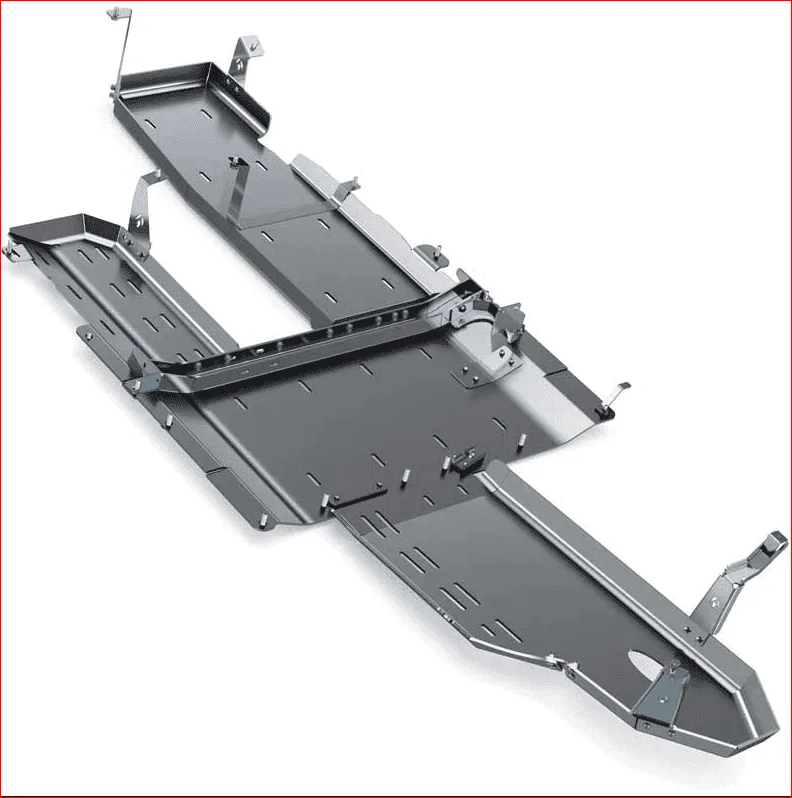

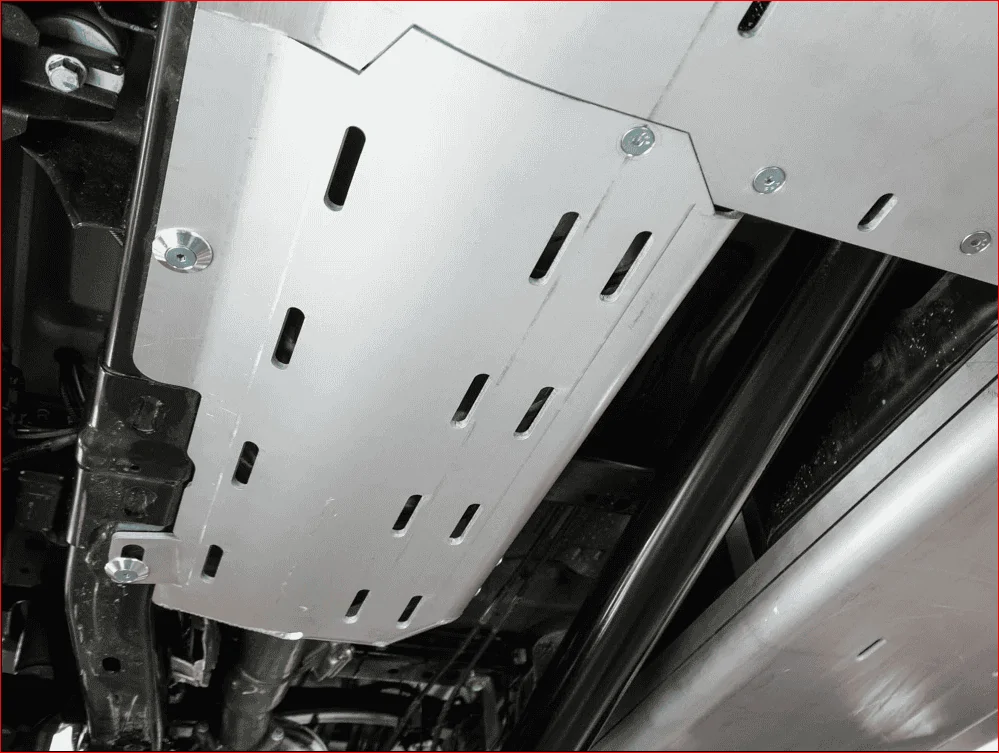

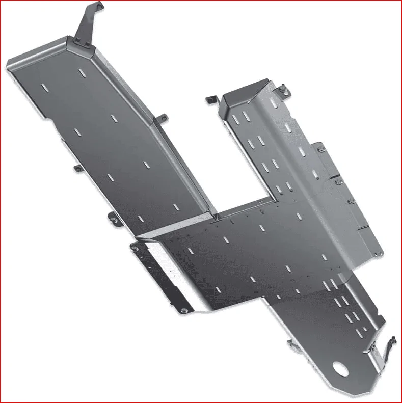

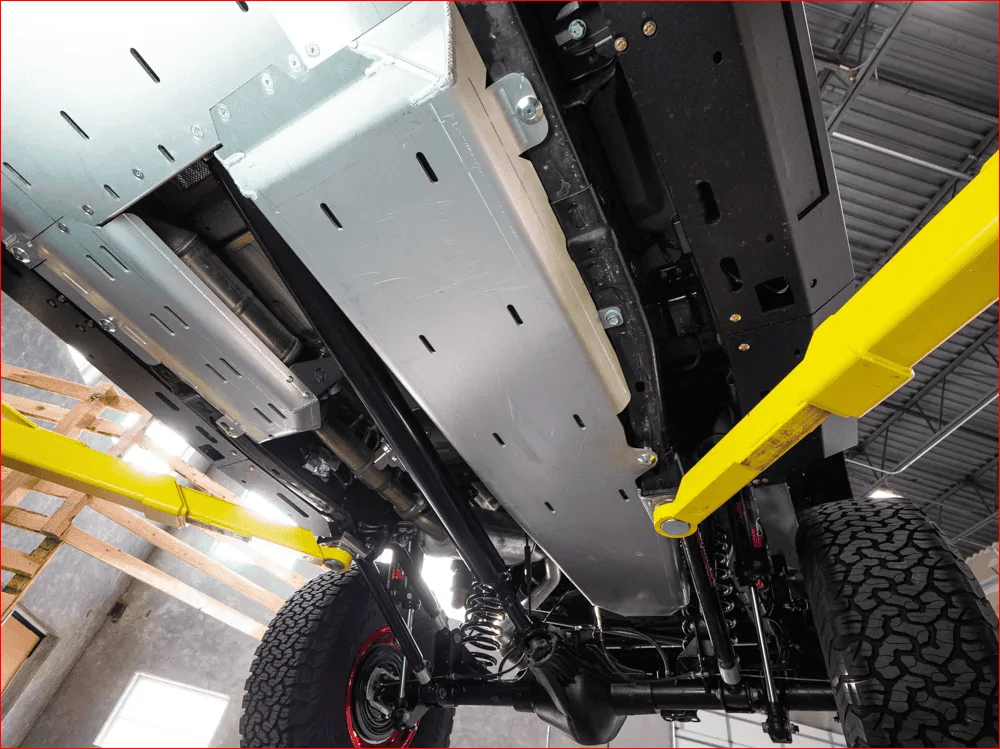

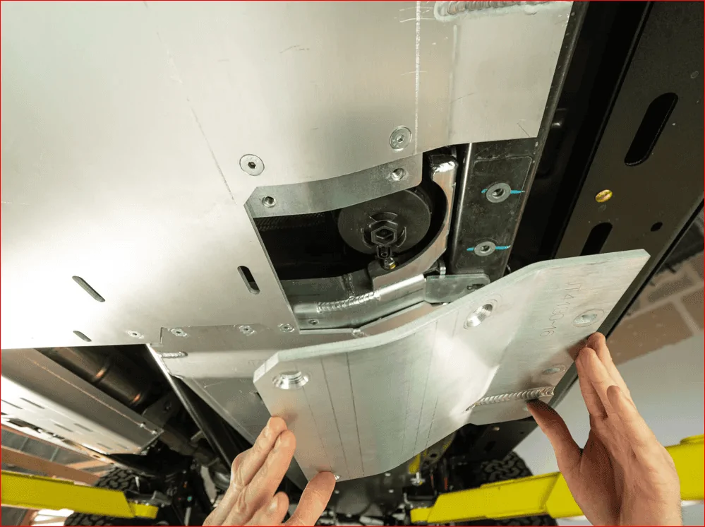

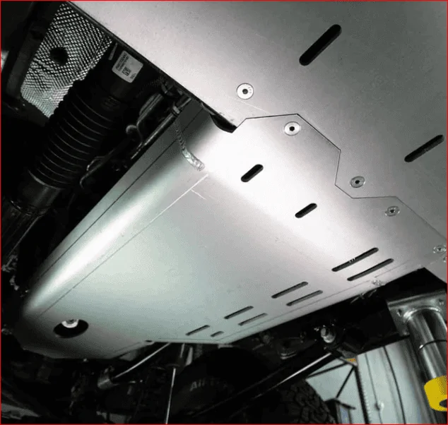

Have you considered the Artec Diesel bellypan ? Ours is made from 1/4" 6061 aluminum with 3/16 Zinc plated steel bracketry an has Stainless counter sunk hardware so no rust to worry about . Transitions between panels are very tight and virtually seamless so nothing to hang up on. It has a panel to remove to access the fuel filter and water separator. Once you remove the oem skids our kit will only gain about 50lbs total weight on the diesel while adding way more coverage . It's on sale for 15% off with free shipping currently

Slick looking skid plates. Does that 50 pounds include the DEF skid?

I did consider Artec, that is until I saw the price when combined with the DEF skid, although I think I prefer it to MetalCloaks offering. Plus it is currently on Backorder from the looks of it.
