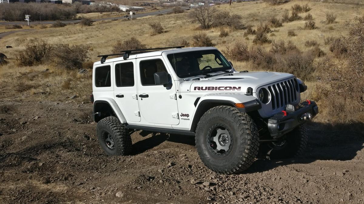

I installed the MC 2.5 GC on my diesel the weekend before Xmas. Rocksport shocks. No rub anywhere yet but I did break off the front axle e-locker connector the first day out.With your experience, do you recommend getting the MC 3.5 GC lift for the diesel?
I ended up with ~2.25" lift in front and ~2.75" in rear. Back of Jeep was squatting a little I think on the stock springs with the extra 41 lbs of tire/wheel hanging a little further back thank stock.

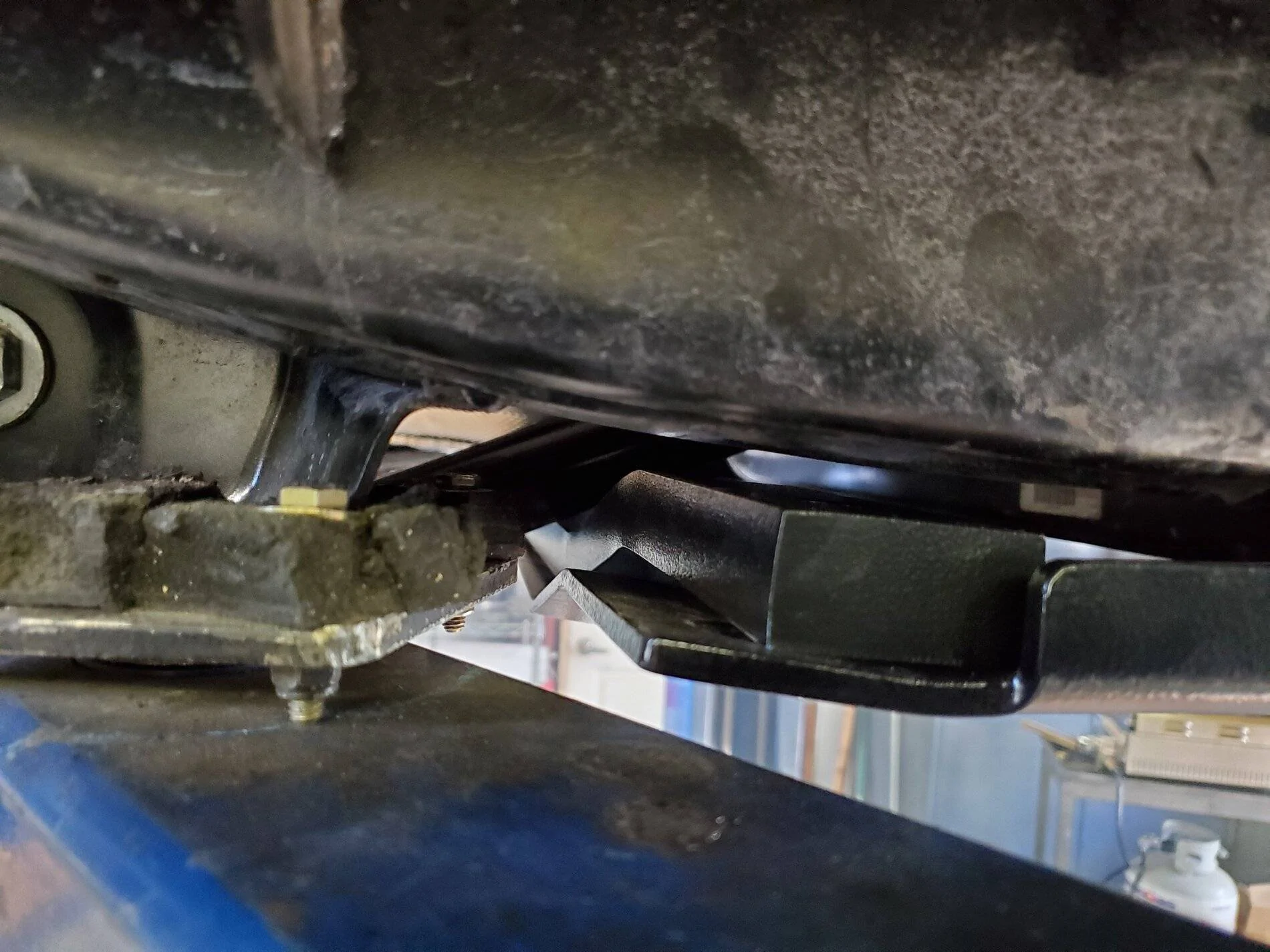

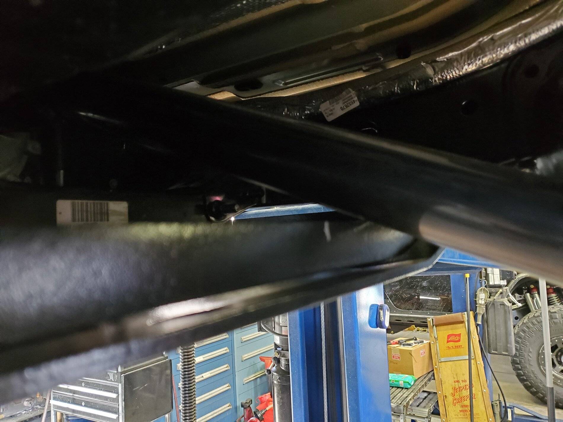

I get over 20 inches of wheel travel at the front. Plenty of room for MC front driveshaft with factory cross members. Hoping there will be plenty with Artec's system too.
