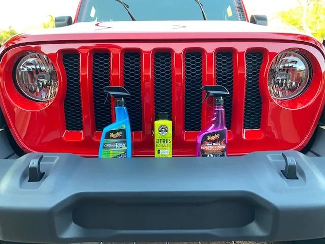

Thank you for sharing your product experience. For my wash, I use Chemical Guys Wash & Gloss. After the wash, I will use a clay bar to give it that smooth feel. I just started to use Meguires Hybrid Ceramic Wax. I was very impressed on how it turned out. For the my tires, I use Mequires Hot Rims Wheel & Tire Cleaner. Always nice to keep your Rig Shiny!

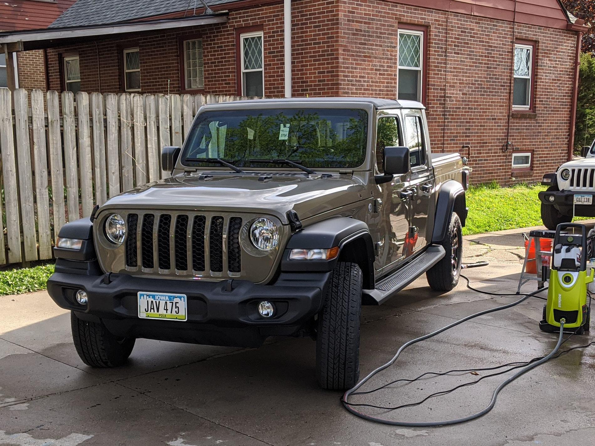

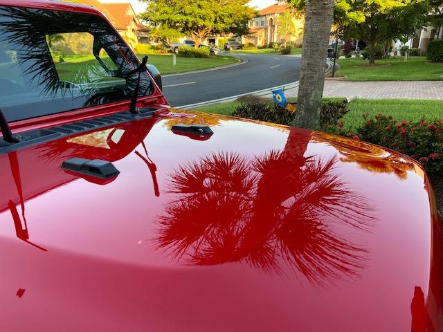

I just tried the Mequires Hybrid Ceramic Wax this weekend. I'm no expert, but I can say I've never had as much shine for as little effort and cost. I recommend watching some videos before you use it for the first time, here's the best one I found
Here's what around $4 worth of product does with no more effort than washing, spraying and wiping dry.

I just tried the Mequires Hybrid Ceramic Wax this weekend. I'm no expert, but I can say I've never had as much shine for as little effort and cost. I recommend watching some videos before you use it for the first time, here's the best on I found
So if I interpreted that video correctly.. you wash the Jeep, then spray the application and then dry off for the initial coat? Can this be applied, dry on a clean vehicle?
My take from the video is that water helps with the application, but I saw some videos with dry application. I'll probably just follow the manufacturers guidelines.

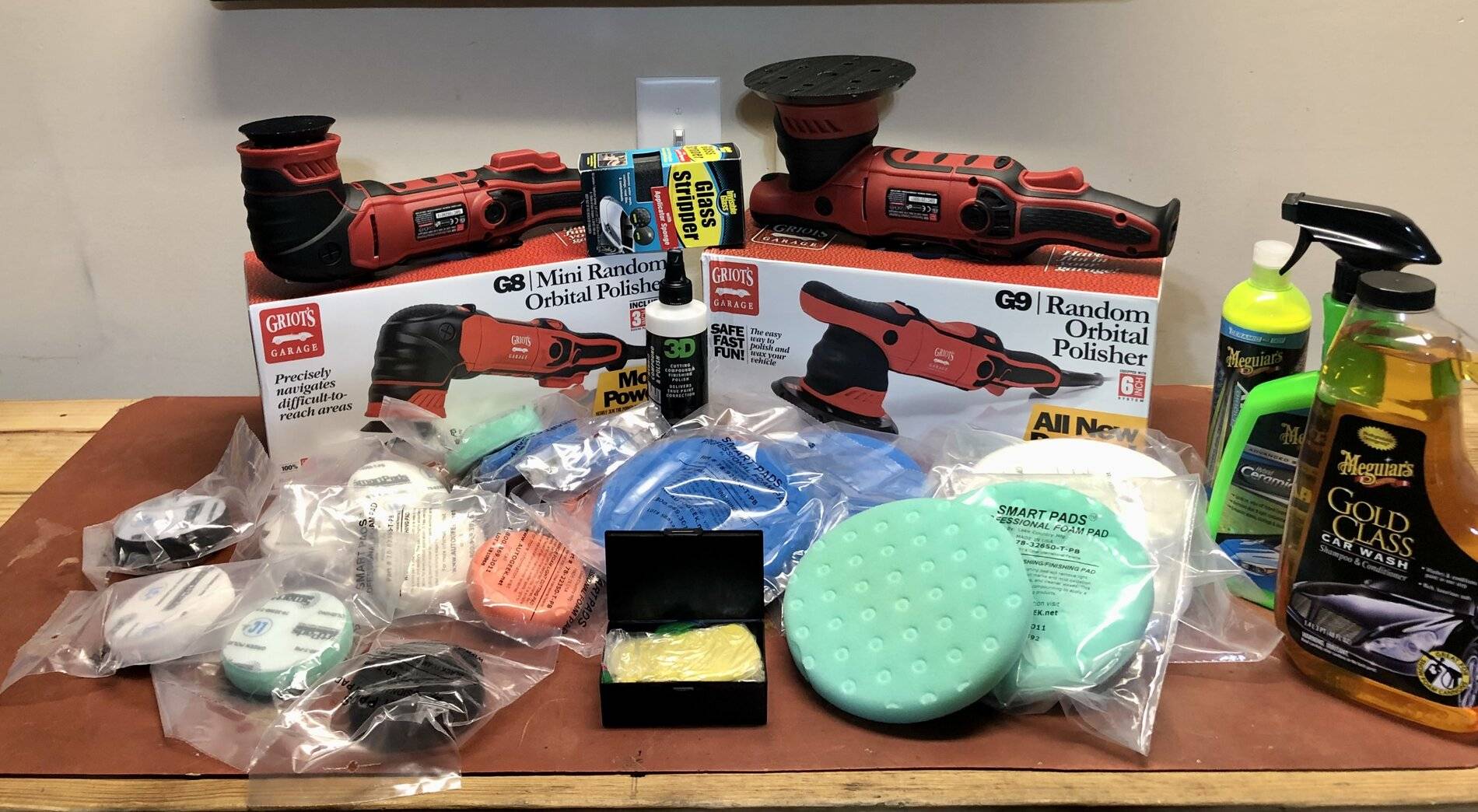

I’m getting ready to start paint correction this coming Monday, the hood is the worst but not as bad as some I have seen

Looks like you robbed a detailing store. You sure you got everything? I think you missed something? I don't see Q-Tips! ?️‍♂?

Basically the same package I used to do mine, the G8/G9 combo with lake country ccs pads. I at first tried the standard combo of m105/m205, with terrible results. Just left micro scratches everywhere so I tried some m210, with green and white ccs pads, that is supposed to help in those situations. Well it didn't. In the end I used the 1 step "correcting cream" from griots that came with the polisher bundle, with the orange ccs pads, and it turned out really nice.
Followed it up with Gtechniq CSL and then 2 coats of EXO V4. Pretty stellar results but I'm pretty rough on our jeep and the hydrophobics have gone away already on alot of the jeep. Mud and rocks can be pretty harsh on coatings. I'm just going to use the 3 in 1 ceramic spray from griots that came with the kit just to boost the hydrophobics.

The Qtips may be in here ?

My plan is to use 3D One as it’s a diminishing polish from doing research so sort of a one step but it’s controlled by what pad you use, I will do a test spot using a white pad and if that does not give me the results I need I will step it up to an orange pad and then go down, after that correction is done I will do a wipe down using Megs 34 over an then apply 3D Poxy as my sealant then use the Megs Hybrid SiO2 wax and my LSP will be the the Megs Hybrid SiO2 detailer and keep up with that for testing

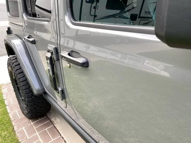

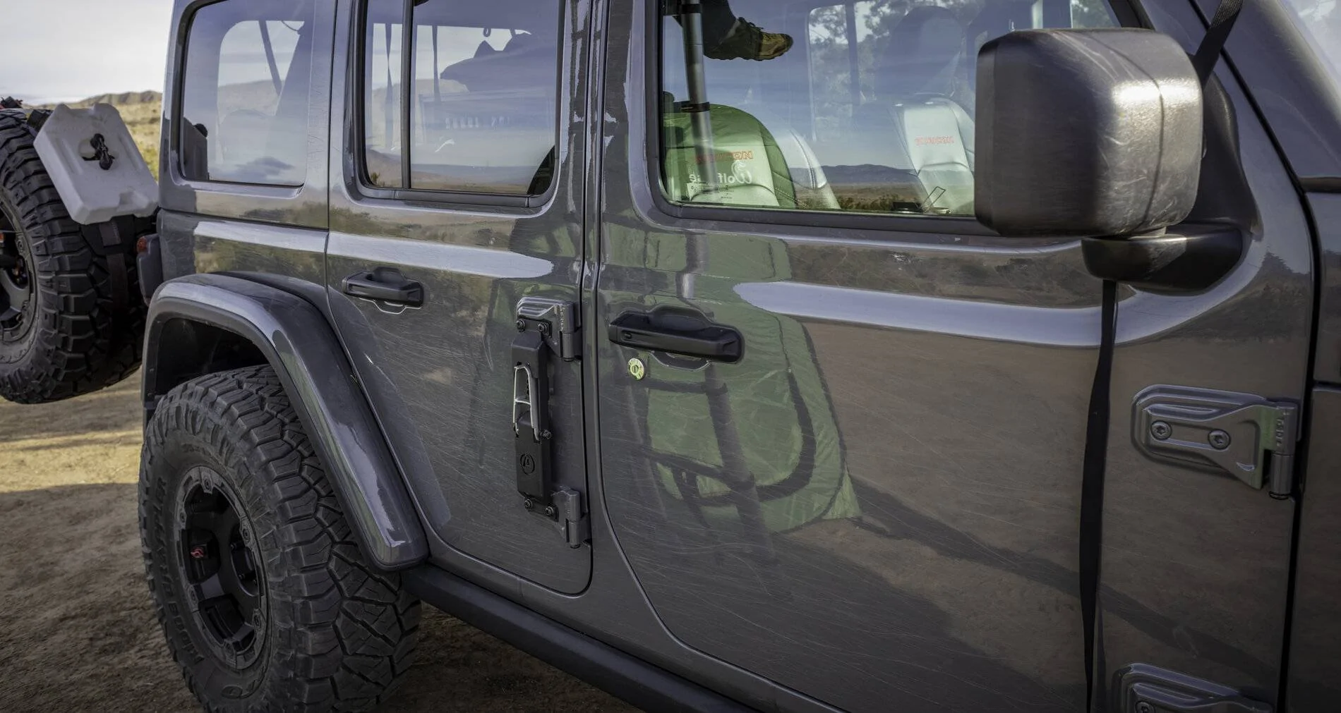

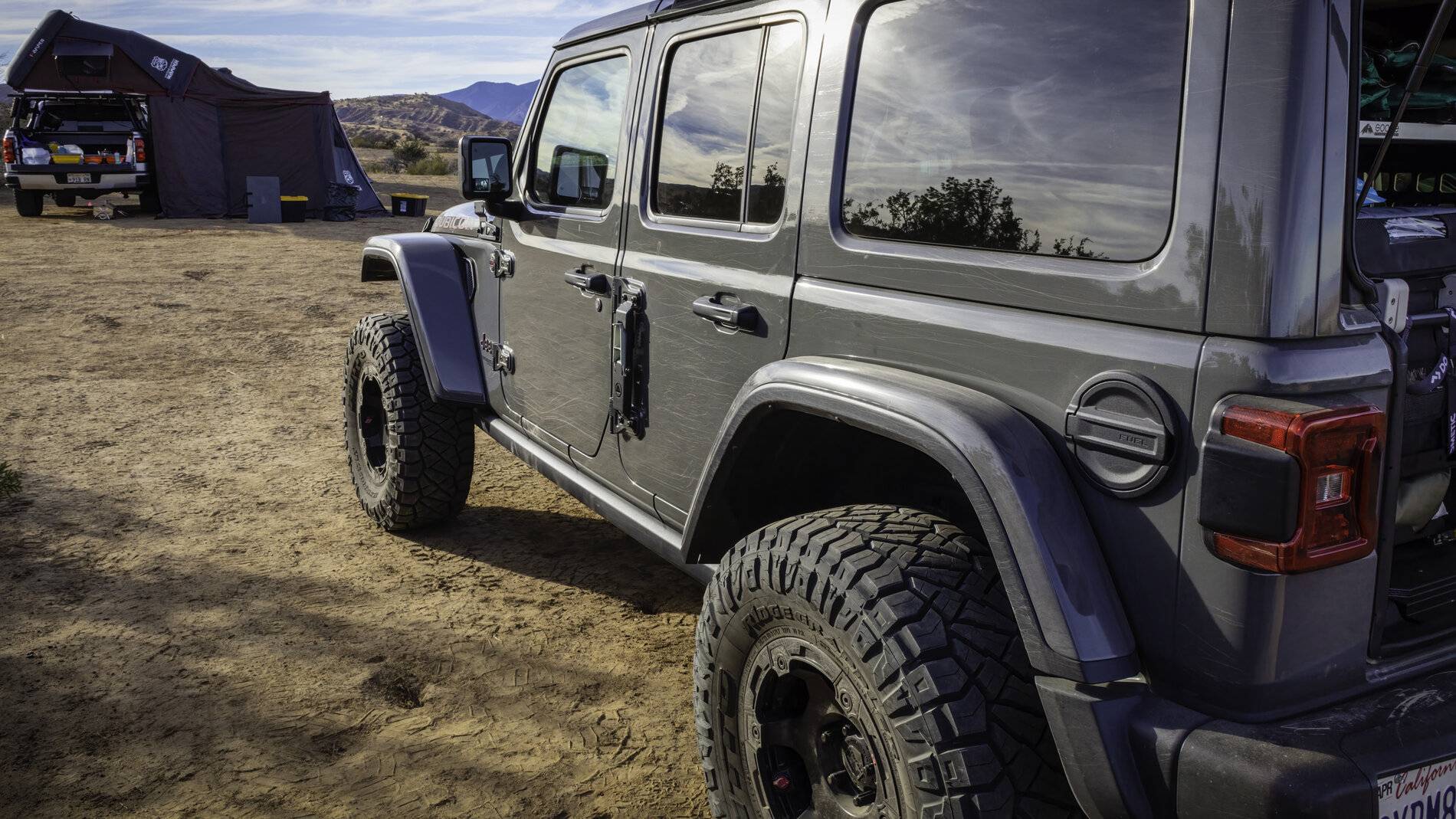

For those new to all this I thought I would share my experience. I scratched the crap out of my jeep in Bollinger Canyon.
Here's what it looked like after we got back:
Jeep Wrangler JL Detailing!!!!! JEEP-25
Jeep Wrangler JL Detailing!!!!! JEEP-26
It's hard to take good pictures where the scratches show up as much as they do looking at them. Mostly superficial, sap (I guess), some deep scratches.

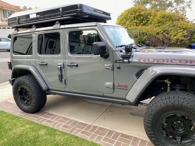

After researching many of the suggestions made in this thread I spent about four hours washing, cleaning the tires, and applying the Turtle Wax ICE.
Jeep Wrangler JL Detailing!!!!! IMG_3397
Jeep Wrangler JL Detailing!!!!! image1
Jeep Wrangler JL Detailing!!!!! image2
Washing it got rid of a lot of what appeared to be scratches but was sticky sap(?) filled with dirt, after drying applied the TurtleWax ICE. It worked surprisingly well but I'm skeptical that something this easy to use and made such a difference tha after it dries for a couple of days the scratches will magically return.

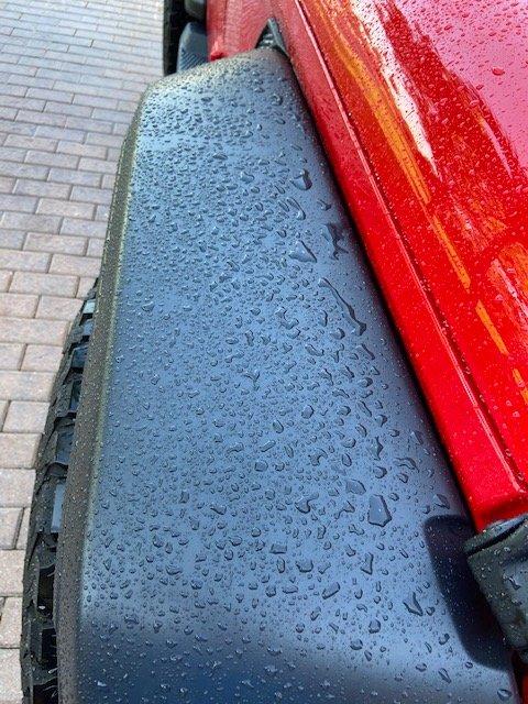

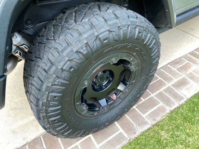

I also used TurtleWax Tire and Wheel cleaner which isn't a tire dressing, it just cleans the tire. I initially wanted to use Tuf Shine, I liked how it removed previous tire dressings. I used this product the same way and it pretty much accomplished the same thing. I hate shiny tires.
