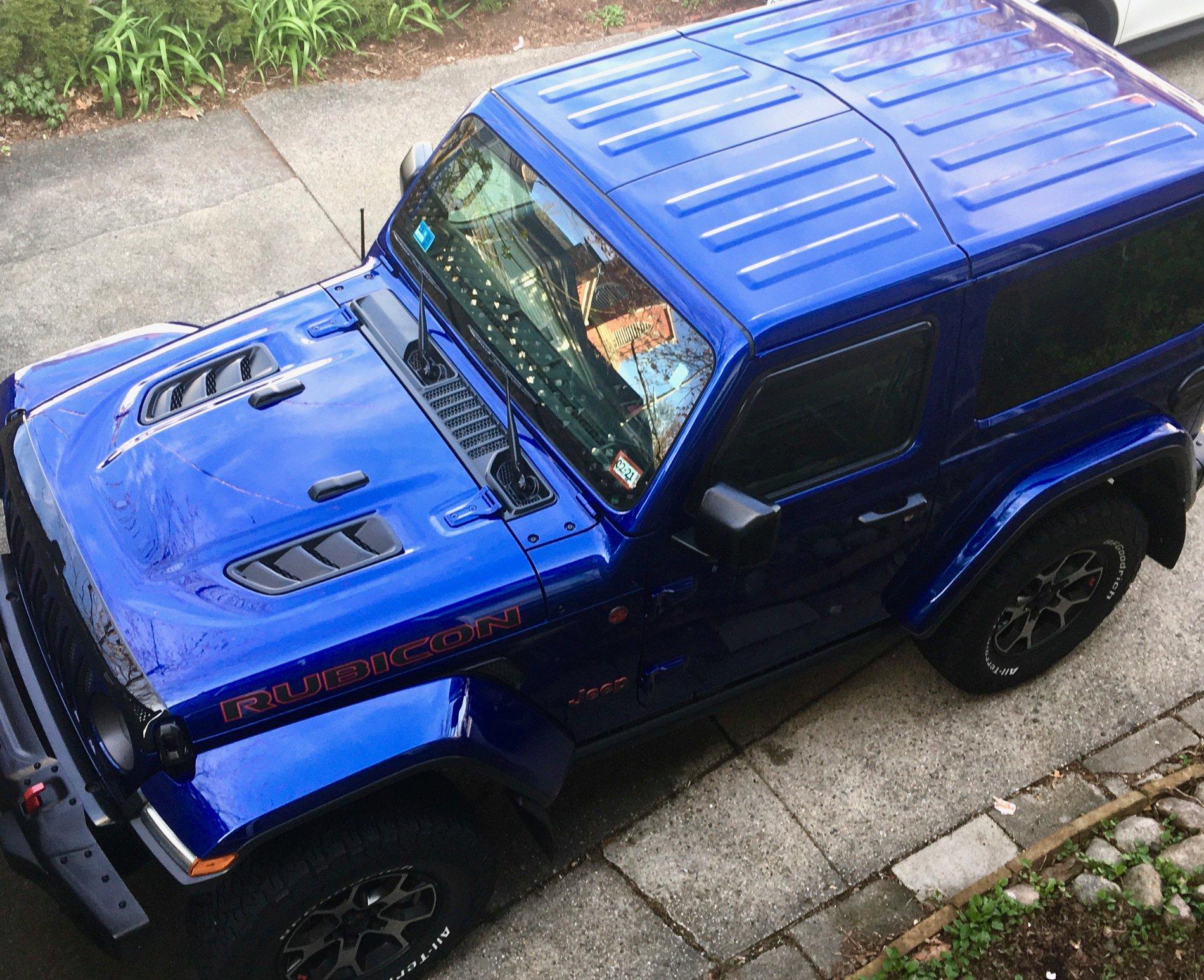

Beautiful day here in Vermont so thought to detail the new Rubi. Having a detail business when I was younger gave me the idea to see if some of the old products I used were still viable. I am a big fan of Einszett, Klasse, Pinnacle and of course Zymol. The below pics were using Klasse’s Synthetic Sealant Glaze( for newer vehicles). This is a very watery sealant which is so easy to apply and take off you’ll get through your Jeep in no time.
I often toggle between synthetics and carnauba most often applying the synthetic a few times then layering with carnauba which really makes the paint look wet. Going to order Zymol Titanium which is applied with your hands. The Titanium version is meant for SUV’s and Trucks. Love a clean ride!!!

Put Pinnacle Souveran on top of that sealant and it’ll pop. Extra work, but it’s hard to beat the deep wet look of Souveran.
Given the products you like, I bet you’ll love Blackfire products too if you’re not already familiar with them.

Souveran is on of my favorite . Haven’t tried Blackfire yet. I’ve always had a bent towards European detailing products. I also need to order the lens protector I used to have. Forgot the name but it’s aerospace grade.

Nothing wrong with wanting a clean ride.

nice jeep ! Wallingford VT here.... Where are you located ?
